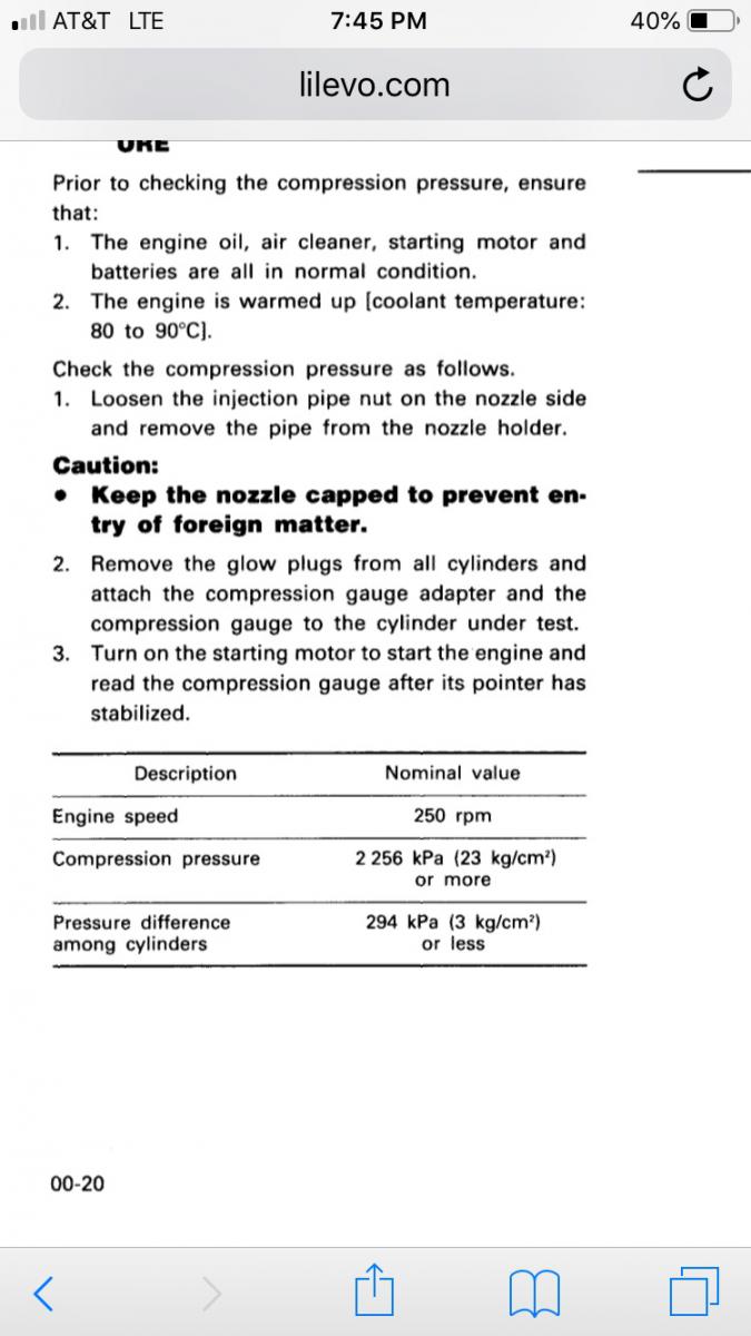

D. Ran a compression test. 1-2-4 read 350psi, 3 reads 325 psi. That is in the pocket of what I want? Not cool 3 isn’t the same, but doesn’t seem likely to be the problem?
