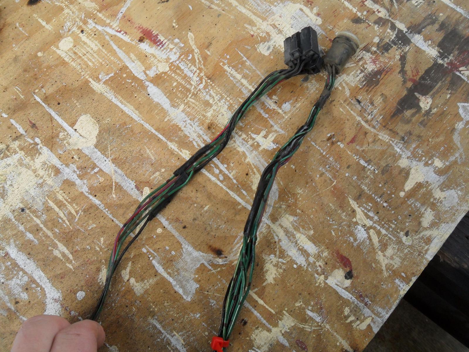

I'm still prepping the bed and after getting the bumper off ducked my head under and saw a mess on that license plate hanger and light. Turned on the lights and no light. I got both off got a new led light fixture & fasteners I'll post later that will fit the OE holes wired it to the old bullet connectors and turned on, no light. Then I notice I have no tail lights (still have the old ones in) and only one side marker out of the 4 flashes when I put on the blinker. The front & rear blinker works both sides.
So will the tail light not working stop the license plate light from working? How does one trace wrapped wires looking for a break. The old plate light had both wires fused together from what seems like a short and the bulb was fused at the base but it came out.
sounds like you need a new taillight harness for that truck - let me know if you need one.
Can you tell me where the tail light harness disconnects from the main? Or am I making that too simple? It is page 8-53 in the 1st gen manual. seems simple enough but it doesn't show where it connects to the front.
There's a weird connector under the bed just behind the cab. It looks nothing like the rest of the harness plugs. It wouldn't be that hard to replicate the rear lighting harness except for this goofy connector.

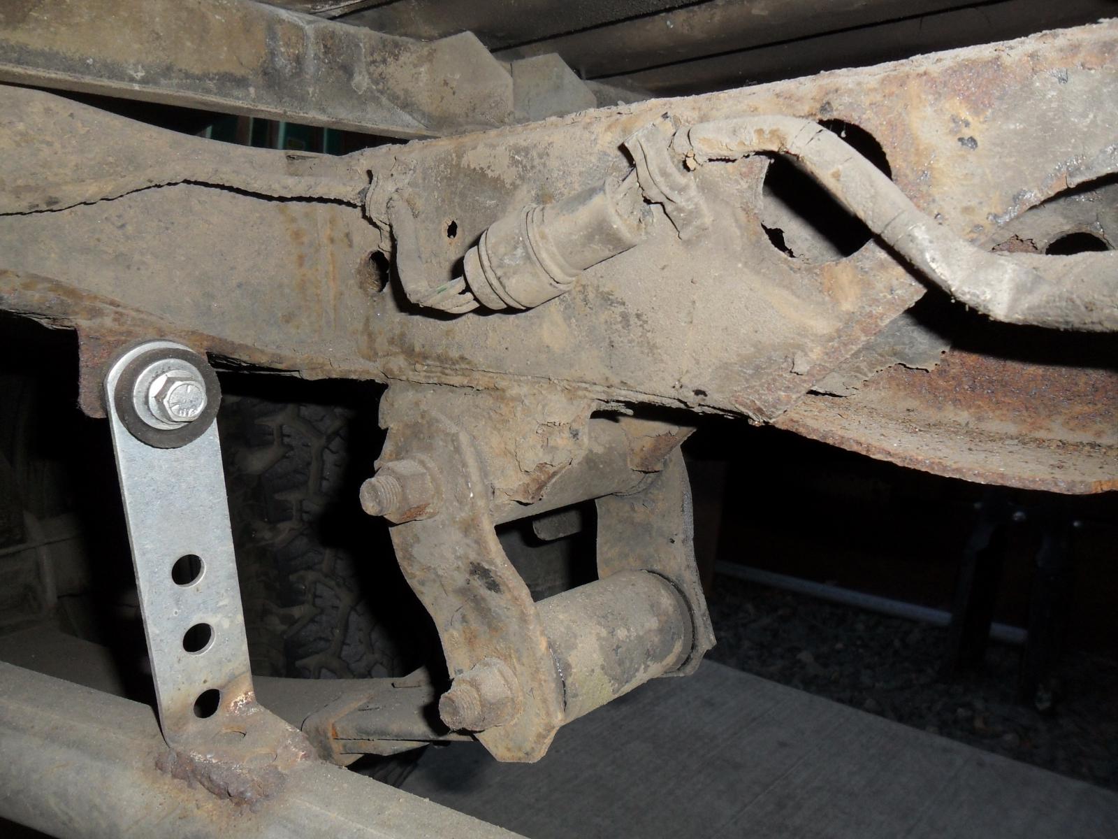

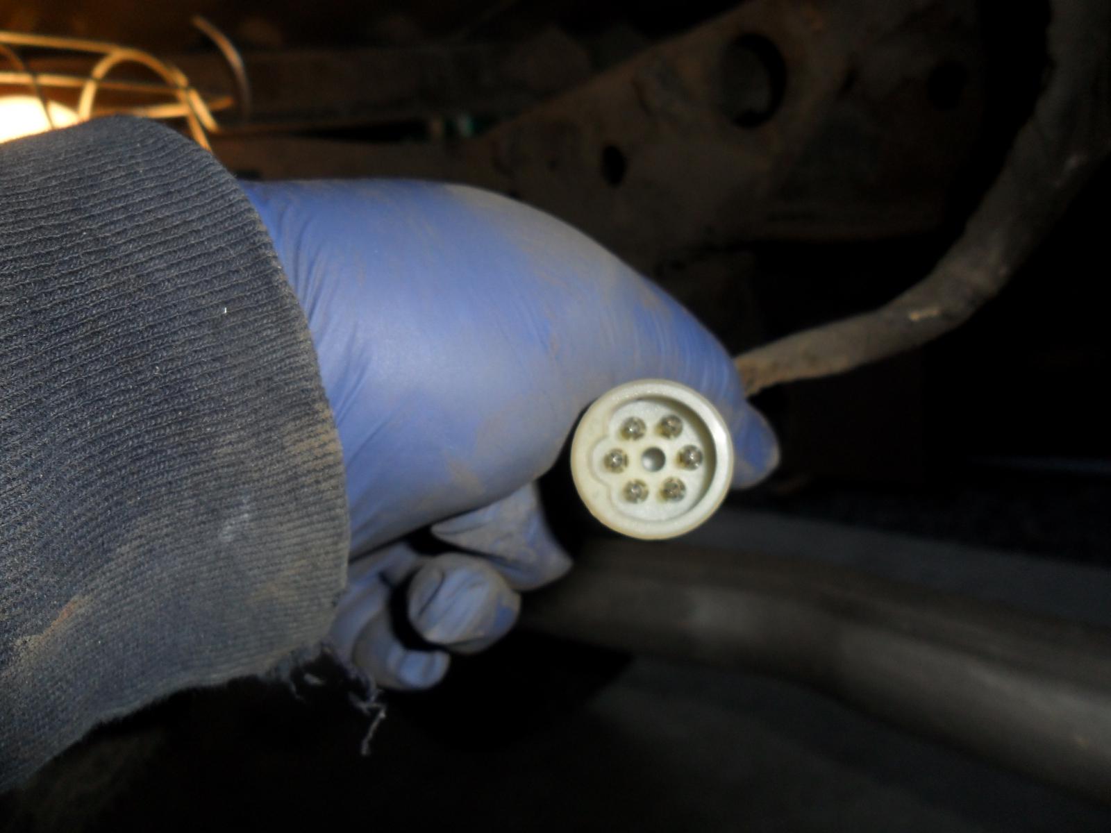

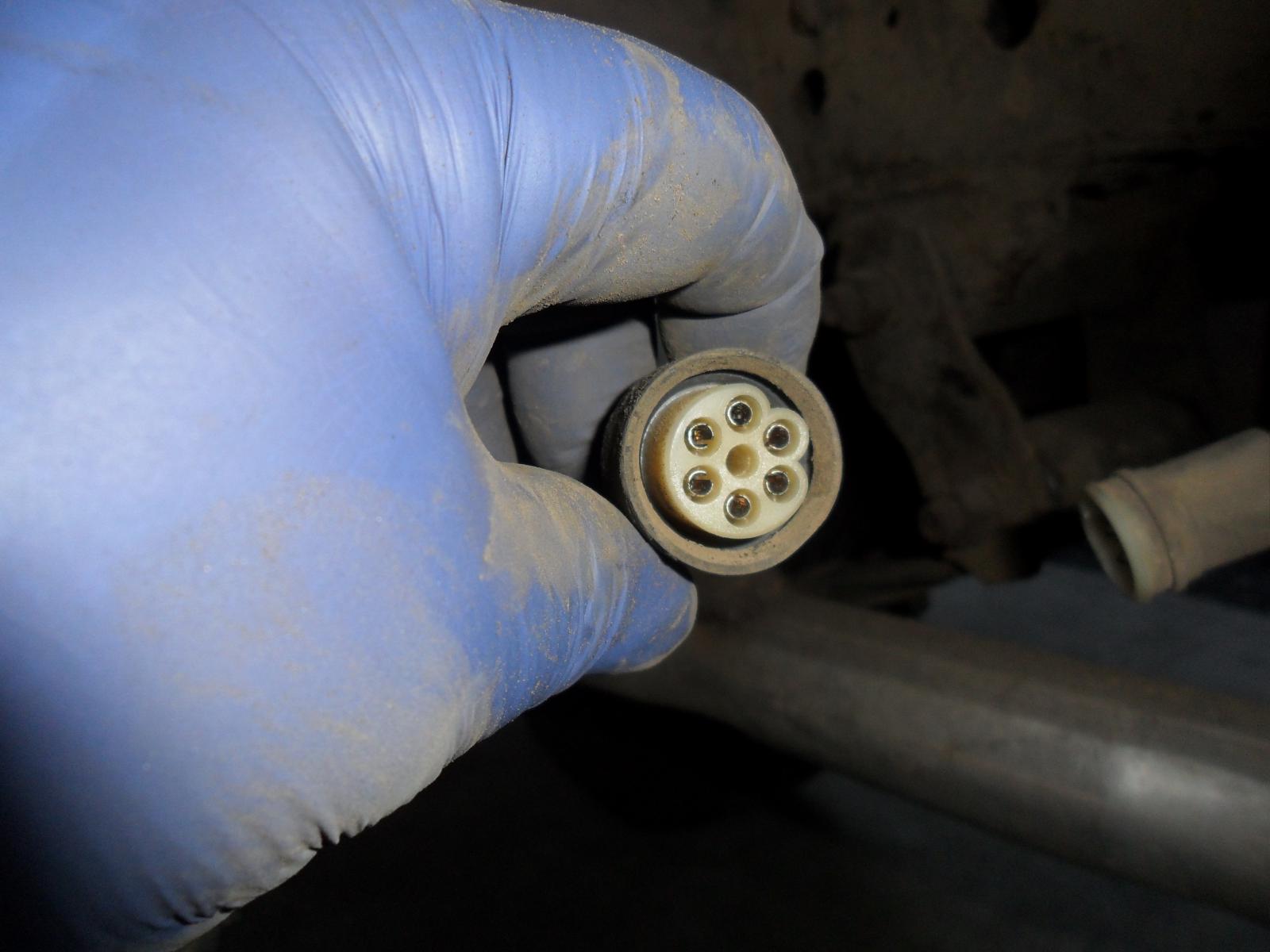

Did not find the connector up by the cab. Went back to the tail end with a trouble light and it was right there passenger side just above the shackle. See pics.
Attachment 22988 Attachment 22989 Attachment 22990
that's the one I was talking about - taillight harness.

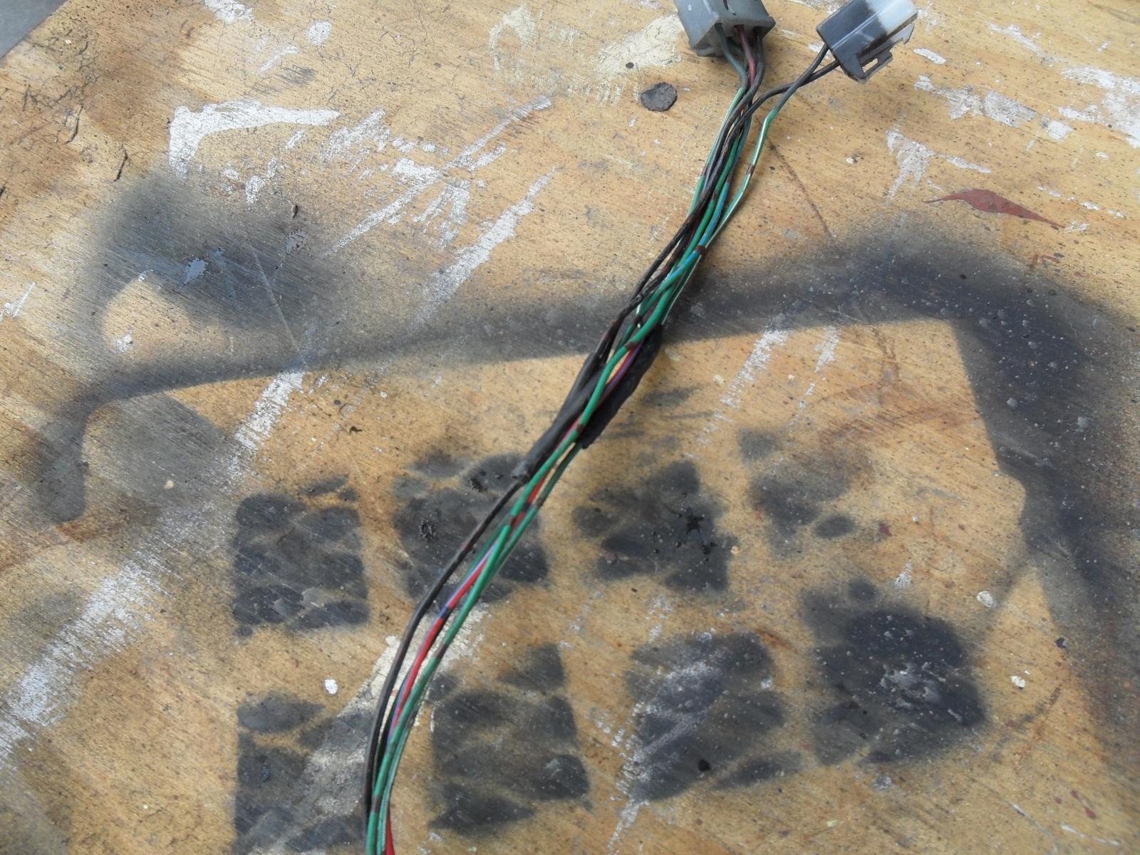

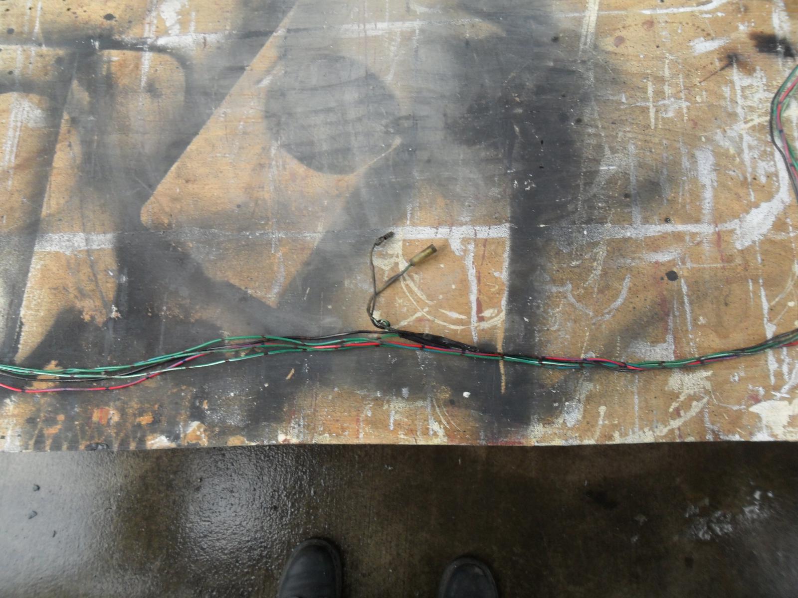

OK i caught up a bit so I stripped the tail harness. I have some pics, the splices in it look to be homemade but that might be OE design I have not cut the tape on the splices yet. I saw no obvious cracks in the wires and they feel supple with the dry hard tape off them. I will be using friction tape when I tape it back up.
1. If the splices seem good what else might be wrong?
2. How do I test at the harness attachment that is still in the truck to see if power is getting there? I suspect its fine since I had one rear side marker working when I noticed the lights had failed. But that might be a dedicated supply?? :) (Edit- Apparently I named all the pictures wrong !)
Attachment 23063 Attachment 23064 Attachment 23065
Yes, there are splices in the factory loom. No, they aren't pretty (the ones in the forward half in the engine bay are borderline ghetto but Mitsubishi wasn't chasing Scout badges when they made these trucks :rolleyes:) If you have a multimeter, check continuity from end to end then check power out. A cheap pocket multimeter is good a gadget to have on hand. If you don't have one - now's the time to get one. They are easy to use. Check the ground leads as well to ensure they have solid connections to the body and chassis. Check that the tail light bulb sockets are looking ok etc. Make sure the sockets have good connections from the rear section of the harness to the main harness (they might be corroded or just dirty)

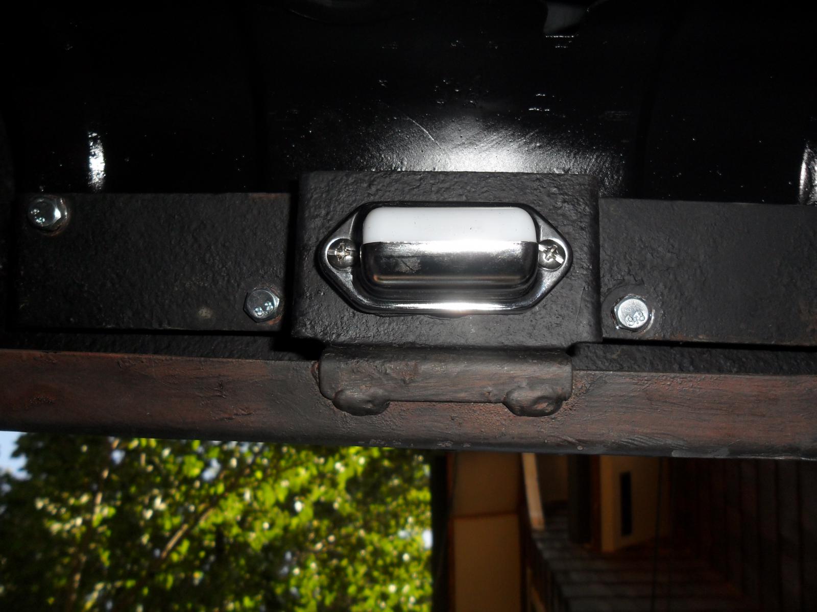

Here's the promised pic and info on the rear plate light.It is supposed to be for a blazer. AZ has it in the isles stock. You'll have to get new machine screws for it if yours are as rusty as mine were.
Attachment 23070 Attachment 23071 EDIT Attachment 23078 I meant to add this in case anyone wants to know.

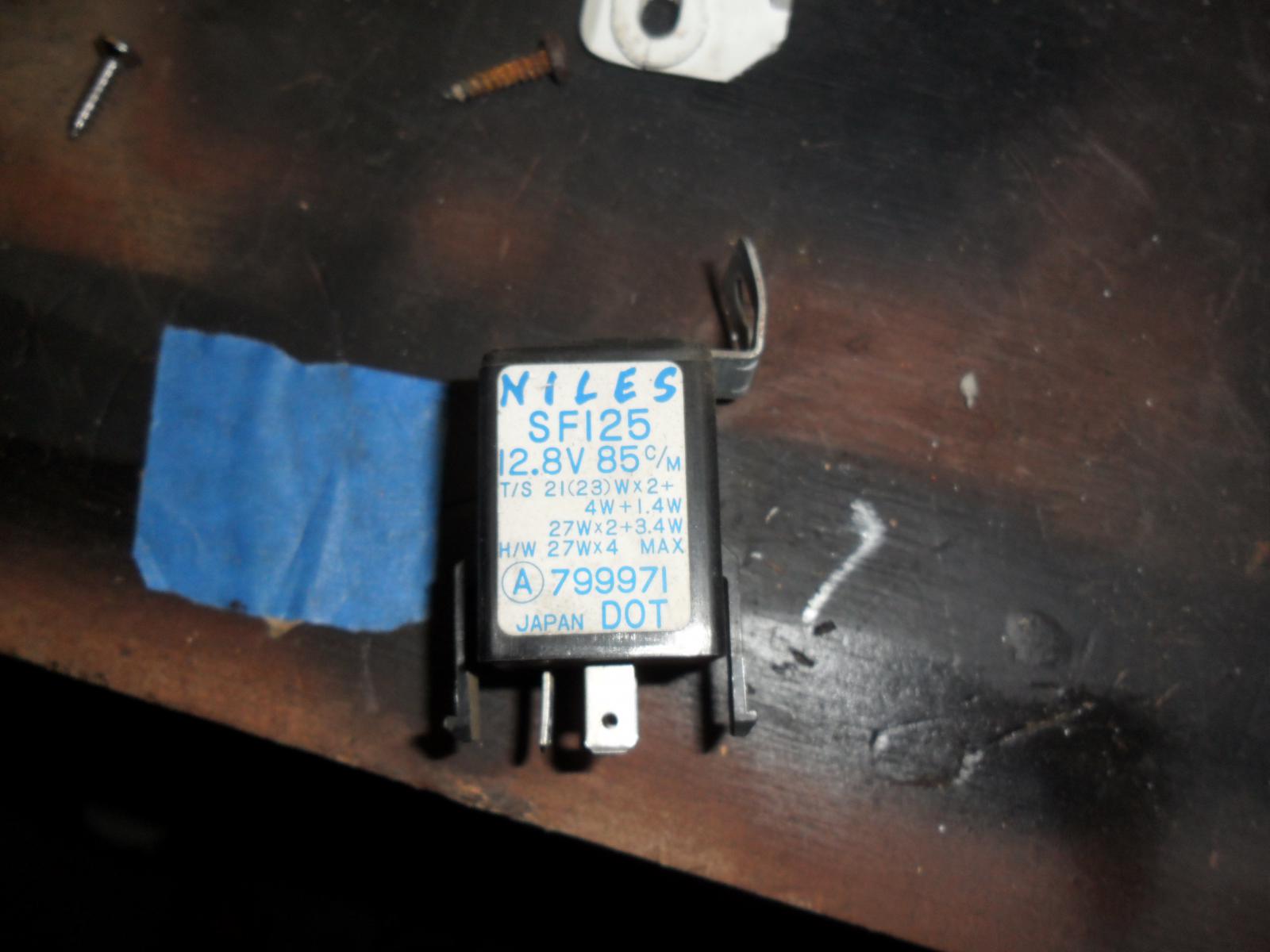

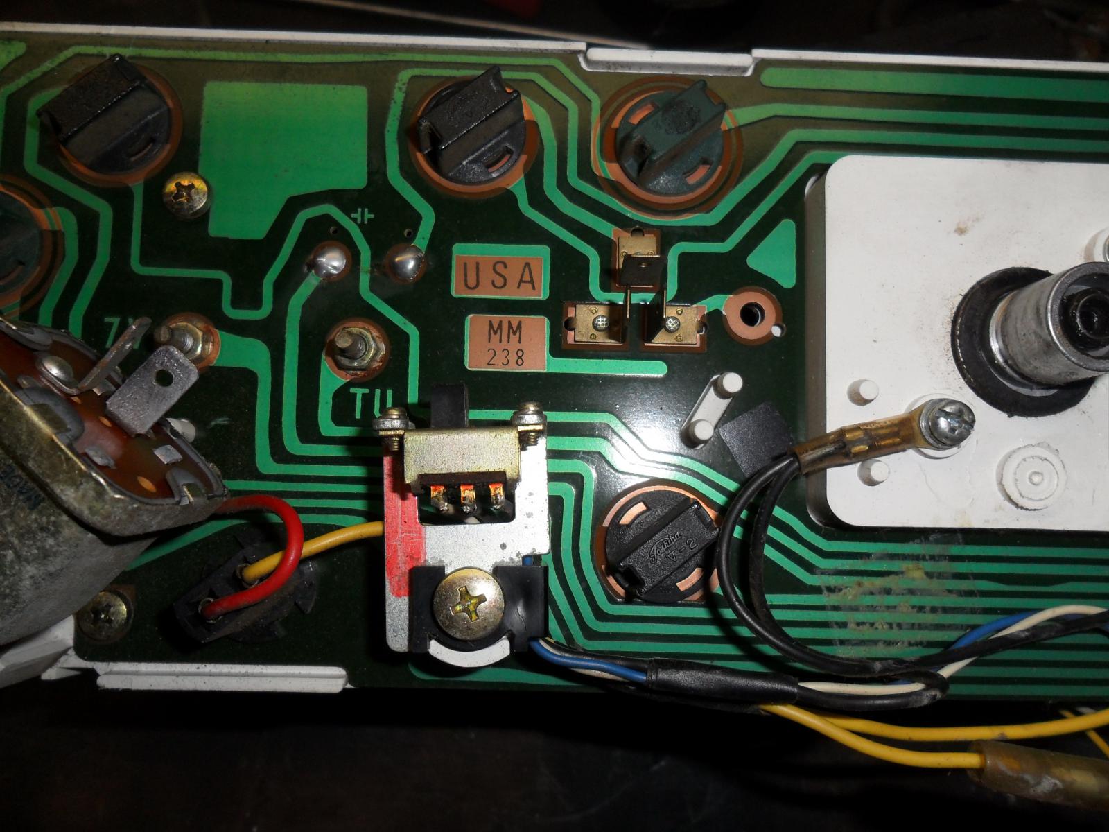

I'm down today so I decided to try to figure out the turn signals. I took out the instrument panel. Two questions then some whinging and another question. 1. What is the switch on the back of the instrument panel for? see pic. 2. This relay is what is buzzing (The flashers are now working IDK why) What is it and how do I test it. OK that's two in one.

Well I went and got this relay https://www.autozone.com/electrical-...9_642469_11714 it worked at making the turn signals signal. I put the instrument panel back in and now I have no lights on it. :( I have not driven yet. I will eat then go drive it.
Any ideas what may cause the dash lights to fail? Also what is that switch?
EDIT- I feel stupid. After I ate I realized I had forgotten to plug the round black plug into the back of the instrument panel. Everything worked normally. I think that hot wire the Dodge dealer mechanic hooked up to my starter was the cause of the intermittent instrument failure. Time will tell. Drove up the interstate and back about 24-25 miles, gas gauge did not move that I noticed and that is something. It felt good like I could rely on it. I haven't got the guts to take another long distance trip yet. Last time I was 45 miles away I blew the head gasket. Temp never went above half and it took a lot longer than usual to get there.

2 WHAT IS THAT SWITCH IN THE BACK OF THE INSTRUMENT PANEL?
I know there's a engine service interval switch on Gen 2's, but IDK what that one is for :shrug: I also noticed the circuit board is designated for the US market which might explain why I haven't seen one in person either. There's only 4 screws holding the column cover on - 2 right up at the back under the dash and 2 in the central section of the column cover. The column case halves clip together and if you don't have tilt adjust steering, getting the upper half off is a PITA. If and when you get it apart, be careful not to accidentally cut the threaded holes up by cross threading the screws back in (easier said than done) There isn't a lot of plastic holding the screws in place. Not 100% sure on the relay (could be the hazard light relay or the turn signal) I'll have to jam my head up under the dash on my truck or look at the spare harness to get my Scooby Doo on.
It finally occurred to me to start it up and flip the switch. It turns on the check EGR light.
That circuit board is from another truck. It was the first thing I did to it. I forget the exact reason but once I saw it could be done I did it so that I did not have to give up the original Odometer. It only had 80K+ when I bought it 16 years ago.

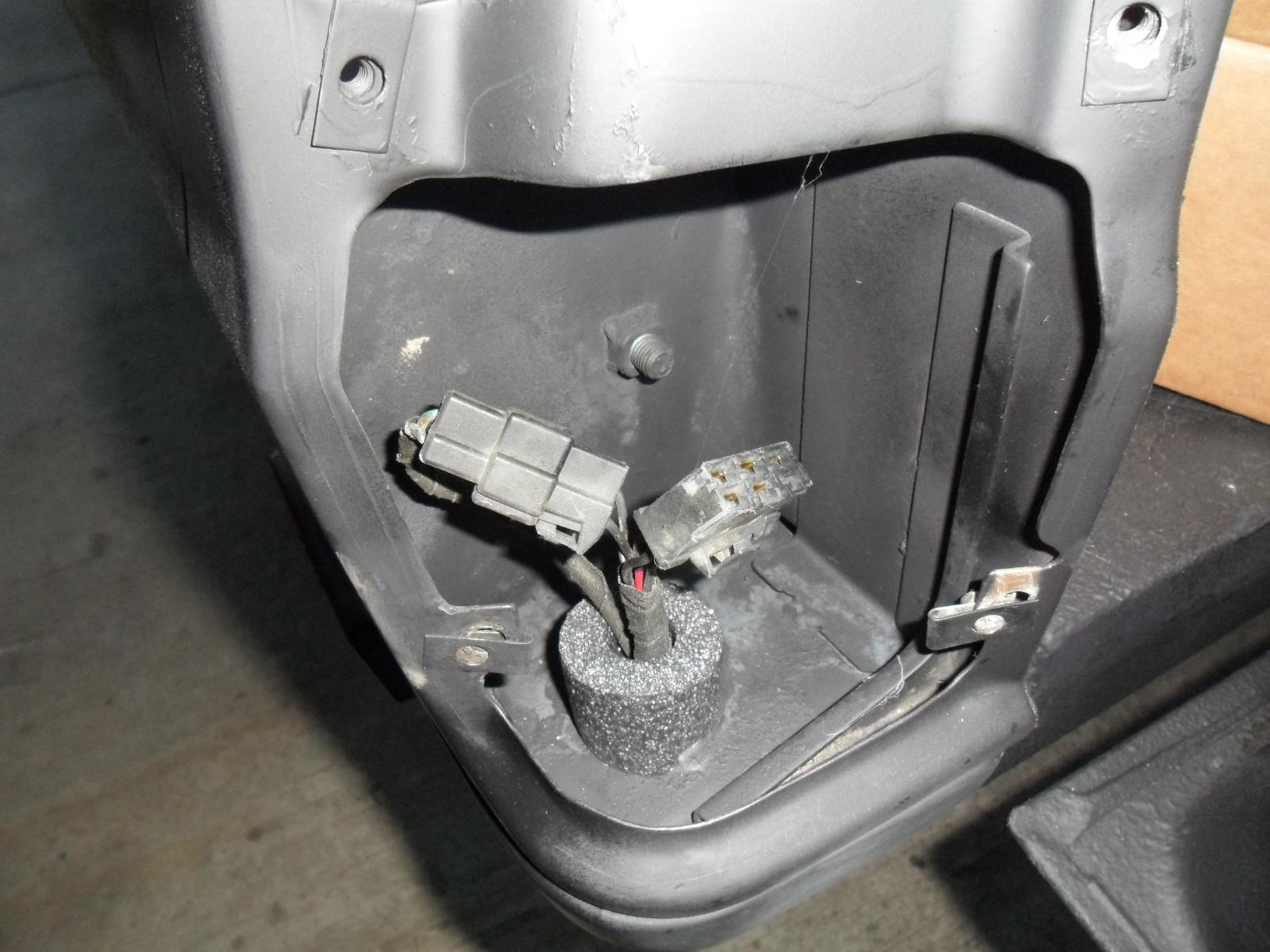

1 Attachment(s)
OK I have the skirts back on and I made my own grommet for the hole in the tail light housing. 1/2 inch pipe expanded foam covering about 2 inches long with a slit around the circumference about 1/4 deep a half inch up from the bottom.
Attachment 23163
