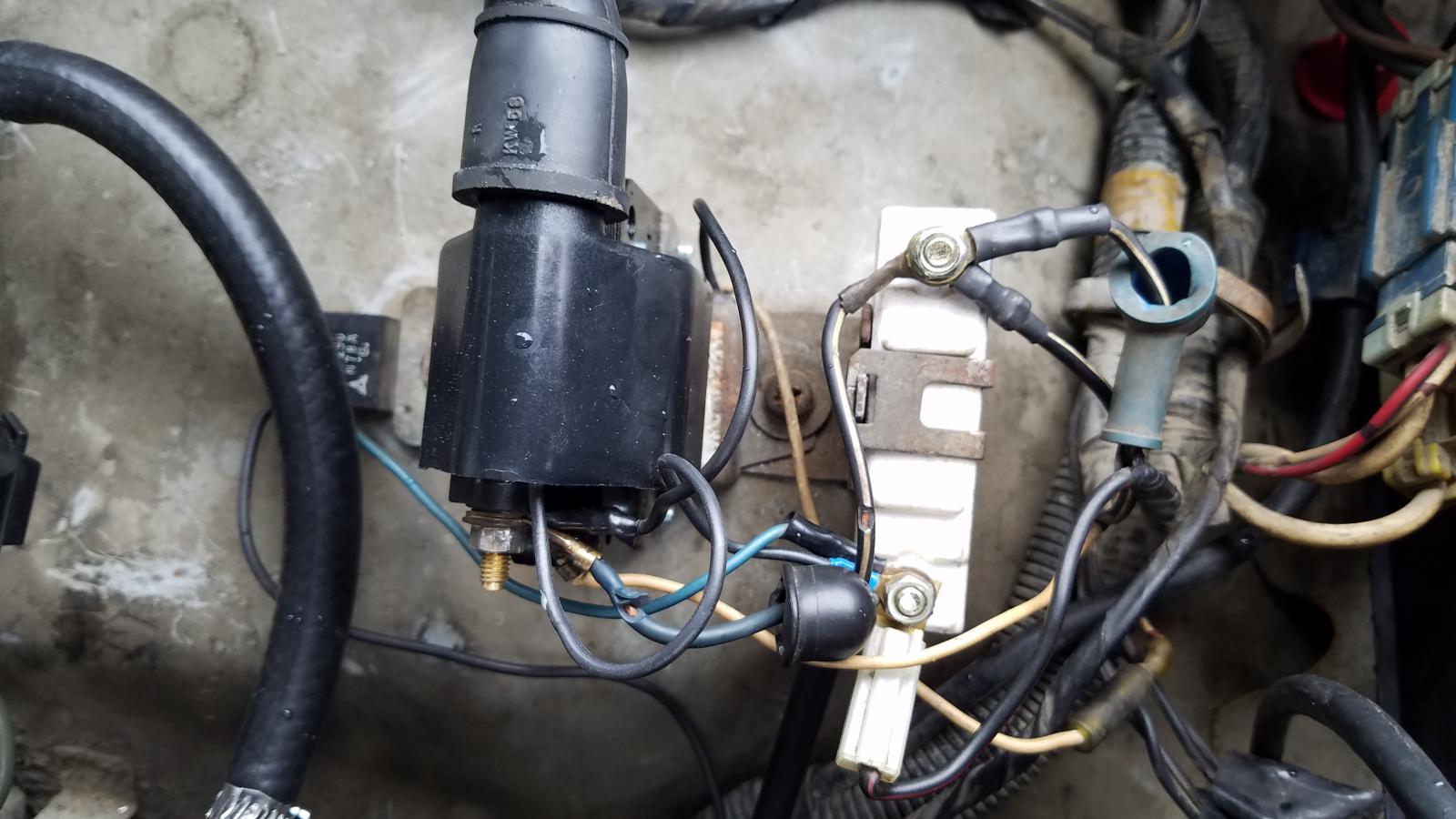

Can't seem to make sense of a couple wires.
You have a couple of wires where the insulation has been broken through which is never good. Does the ballast resistor get hot (I mean HOT)? Normally indicates a fault.
Not a good idea to remove the ballast resistor. It will load the crap out of the oil filled coil. BUT if you take the ballast resistor out and use a transformer type electronic ignition coil it'll boost the secondary voltage out of the coil (big fat sparks at the plugs = better fuel burn, improved performance) It will take it's toll on spark plugs and the life of the coil but there's no free rides with any modification.
