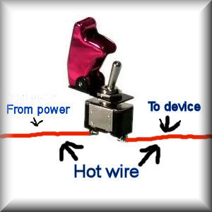

Bridging a toggle switch into the power for the relay is easy enough, but recently I have been looking at emergency fuel cut-off switches as an alternative. They disable the power when a car/truck experiences a hit or a roll over. I'm not sure if they can be manually tripped to act the same way as it would if involved in a collision and disable the fuel relay.
it really is simply one hot wire cut into add in toggle switch and your done one flip of the switch will kill the power the other way will allow power. you can add a toggle switch into any wire all a toggle switch does is turn off and back on just like a light switch in a house.
