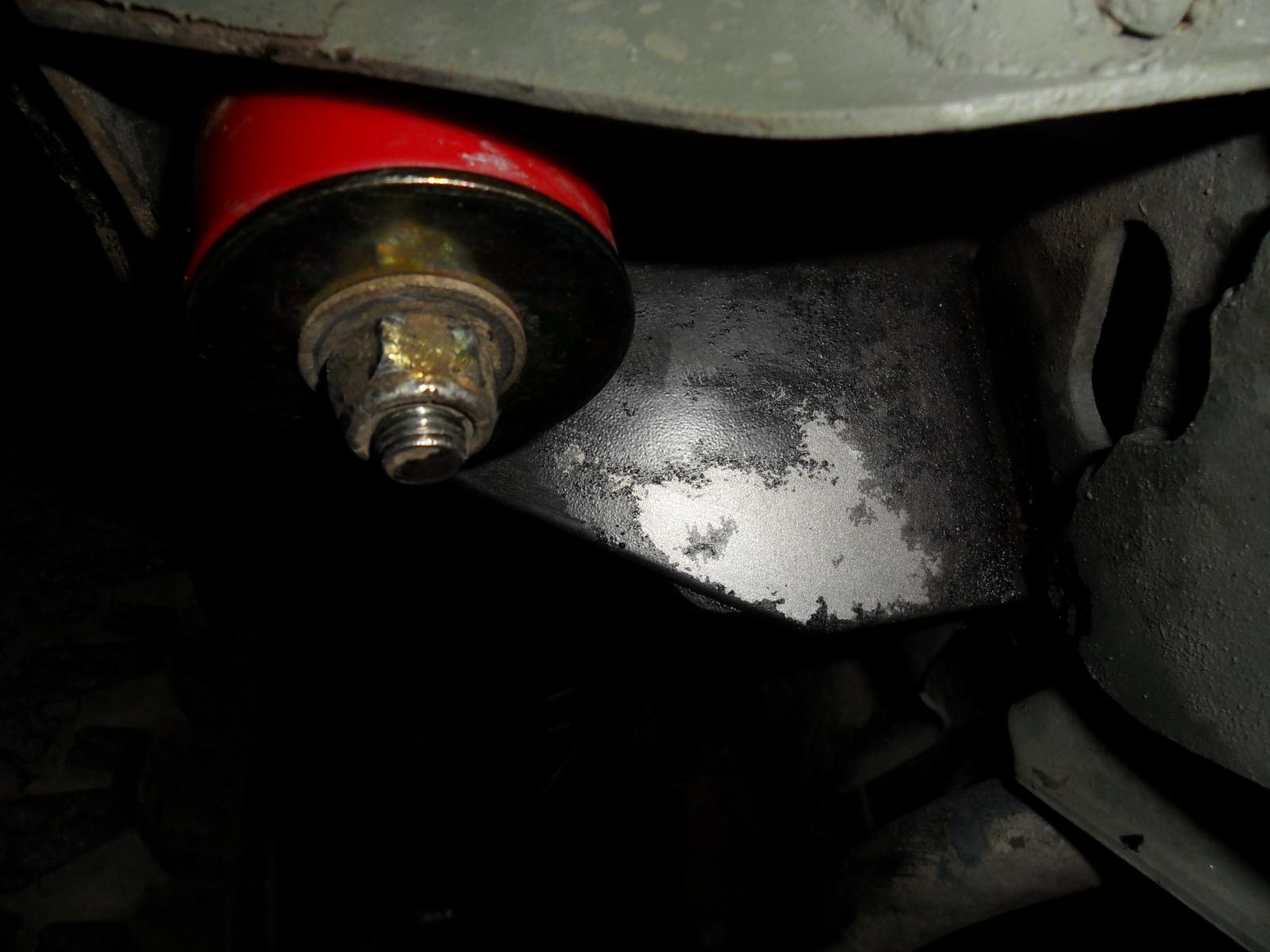

What might this be?

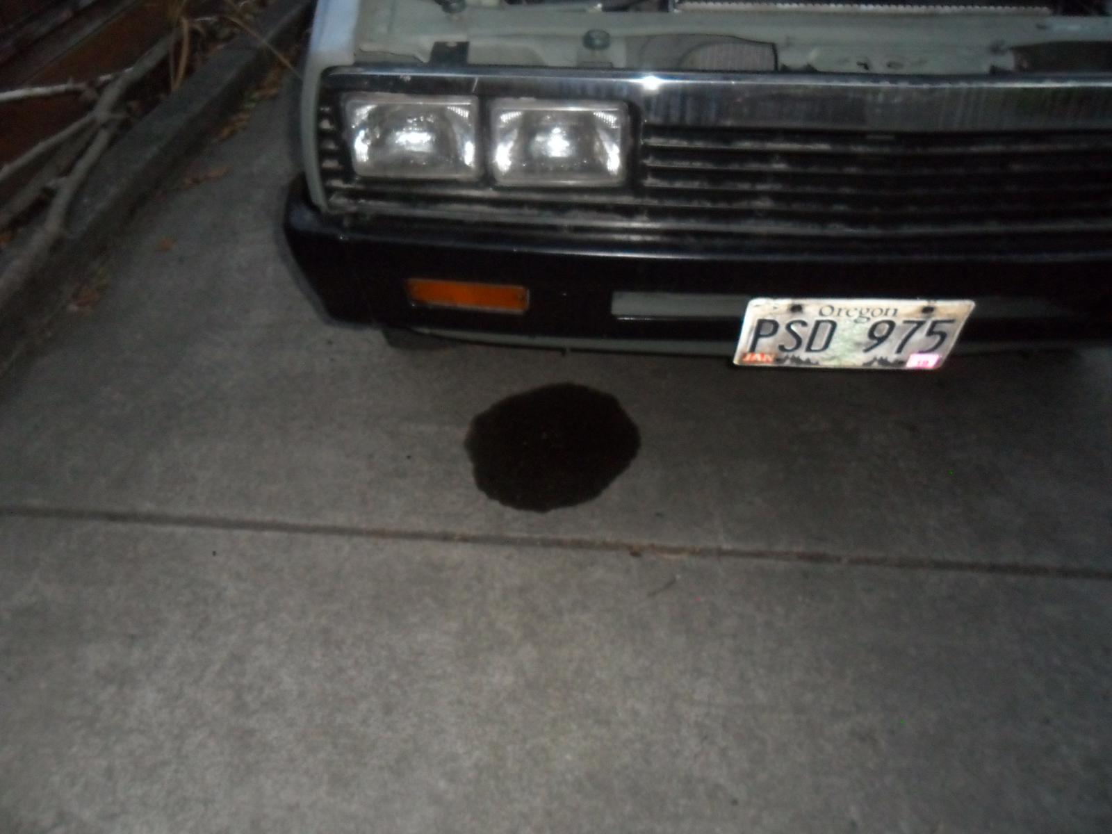

I saw a wet spot under the truck previously but did not find anything leaking with a cursory look. I moved it here the other day and the spot I moved it from had a smaller wet spot under the same place. Today I crawled under it and felt for wetness The shiny spot was dirty wet gunk. I did not notice wetness when I did the body mount but I did not touch the spot that is now shiny either. Everything above it is dry, the rad, the window washer and the rad overflow. I'm tending toward a theory that I spilled coolant when I was doing those flushes and its somehow staying wet and slowly dripping even though we have had 95+ heat here for a couple weeks.
Intermittent rad leak without pressure? Any ideas for tracing this?
Attachment 19488 Attachment 19489
I know this isn't classy but - smell it. If it's coolant it will smell sweet. If it smells like detergent it might be the washer bottle (don't use detergent additives in your washer bottle people, it will eat the rubber seal...) Chances are you did spill a little coolant and the run off finally trickled out of the fins and off the bottom tank. Roll the truck back and see if it creates a new pool on the driveway overnight/during the day.
if you overfilled the coolant reservoir bottle (after flushing) it will overflow...as the truck cools down antifreeze flows from radiator to reservoir...see if the reservoir is "within range" (it should be now)...if it is within range I bet it won't leak again.
I thought both things. Everything is dry and the hose for the overflow drops down about even with the motor mount and the level is right. I'd tend to think the same thing Ragragtimetime but like I said the overflow hose drips well behind and below this spot. I did smell it and it didn't have much of a smell not oil not sweet. I only use windshield cleaner usually all weather stuff so I don't have to deal with it freezing or changing it out in winter.
I mentioned I saw a spot like this before and found nothing leaking. Once I moved the truck there was no new spot (until now) so I left it alone.
This morning the spot seems to be drying up and the shiny spot is dry. If I didn't say so with the exception of starting it and rolling it a few feet one way or the other its been parked for more than a week.

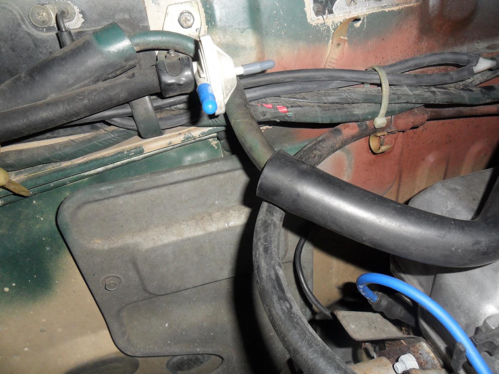

Oh yea I paid more attention to what the carbon filter said on it.(I had my glasses) and the one that goes to a plastic diaphragm was to the AC so this must have had AC originally. I vacuum capped both outlets. One went to the carb and was hanging on the firewall so I stuffed it into that hose from the secondary air filter that has something to do with the emissions that was also removed from this thing. The last one goes to the gas tank connecting to a hard line just below the canister.
Here is a picture of the two hoses. The white plastic is the end of the hose that says 'to AC" the other one looping over it and into that larger hose is the one that says "to carb". That hose its stuck in goes to the outside of the air cleaner.

The tube from the OE air cleaner box that has the extra filter in it is supposed to be connected to something that sucks exhaust gasses or crank case gas or ??? anyway since it was just hanging out there in midair it was sucking a lot of extra air into the air box which was screwing with the air fuel mixture. My sticking that hose in there has restricted it enough that the motor is getting the right amount of air via air intake. IDK whether or not it sucking air from the carbon filter which smells heavily of gas is helping hurting or neutral.
If it's pulling gas vapours into the intake then, in theory, it should neutralise the lean out effect from pulling air only. Plus it should also have a degree of restriction from the carbon filter can as well. Hey, if it works and it's running better then it's a win.
