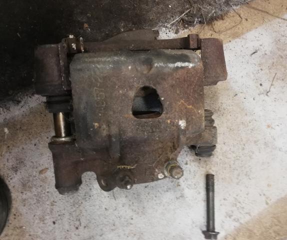

Take these ones off
http://www.mightyram50.net/vbulletin...id=25955&stc=1
and you can remove the caliper and carrier together.
im not sure where you are having the clearance issue. post a pic of your setup.

1 Attachment(s)
It is not letting me post a picture but in his picture above the bolt I am having trouble with is under that silver dust cap on the caliper itself when you remove that dust cap there is a bolt that actually sets back in the caliper and I can not get a socket into it to remove the bolt I cant find a socket that will actually fit inAttachment 25983
1 Attachment(s)
Nah boss, don't need to touch that on floating calipers. Take the other exposed bolt out and slide the caliper off (should be enough space to rotate the caliper off the disc, otherwise remove the caliper and bracket like I have in that pic)Attachment 25984

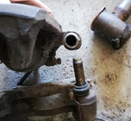

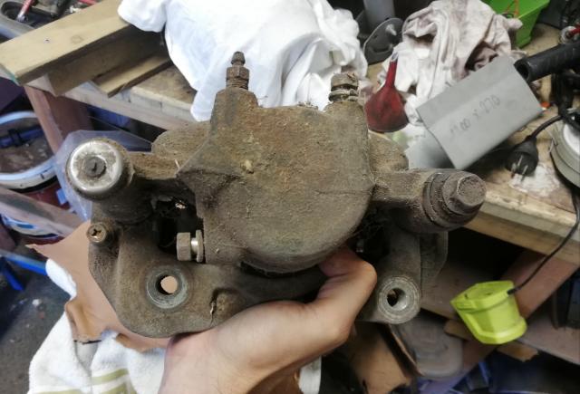

No the upper (small bolt) is holding the sleeve that the caliper slides on (the bushing is inside the caliper body), so you lubricate it still attached (i.e the piece the small bolt is holding doesnt move, it is the fixed part)
The lower sleeve will push out of the caliper body and you lube between the removed sleeve and the body of the caliper

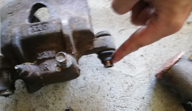

See pic here. You can see the small bolt is holding the post, the caliper slides up and down this post.
The lower bolt that you have already removed holds a sleeve
Attachment 25986
Shown on this pic.
Push the sleeve out of the caliper body and lube the outside of the sleeve
