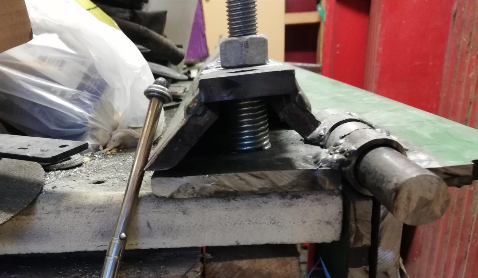

Ground the clamping edge down to give a nice crisp bend rather than a roll over the curved edge. May need to knock it down another mm but will see how it goes.
Then cut some clearance for the hinges, and added some flat so I could run some bolts through the whole lot to clamp down.
Have slotted the holes so I can adjust the top clamping part to the thickness of the best being bent. I will pull the springs out of the grinder jig and use them in here too.
Bolts will go in the other way around- through my work bench so I can tighten down the nuts to clamp

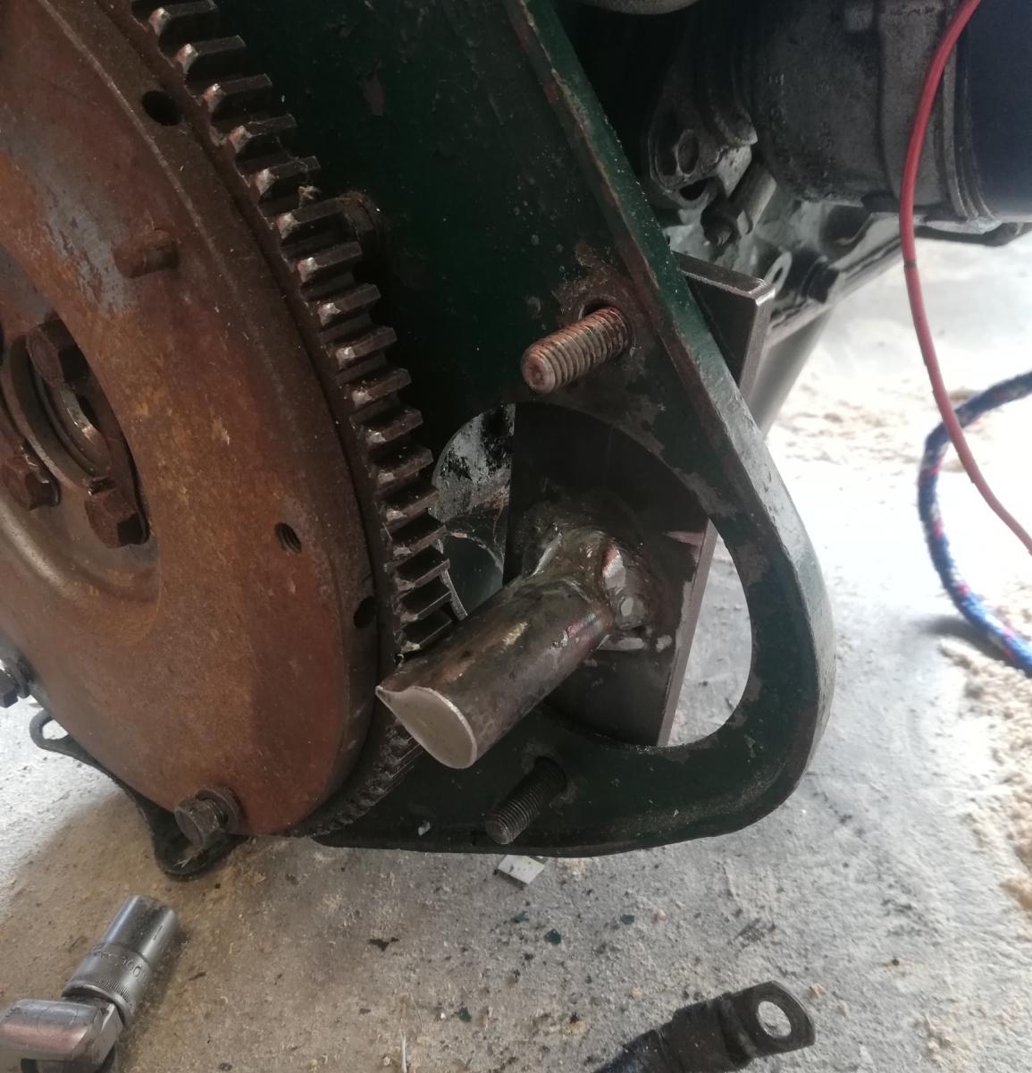

Needed to unload a Morris engine and store it, I have a spare engine stand so I thought that would be good for keeping it mobile and out of the way.
Only problem is, I need to remove the flywheel.
Can get away with a couple of big screwdrivers to stop the flywheel turning when removing it or the crank bolt. But I'm likely to want to use a stop again. Can buy them, they are the same for minis and all other A series engines, but I wanted it today and I have a shed of tools and steel stock.
A series flywheel lock tool. Will fit minis as well. Works with or without gearbox attached.
Attachment 22550

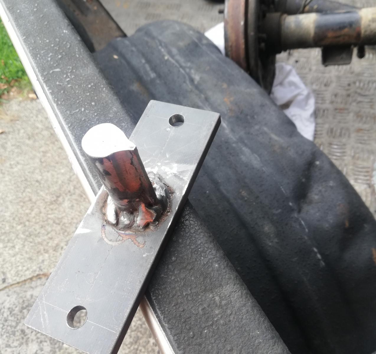

8mm plate cut to 6"
Holes drilled about 5" apart to fit the starter bolts and holes
I cut a piece of 20mm rod 2.25" long and then cut a quarter out of it lengthways in my bandsaw.
I then cut a strip of 5mm plate to make the tooth. This is quite close to the tooth profile, so just a few minutes shaping it with a sander.
Then welded the strip to the rod, and the rod to the plate
Attachment 22551
Works well. I will letter punch what it is and tuck it away with my other home made Morris service tools

To remove crank bolts on a minor at least you can simply attach a long breaker bar and wedge it against the ground and hit the starter for a second. Will loosen right off
If I don't have a brain fade I use the starter and breaker bar combo to crack crank pulley bolts. Works every time. The only decent bench tool I have is a drill press. Don't get a lot of mileage out of it but it has been probably the best investment I made way back (it is a cheap @ss drill press and the chuck runs eccentrically, but it has done it's job when I've needed it)
