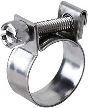

If you go with splicing pipe into the middle of the stock hose, take care to use FI-style hose clamps, not the typical worm-drive clamps, which don't clamp evenly around their circumference and thus can leak under high pressure. FI clamps are smooth bands with an overlapping section at the open end, and "ears" where a screw passes thru one ear to a captive nut in the other ear to tighten the clamp, like so:

good tip on the clamp. Oem nissan type shown here, they last forever
https://d3t0tbmlie281e.cloudfront.ne...NIaib2i.medium
may need bigger diameter for that thicker mitsu hose. Grab em(same type) from oem external tranny cooler lines at junkyard
lloootttsssaaa folk run worm type tho. Supplied with most new fuel pumps
