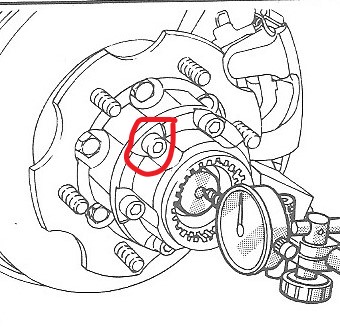

Hopefully you're only missing the cap. If so, you should see six allen wrench bolts that affix the lock hub to the wheel hub (circled in red in the illustration below). Also, the drive shaft end is recessed about 3/4" within the lock hub housing.
Attachment 21569

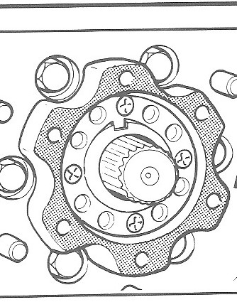

If there's no lock hub, the drive shaft will protrude outside the wheel hub and you'll see a ring with 12 holes, four with phillips head screws, surrounding the drive shaft.
Attachment 21568
