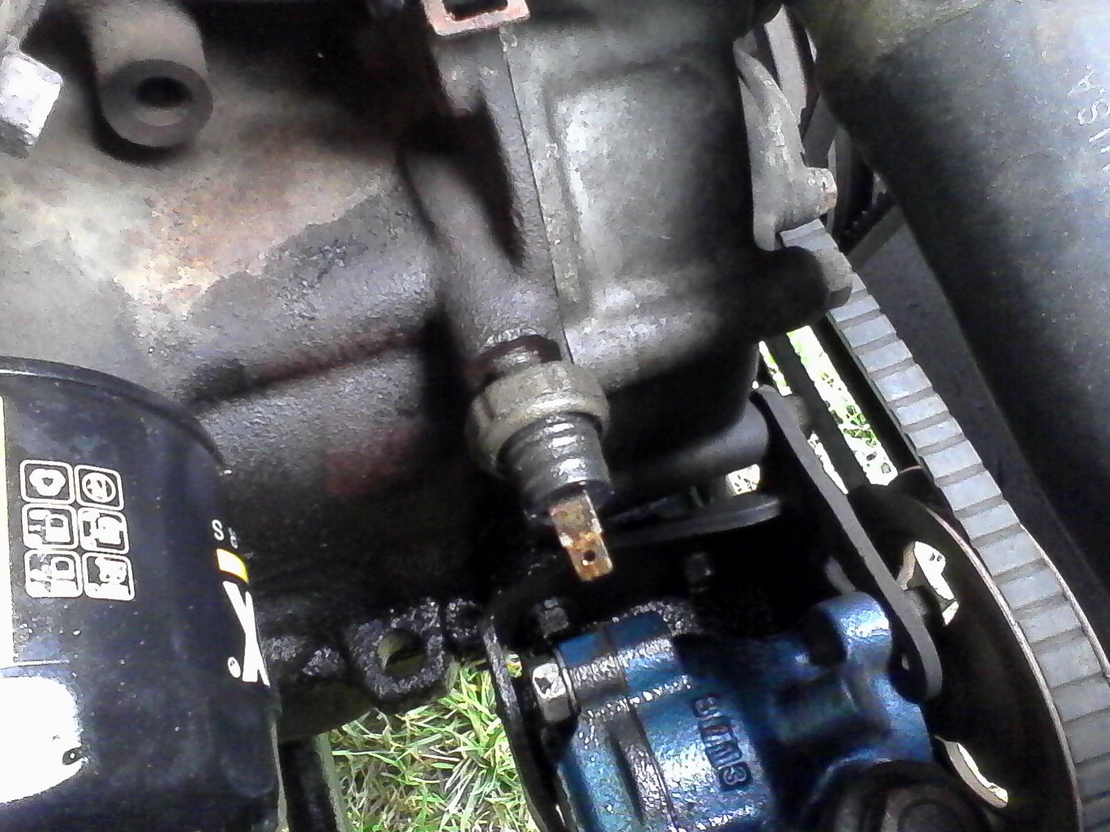

What is this part called that is leaking oil?
Attachment 20456
Oddly enough the threads aren't leaking, the black plastic is leaking.
Attachment 20456
It's a oil pressure switch (turns on the idiot light in the dash when your oil level is so low the engine doesn't generate oil pressure - which is too late to find out) They crack from impact damage or just fatigue. There should also be a mystery wire floating around there with a female spade terminal on it.

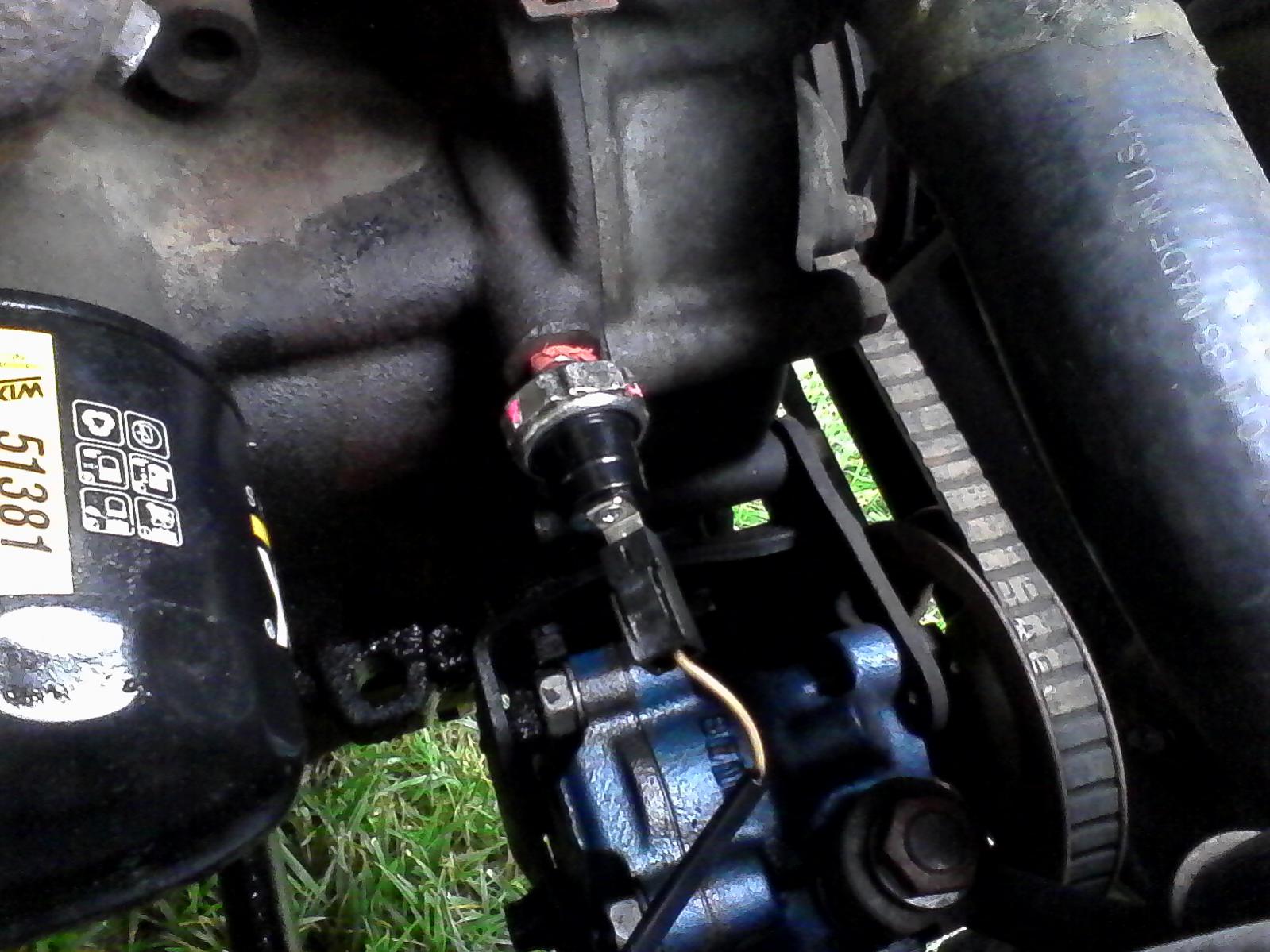

Just replaced it, showed the above picture to the autozone employee and he immediately knew what it was. Exactly as you described, and so far no more oil leaking. Also, you are right on the female connection, I removed it but it's reconnected now on the new one. Funny thing is I was going to remove the old plastic and replace it with epoxy. I felt like this was an old part that I wasn't ever going to find anywhere. The good thing is this part is used on other engines, which is why this part is still available, is what the autozone employee told me.
Picture of the new oil pressure sensor installed:
Attachment 20457

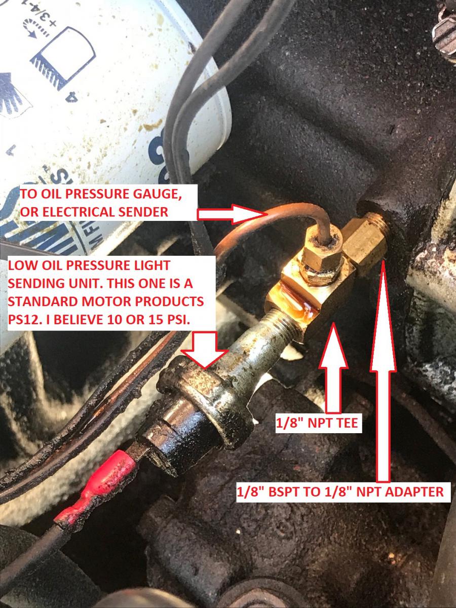

You can put a tee fitting in there and keep the light, and have a gauge. That's what I did. The threads in the block are 1/8-28 british pipe thread. I got an adapter to 1/8-27 pipe thread so that I could use easily sourced plumbing pieces. I got an oil sender for 15 psi with american threads (I think for an older GM or Ford) and a sun-pro gauge. I didn't put that in until after i removed the balance shafts, but cruising at 3k rpm I usually see 85-90psi. Never below 25 at idle.
Can you share a picture of your setup, sounds interesting.
I'll snap a picture tomorrow
Awesome, I'll check it out when you upload a picture.
Attachment 20507Don't mind the oily mess. I have a very slow leak from the fitting that goes to the oil pressure gauge. I drive 500 miles a week, so the oil and dirt build up quick.
That's gorgeous. Nice job, I like creative things like this.
An oil pressure gauge is a good idea but mechanical gauges are an invitation to trouble. Imagine if it blew under the dash - it would make a hell of a mess but at least you'd know something was wrong before your engine ate itself. The fittings in the engine bay are constantly being exposed to vibration which is probably the reason why Giovannis' is weeping. Chucking the oil pressure switch for a sender and using an electrical gauge eliminates a bunch of inherent problems - just an opinion :)
Mine has actually weeped from the day I installed it. The compression fitting was poorly machined. I have a vibration isolating coil not seen in the photo, and then the line is secured to the body. But yes, there is a risk of line failure. If you isolate the line from vibration, or use a flexible connection such as some braided hose, it should last the life of the vehicle. If you don't isolate the vibration it's only a matter of time. Just like brake and fuel lines. I prefer mechanical gauges because they are cheap and reliable. I've never actually seen a failed mechanical gauge. I have had problems with electrical gauges, but those connections are prone to corrosion from the insane amounts of road salt they dump in the winter here in New England.
