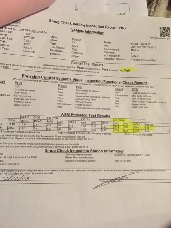

Just got foxy (82 power ram 50) smoged today and she passed everything but nox! I need help!
Attachment 20069
Here are the results
A number of possible causes - a vacuum leak somewhere, the A/F mixture isn't adjusted properly or the EGR system isn't operating properly. There is also a possibility that the plugs are the wrong temp rating, a tuning issue has ramped combustion temperatures or the combustion chambers are carboned up. If your engines cooling system is struggling this will also affect combustion temperatures (all of which increases NOx emissions).

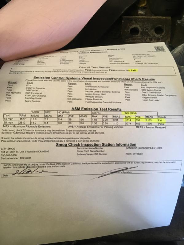

Got it smoged again, failed nox at 15mph
Depending on the O2 sensor you'll need one that will work with it (narrow band or wide band). Ebay is a good place to start. It's a good diagnostic tool for air/fuel mixture and can also help you maintain fuel economy while driving (not any good to monitor NOx though).
Damn. What were your NOx readings this time around?

It's dropped a fair bit but still need to get another 600+ ppm down from the NOx reading. What are your plugs like? Have you changed fuel (gone up to a higher octane fuel like 98+)? You can try decarbing the engine by taking the air filter lid off it and spraying water with a trigger pump down the throat of the carb while running it with the throttle open. This won't kill it and you should be able to hear some exhaust 'crackle' when the carbon build up is burning off.
