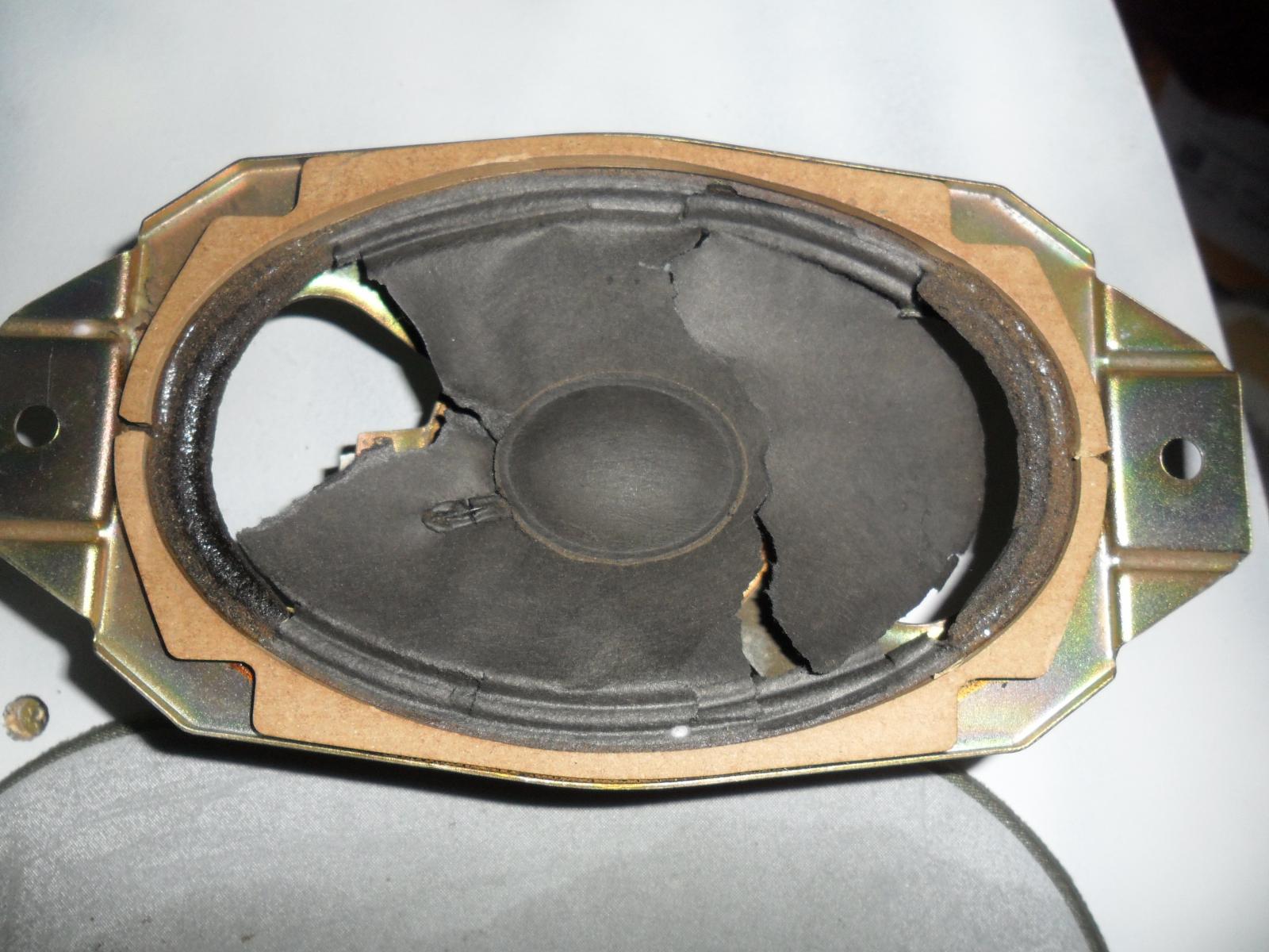

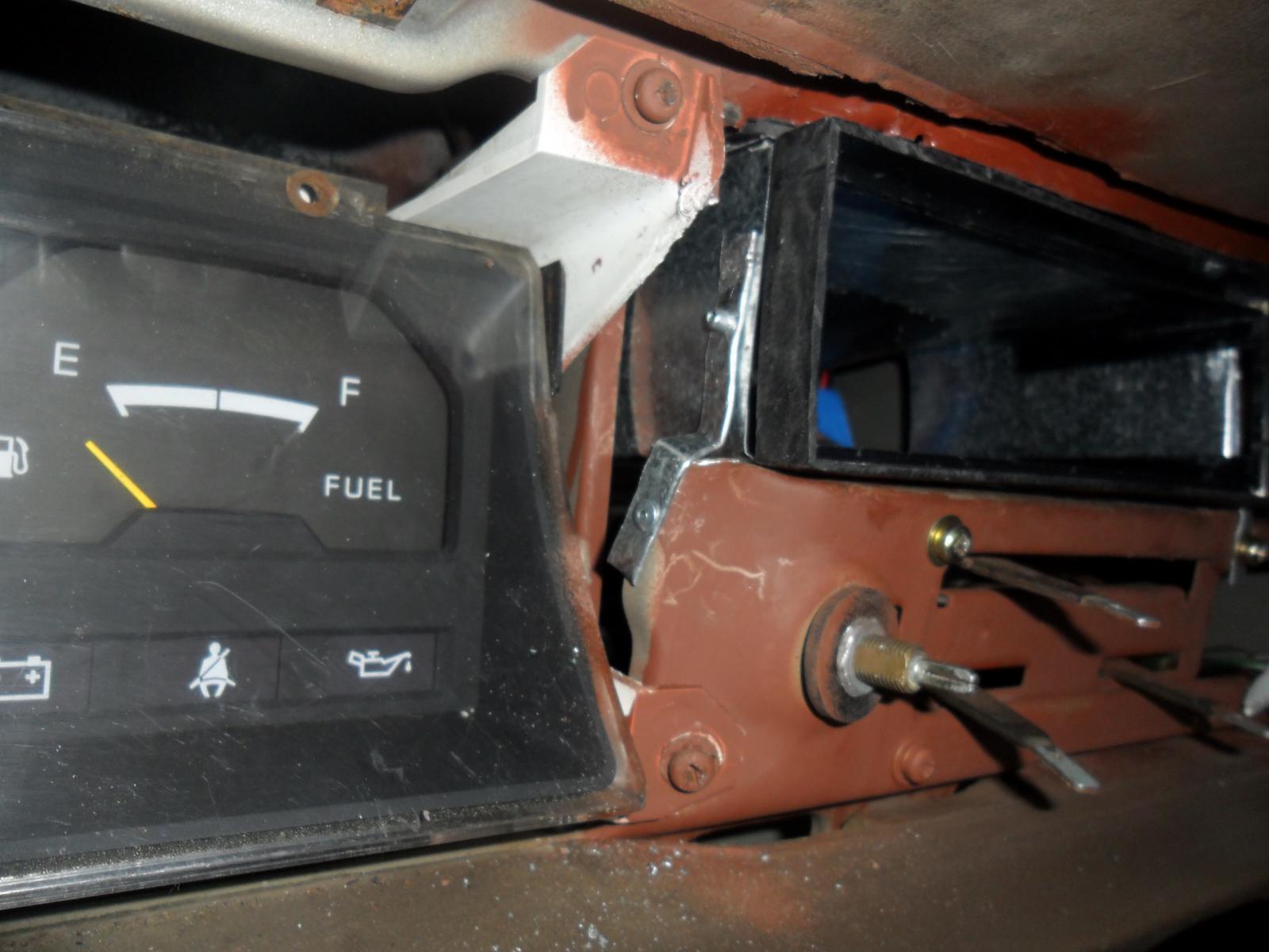

I decided to install the CD./radio unit I bought myself for Christmas a couple years ago. Well I have the dash speaker out. It is an oddball. I found this website but the speakers they show come in pairs and do not have the correct mounting holes. https://www.sonicelectronix.com/dodg...-speakers.html So I emailed them the picture and am awaiting a reply to see if they have anything that fits properly like the OE. :)) Does anyone have that speaker part number?
Attachment 20464

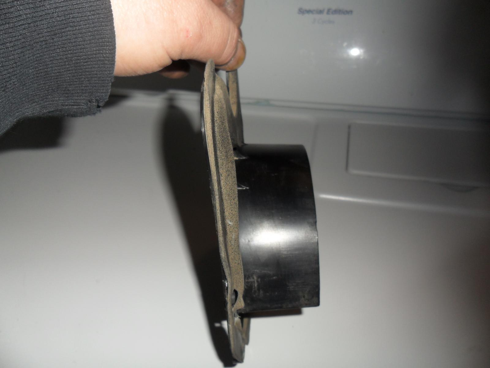

That is 6.75" center to center on the mounting holes. 3.5x5.75 actual speaker measurement. I can see how a 5.25 round speaker might fit if the two corner mounts were far enough apart. I was hoping the good 6x8 out of my Dakota would fit. Off by about an inch and probably too deep for the location.
I don't want to throw a wet blanket your plan, but why are you using an OEM single speaker with a new CD radio head unit? You have spent the money and it would be a disappointment not to get the enjoyment out of it. The new head unit will have at least 4 speaker outputs which is a quantum leap over the mono channel radio Mitsubishi fitted over 30 years ago. The door chassis will take a pair of 4" speakers, but with any older vehicle you will need to cut up a trim or make speaker mounts to get the benefit of car audio. There are good ways and not so good ways (like my Gen 1 where some idiot took an angle grinder to the rust free doors to fit the nastiest, cheap 6x9's and consequently destroy a pair of good door trims).
:)) Thanks Geez. The head unit is a cheapo $55 job from Malwarts. I did not know better and I cut up the dash when I put the $25 tape deck radio in it and threw the OE AM radio out when I bought it. I also cut two holes for 6" rounds in the doors. If I knew then what I know now... I am going to use two door speakers from my Dakota(I replaced all those speakers) and the dash mounted speaker if I can find a good one new. I had planned to get this item http://www.stylintrucks.com/parts/dashtop_highliner_headliner/1104000116_32560G.aspx# and go with 5 speakers but they sold the last one that fits the 1st gen. I waited too long.

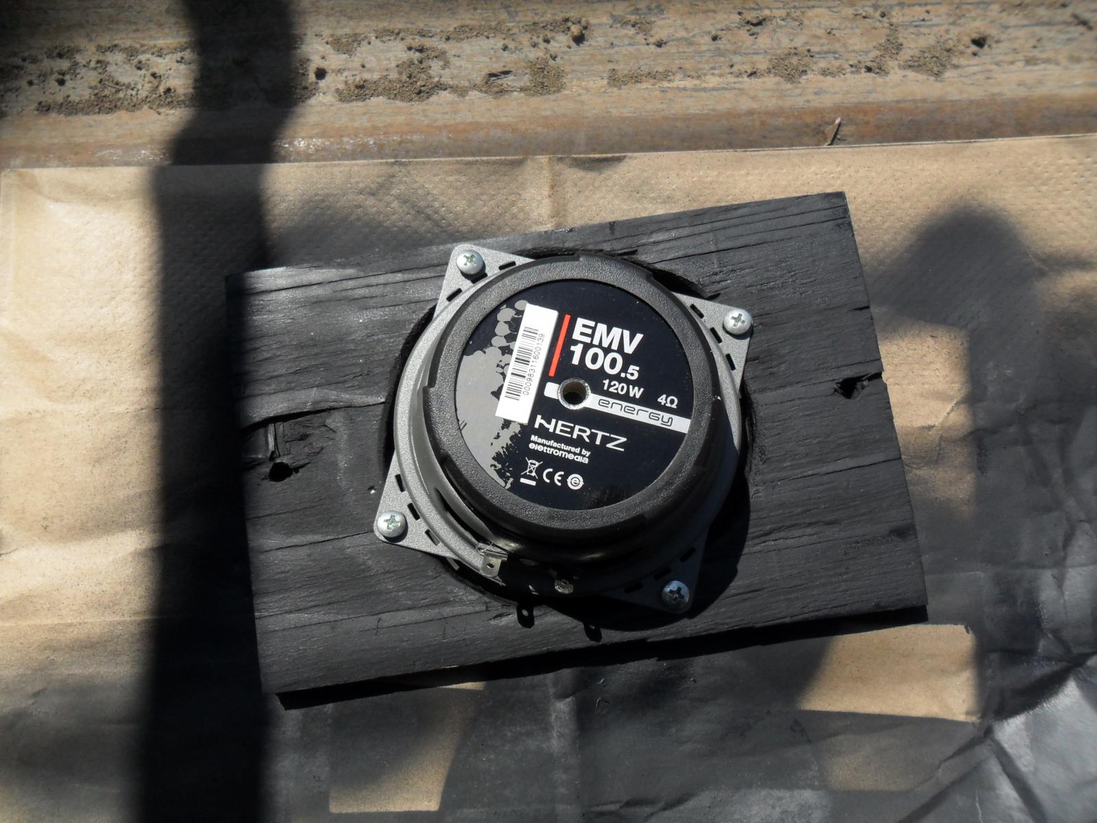

EDIT- THIS METHOD DID NOT WORK. THE PLYWOOD WAS TOO BIG. THE SIDES OF THE OE SPEAKER MOUNT ARE THE ABSOLUTE LIMIT ON WIDTH. LOOK BELOW I REUSED THE OE SPEAKER FRAME.

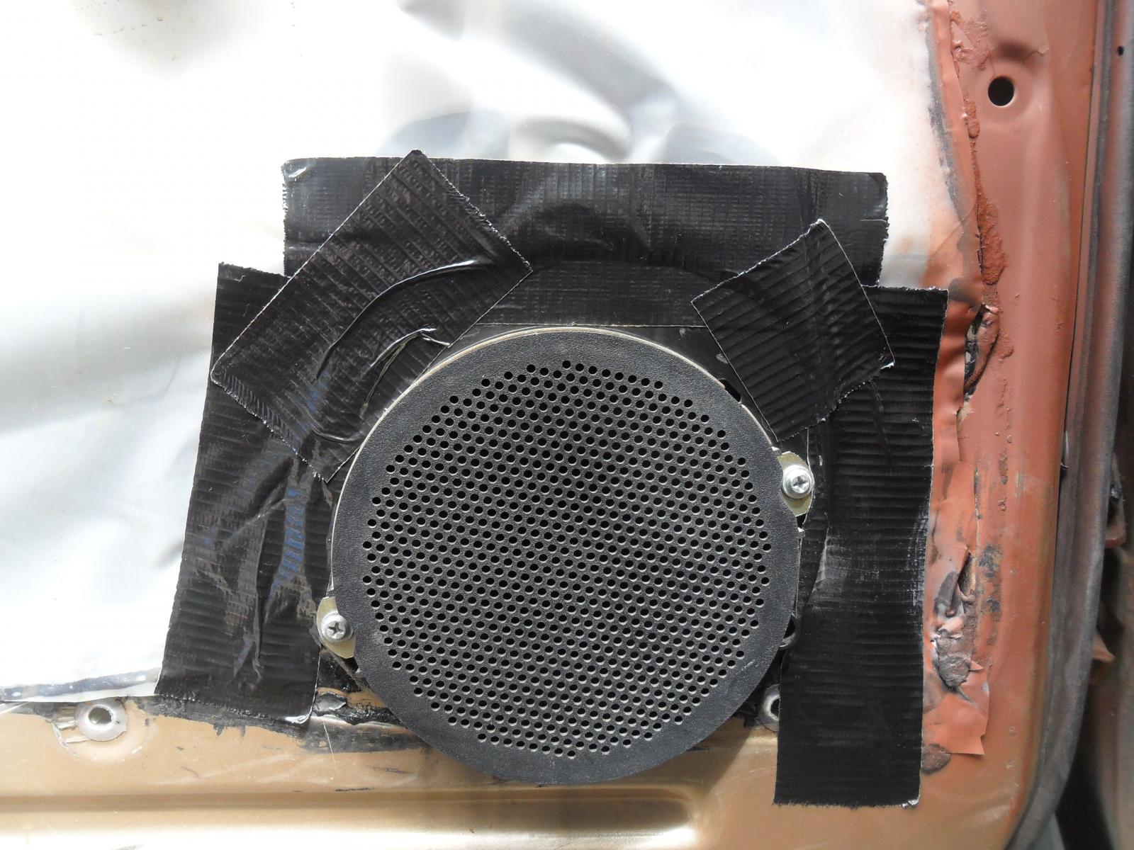

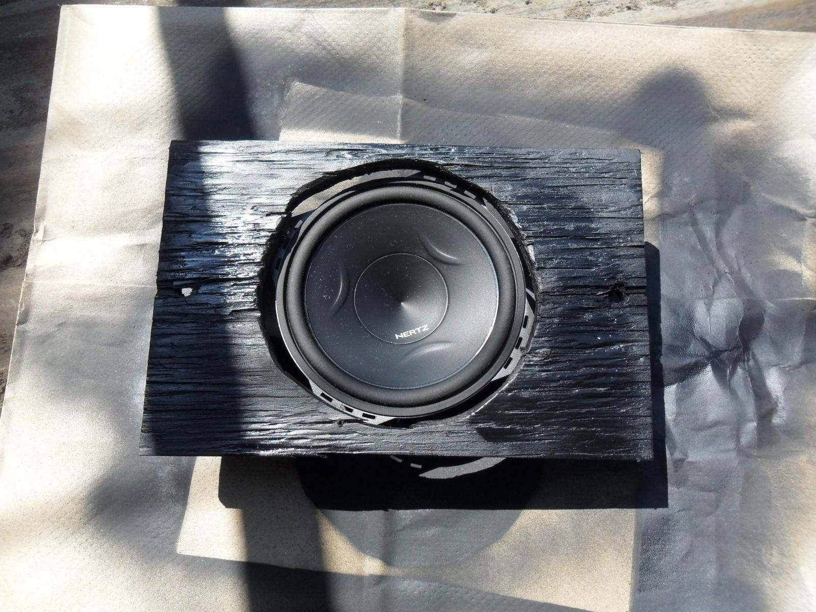

I went to the stereo install place that I know of and I got a pair of 4" Pics attached. The guy who would have installed it let me know he was just going to use a piece of plywood, wink, where the salesman was talking about "making a plate" , Once he told me that I realized how to fix it and bought the speakers being recommended. IDK how to judge but you gotta trust people sometimes. He told me he gave me a $50 cut in price. I paid $80 for the two of them. So here are pics of the solution I came up with. I have not stuck it in yet because I am waiting for paint to dry so I can go get some spade fittings that fit. The ones I bought at the hardware look right but are too tight. Once I get that in and a wire dangling I am going to s solder the rest of the connections if I can and for the Chrysler door speakers I am going to have to see if Crutchfield will send me a set of connectors so I could use the OE connector.
http://www.mightyram50.net/vbulletin...id=20482&stc=1 http://www.mightyram50.net/vbulletin...id=20483&stc=1 http://www.mightyram50.net/vbulletin...id=20484&stc=1
It's good enough for me. I used half inch plywood when I broke the 1/4 inch twice. I'm sure you could use 1/4 if you had a better jigsaw than I. The hole in the middle was to be 4" maybe just a bit bigger, I might be a bit a lot bigger. A hole saw would be best if you had one. Finding screws short enough to mount it to the wood is a problem too. If I couldn't get them I was going to grind off the extra from the stock screws it came with. The two holes for the mount I drilled straight through the old speaker 1/4 inch hole. I'm hoping I do not have to try to mount it on top of the board. I may put a bit of landscape fabric over it to protect it from sun.
The speakers have nice big magnets on them - a good start. Best way to know if you're looking at good or junk speakers - decent sized magnets, the chassis of the speaker feels solid, decent speaker terminals that aren't just tabs held on with tiny rivets, the speaker cone is either paper fibre that has been doped in some kind of resin or a poly type plastic that doesn't feel like the lid off a sandwich spread container, and a firm urethane suspension ring holding it together. Good reviews for the price tag on the EMV 100.5 speakers, I think you got a good deal! These need to be properly mounted to make them shine - the gaps around your speaker mounts will affect how efficiently they work.
Buy a sheet of MDF for your speaker board. It's a lot more forgiving to cut up and sand than plywood. While you're there grab a can of spray on adhesive and find a scrap of felt from somewhere (big enough to cover both speaker mounts) Spray the board and the back of the felt with the adhesive and when it's tacked off, press the 2 together and smooth it out. Pro finish for chump change :thumbup:

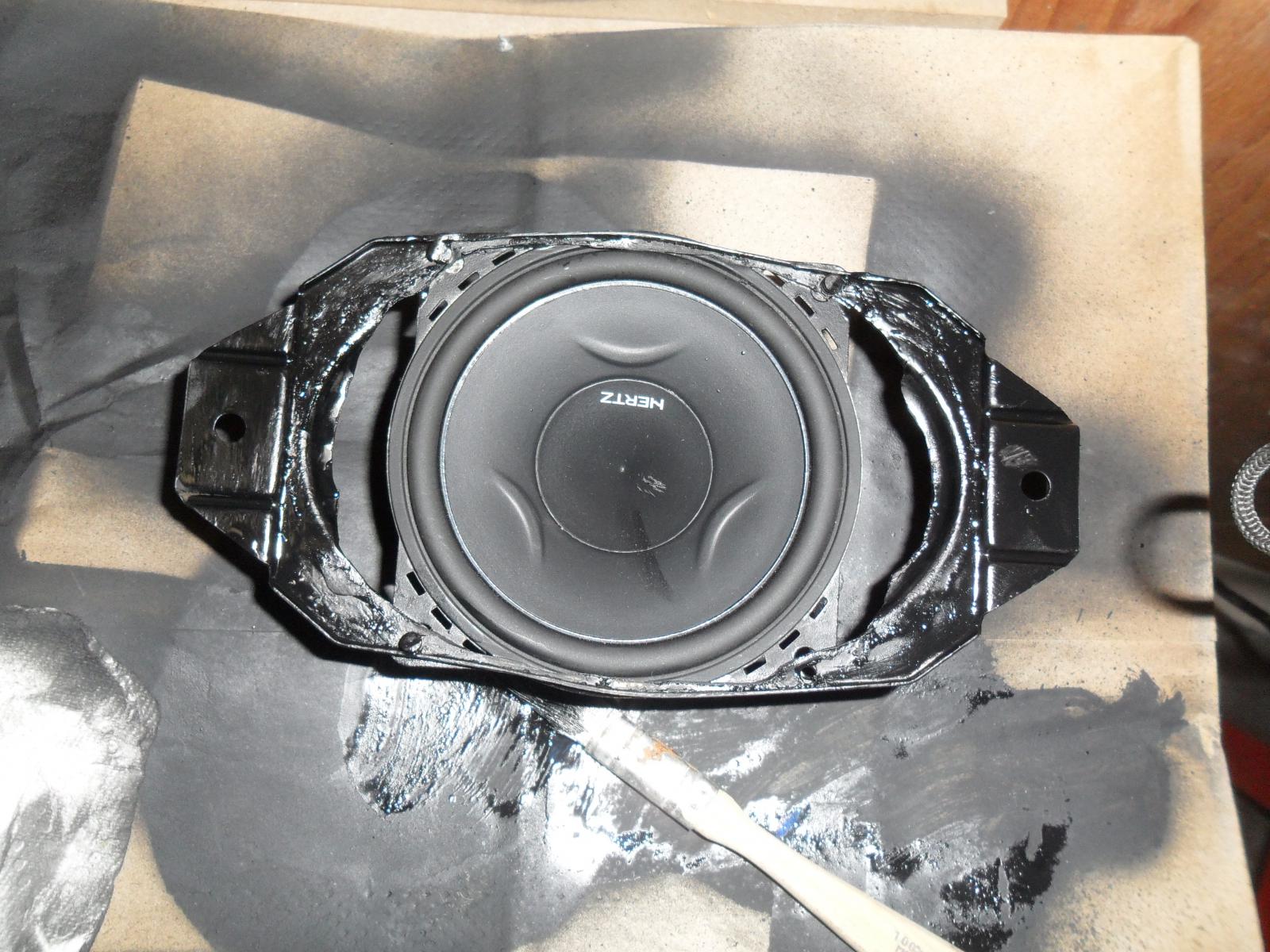

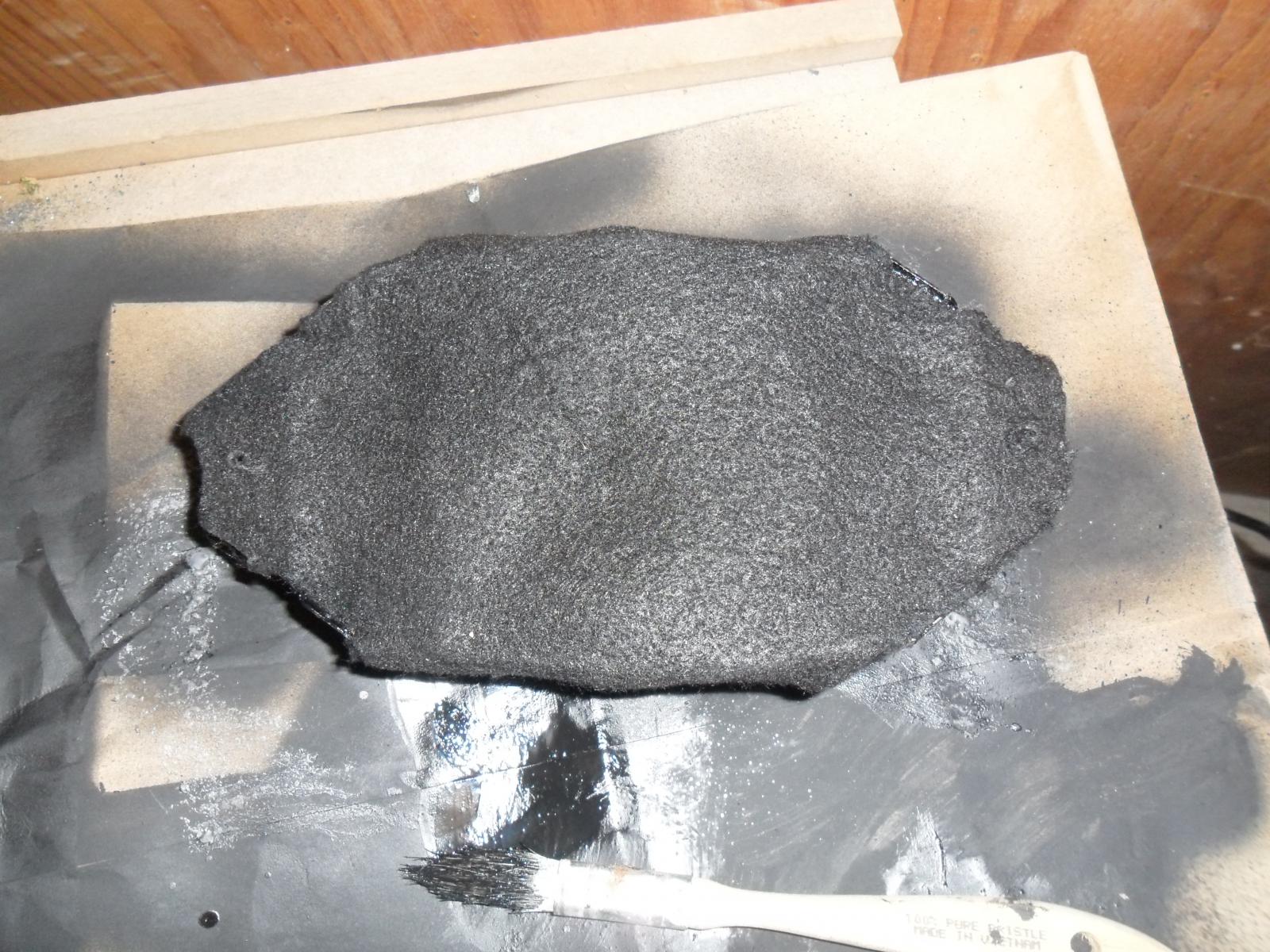

The plywood was too bulky. The absolute limit on width is the width of the OE speaker. I chose to cut up the OE speaker frame and screw the new one to it. If you have a nice cutting wheel for your grinder that would be best to do the job. Make the cut out flush on the back side. I marked the holes and used a drill to make pilot holes before screwing the screws through those hole, then I mounted the speaker to it. I had to cover the cone and grind off the top of the screws (sheet metal self tapping 1/4 long) then paint. I used a paint brush and sprayed a puddle to dip it in to get at the fidly bits. The felt did not want to cut after I glued it on so it looks like heck. The thing is mounted. :)) I discovered on my trip to the JY that the gen 1 Dakotas are getting rare around here no joy finding OE speaker harness connectors but those spades that did not work on the new speaker will work on the OE dak speakers I am going to put in the door. I got a plastic sleeve that holds the short locking sleeve that comes with the head unit and some speaker backing for the door for free. The sleeve is too fat around the edges. I'm going to look for another one. Here's the new pics. EDIT- the speaker backing is really a kind of mount with molded in cover to protect the speaker from rain. I'll take a picture when I get to mounting them.

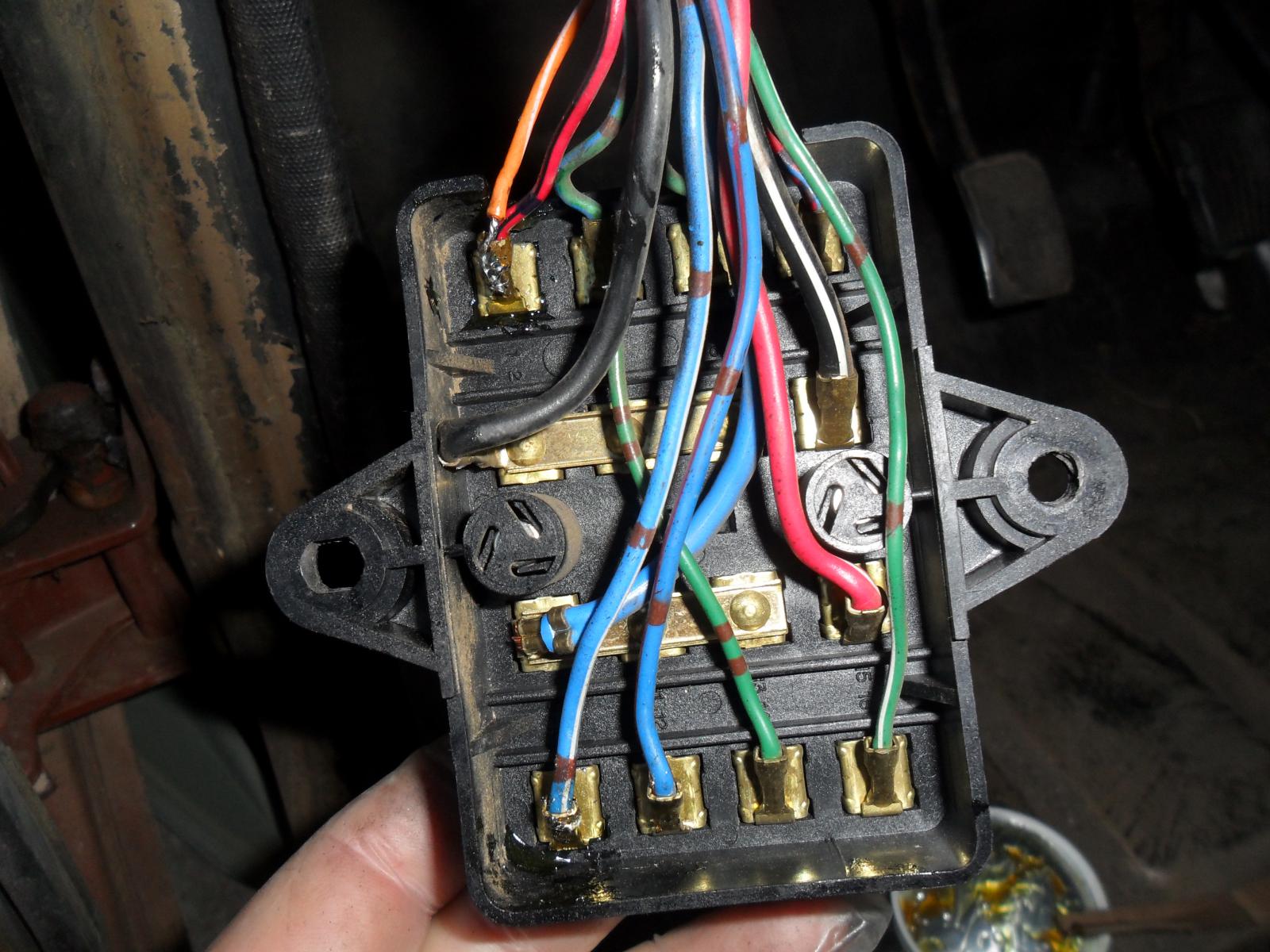

Run a wire from the back of the fuse block for permanent power (yellow wire for the new stereo harness - add an inline fuse to protect it in case you get a short by it accidentally grounding out) Disconnect the battery, take out the 2 anchor screws holding the main fuse block in and go through from the back. Tape the permanent power wire up to the wiring harness with electrical tape to keep it neat. Don't run it from the battery, it's totally unnecessary and can set you up for another electrical problem (and it'll save from trying to go through the firewall...) The dash chassis isn't laid out well enough for a modern standard single DIN head unit with speakers, there's not nearly enough space (which is why they used a shallow oval speaker - these trucks were meant to be really basic)
I have The power wire soldered to the back of the fuse block on the Radio fuse which in bottom left on mine. The unit came with an inline fuse for the memory wire which I fused with the power wire as I want it to work without the key. The fuse I connected it to cuts power when the key is off so it won't remember any stations. That speaker in the dash sounds dam good.
Do you have any idea exactly what wire I cold get constant power from?
There's a primary power wire from the battery in the fuse block - the fat red one that goes to #8 'tail light/clearance' fuse. This should always be live. To make sure, stick a test light on it and ground the other end to a bolt or bare metal under the dash. Should be the one.

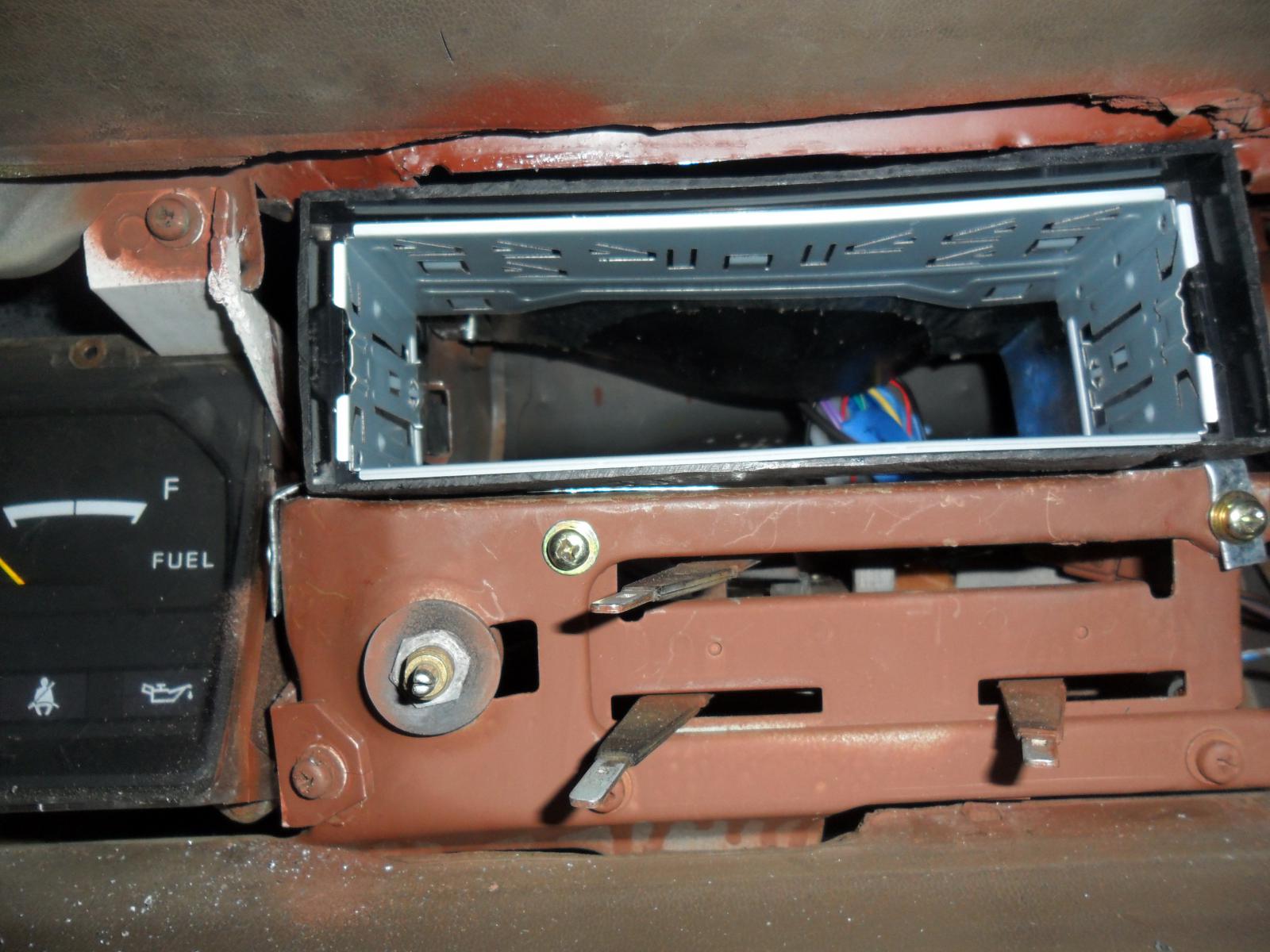

Thanks I'll get to it tomorrow and let you guys know. Still no clear method for installing the head unit. I have the dash bezel back in without the screws and the unit wedged at a downward angle. I might have to ask a shop about it.
I felt better after my food digested and I folded the laundry so I had a crack at it. I have a multi meter and it showed me that the red one was dead but the 3 on top from the left and the fat black on were all hot. So I soldered it to the top left one. Radio works with no key now.

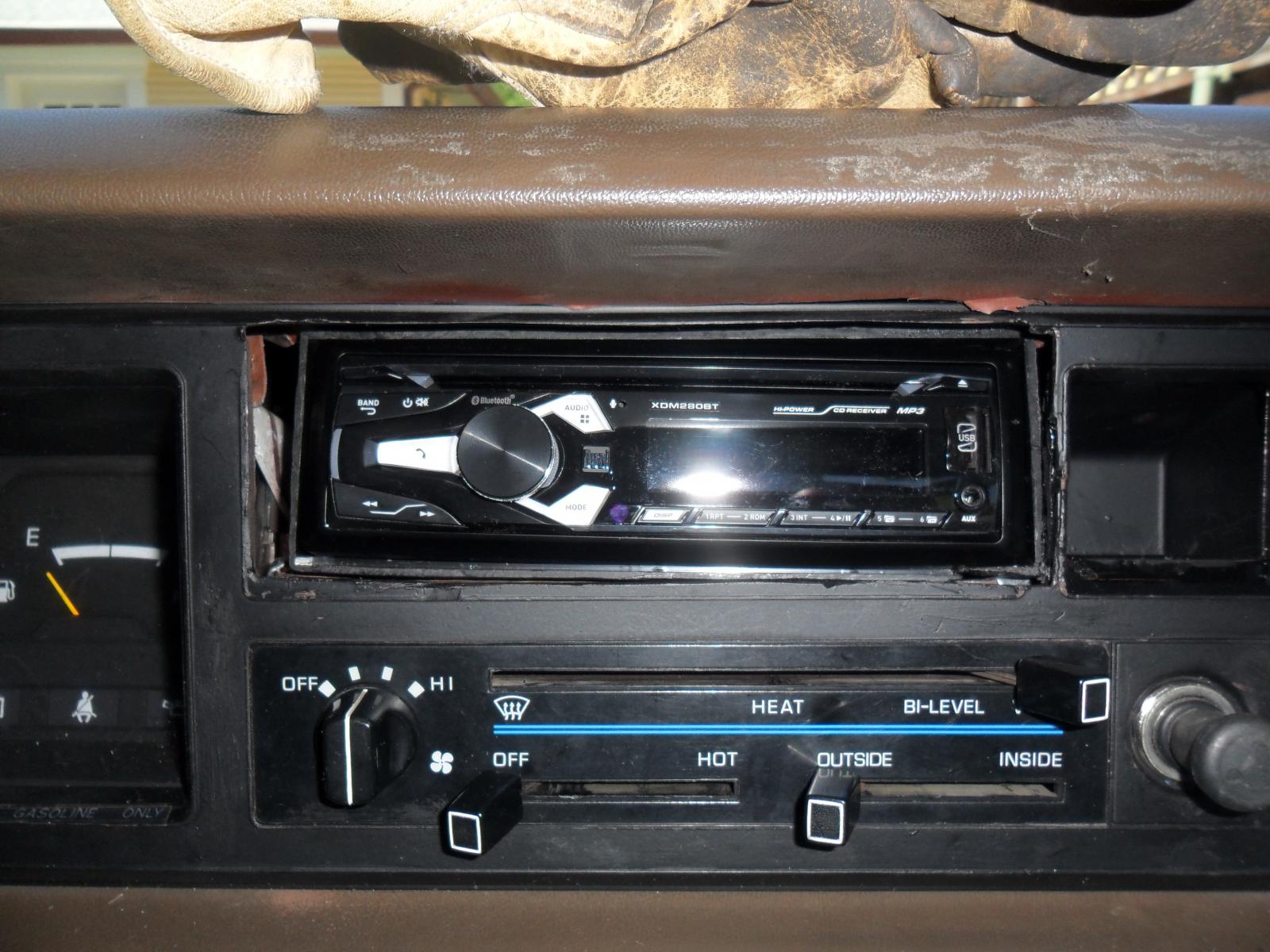

Well I turned it off and back on and the station I saved was still there as were the settings. I connected the memory wire and power wire then used the old wire I had for power on the last unit. So if there is power there is memory. There will be a picture of the fuse block cover at the end of this post. Bottom right would be the top left I soldered to. I honestly do not comprehend what some of those terms mean.

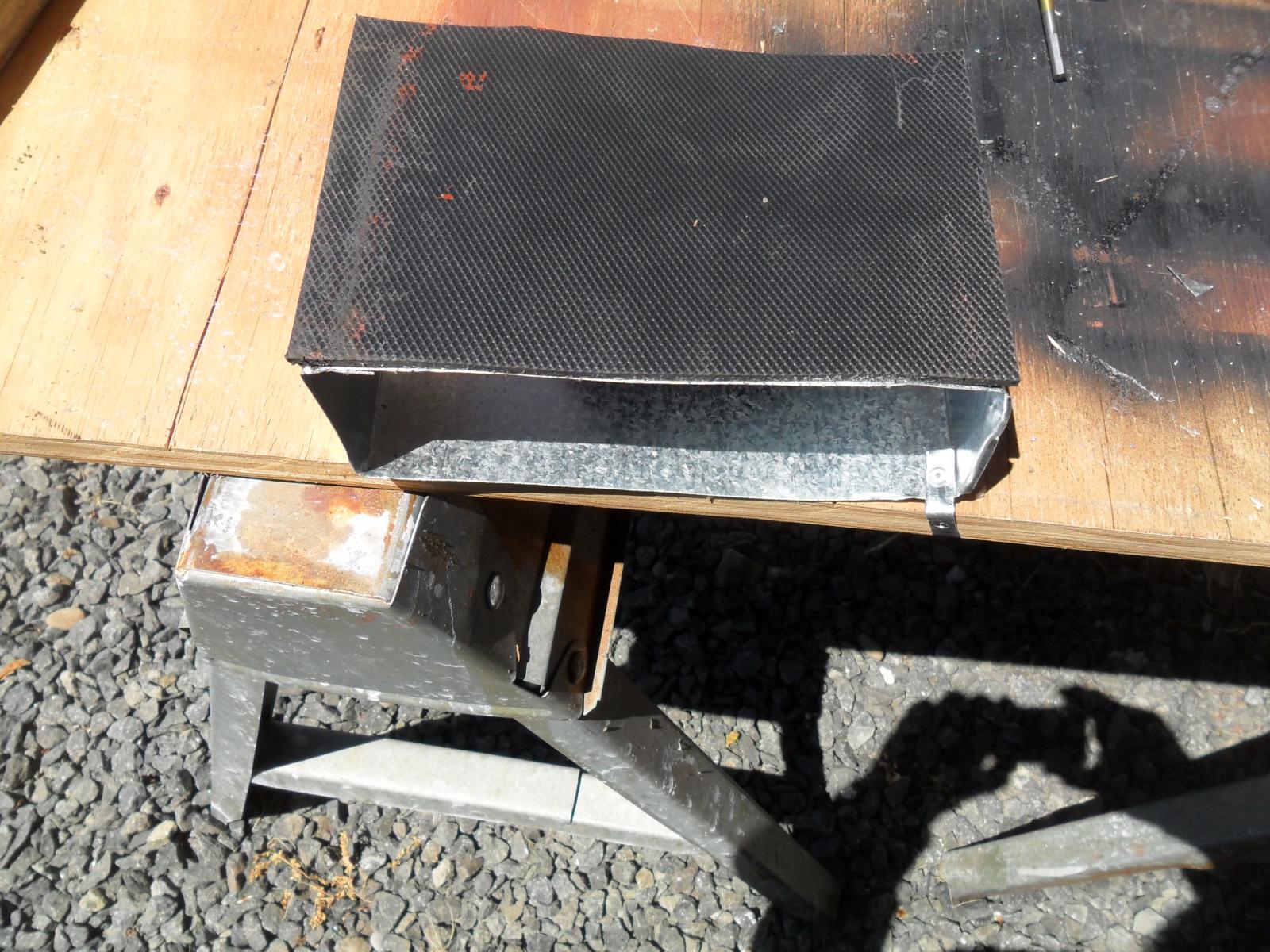

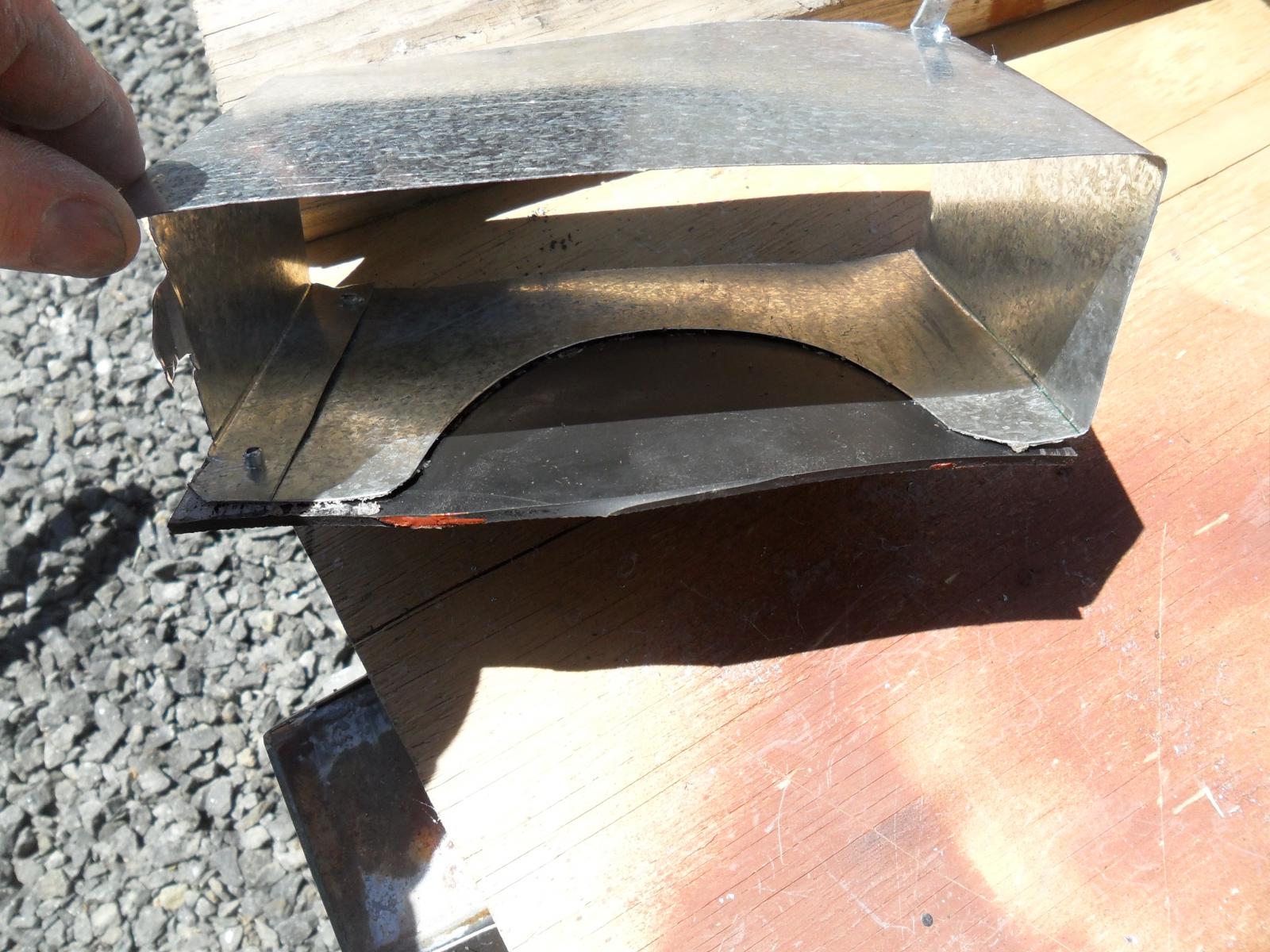

Here is my solution to my problem with the speaker and the cut out on my dash. Looks like I need to take it apart sometime down the road and pull that left side out further so it sets closer to the face of the dash panel.
What I came up with was to build a box with galv Sheet metal. Then line the top of it with non-conductive rubber. I bought what is called Switchboard mat. Cost $11.50 per foot off the 3ft long roll. I used 7" piece of my 1'x3'. I riveted the box together (had to crush the rivet near the front with vise grips so the plastic frame would fit.) spray glued the mat to it. I found out my tabs would not work so I folded a strip of sheet metal. I suppose it's called hem even if that is all I was using of the metal. Then I riveted a piece down in the lower right corner and drilled a 1/8 hole so the top right screw of the heater controls would hold it. I can't find the picture of that. Then I riveted a piece on the left to the dash metal that is still there and when I got the box set riveted it. (I probably need to redo that eventually. It left a big gap) Then I slipped the plastic frame for the basket that locks the unit in. Put in the basket pulled te wires out and plugged it in. After messing with it a bit I pushed it home. Attachment 20530 Attachment 20531 Attachment 20532 Attachment 20534 Attachment 20533
Any 4” speakers will drop in. I just installed some kickers last week and used the plug and play adapters no cutting st all.

Well got it mounted again. Its not great but will do until I decide to do something else. :thumbup:
Battery keeping charge now? At least you have choons :thumbup:
Yes battery held its charge. I'm gonna have to work out a better mount or spring for a pro eventually.
Edit- Careful how you route the wires. The power wire I just added wasn't up as tight as I thought and it got grabbed by the hand brake ang cut power to the radio. :(
