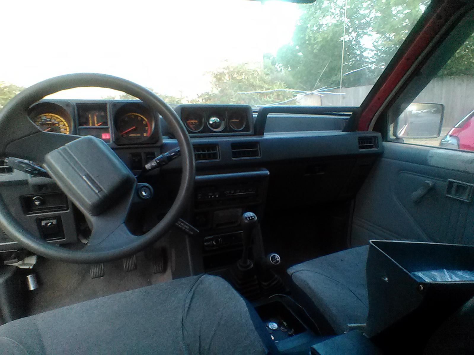

Yeah that Montero dash is mine. I'll put a pic up for those who've never seen it. I'll agree that it's quite "80's offroad truck", but since I have a 4x4 that's what I was going for. I wouldn't want to put one in a 2wd, and that center gauge pack unfortunately looks a bit out of place on our dashes.

It was more or less the same size, but calling it a close to direct fit is a bit of an overstatement. The dash itself had to be modified in height, width, shape, and depth, and the steering column was moved over about an inch to fit in the correct spot. Ended up looking pretty much how I wanted, but it wasn't exactly a weekend job. The dash took as long as the entire drivetrain swap, mostly in trial and error. I still haven't hooked up the air ducts due to very tight clearances and a lack of time.

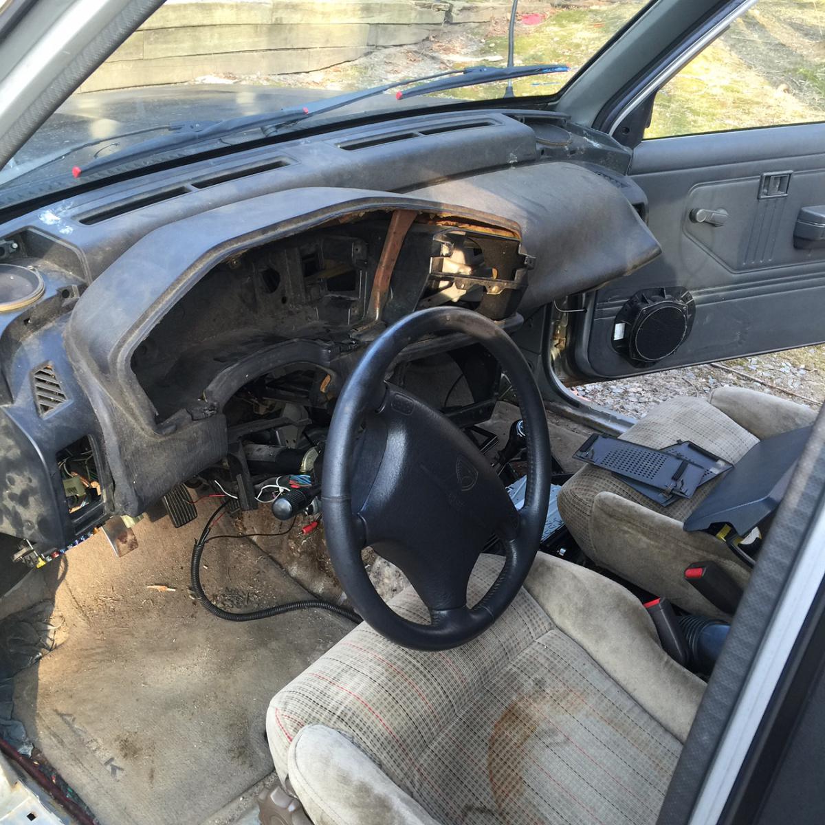

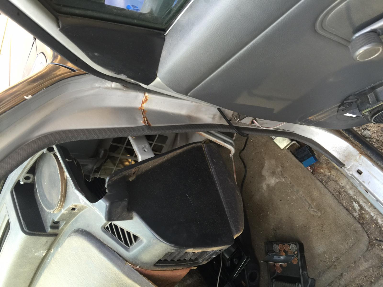

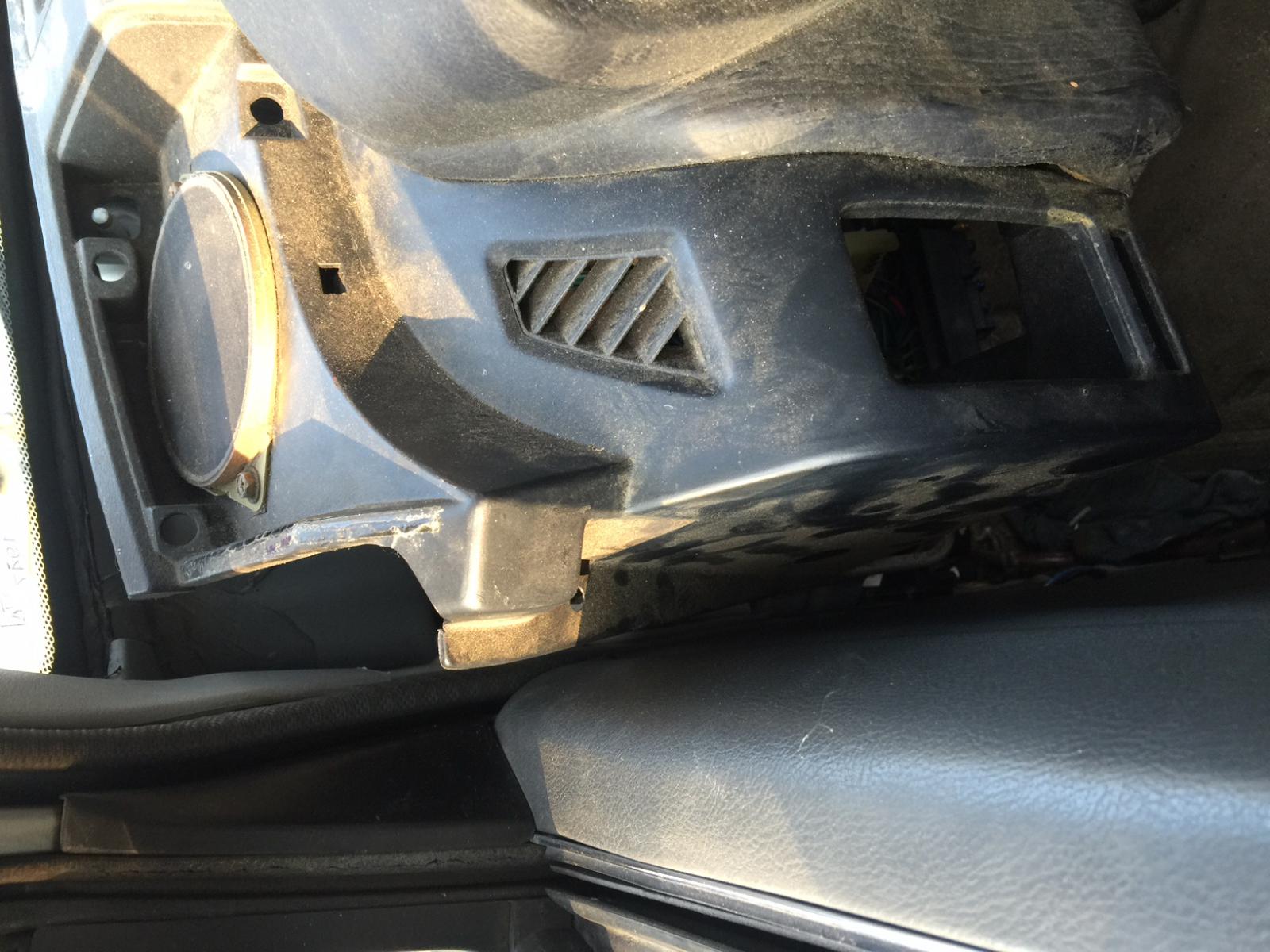

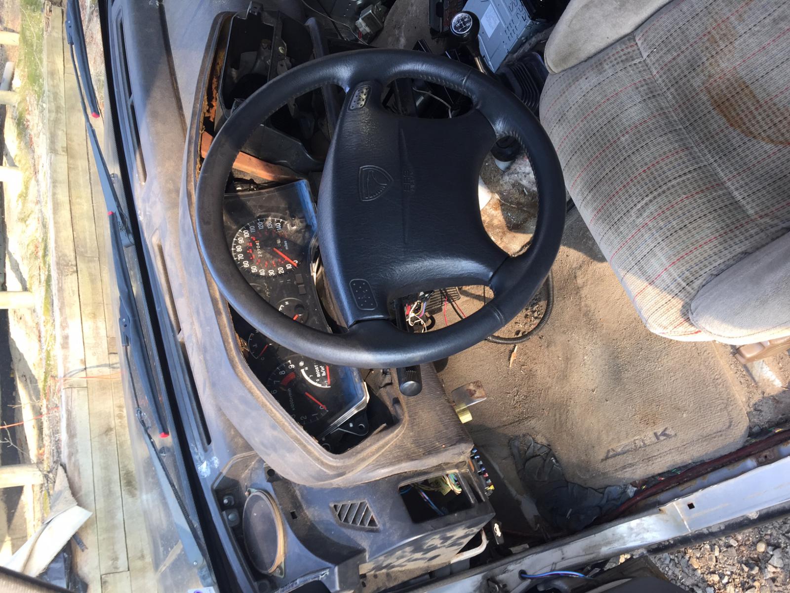

So I had about an hour and a half today to rip my old dash out and test fit the DSM dash, it is pretty far off in the corners, I will be trying a 2g dash next as a 2g dash is about an inch or maybe slightly bigger than a inch wider. I would love to get a hold of a 91 galant dash as that seems to be almost an identical match but I fell like ill never find one around here.
Attachment 15996Attachment 15997Attachment 15998Attachment 15999Attachment 16000Attachment 16001Attachment 16002

It's not my first time per say doing dash swaps, I can easily get everything to work but I'm looking to keep my defrost for the windshield, a 2g Dsm dash would be better because it is physically bigger, a galant vr4 dash is almost a direct swap. Heater core is t a problem, can always fill forewall holes and re drill for heater core lines. It's all fairly simple once you get the dash situated. Here's a pic of another project we are doing.

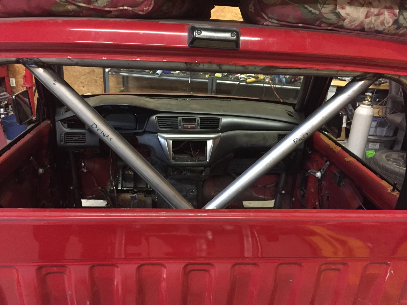

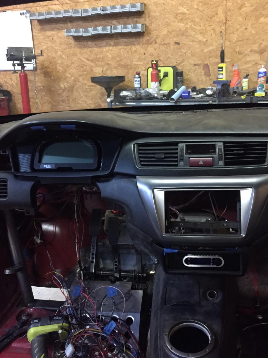

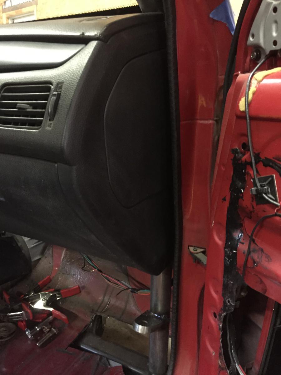

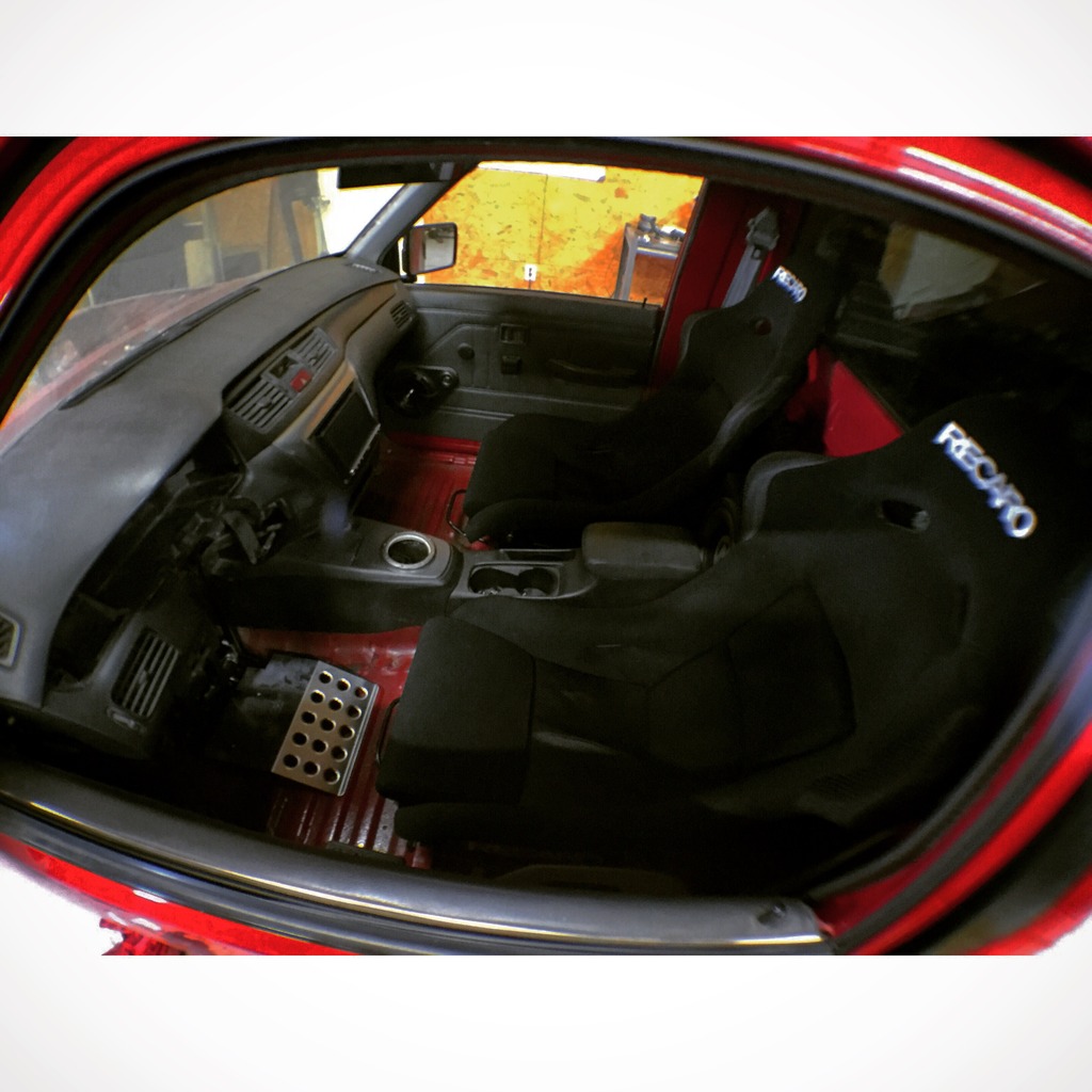

Evo dash in mine, wasnt too bad and put the double din in a much better location than with the factory MM dash. Width wise it's an inch narrower, then you have to cut the top back quite a bit. Running a vintage air aftermarket ac/heat setup so fitment to stock stuff is unknown.

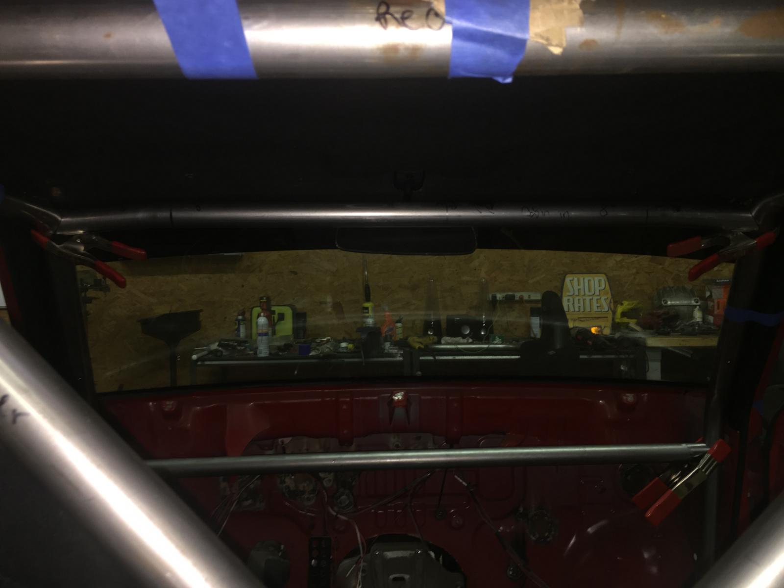

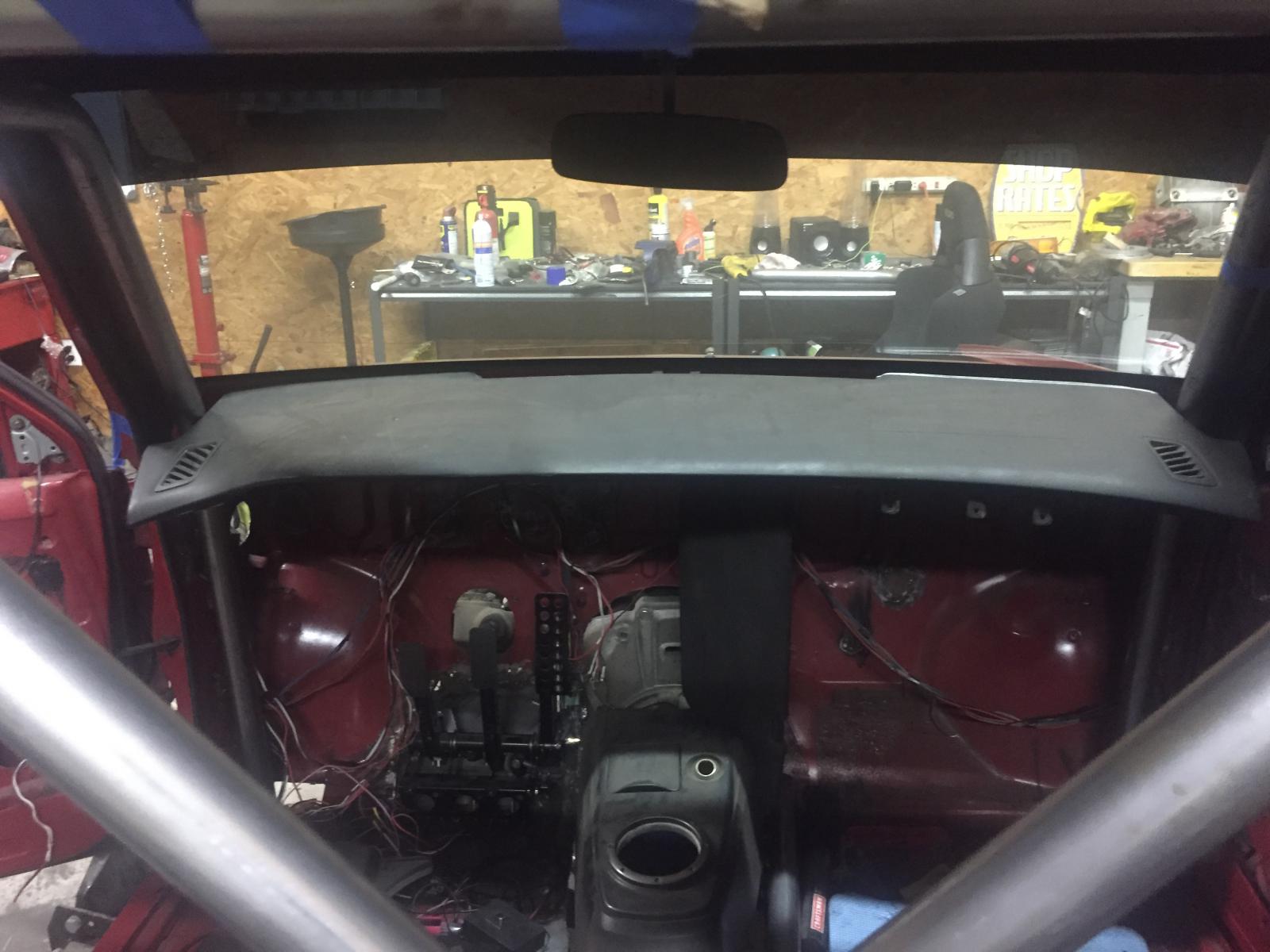

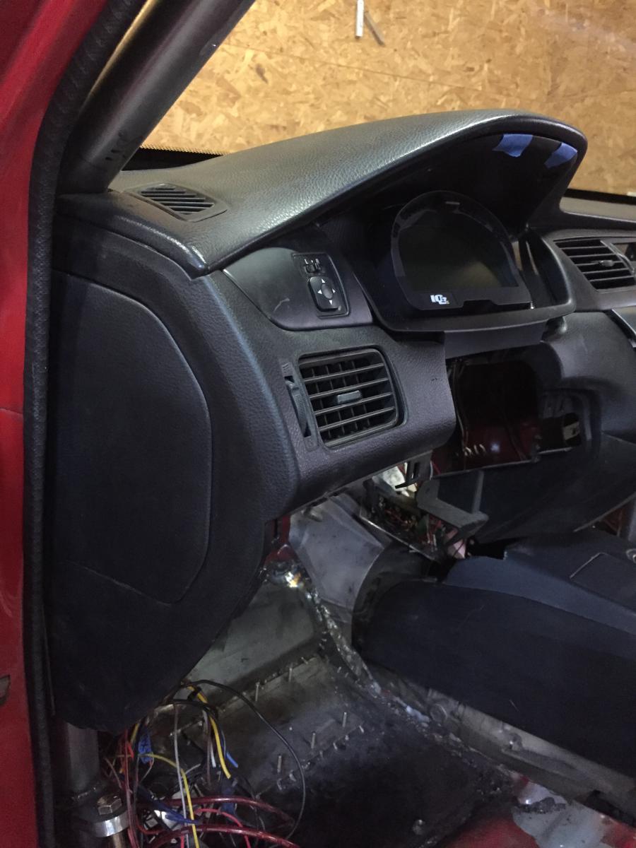

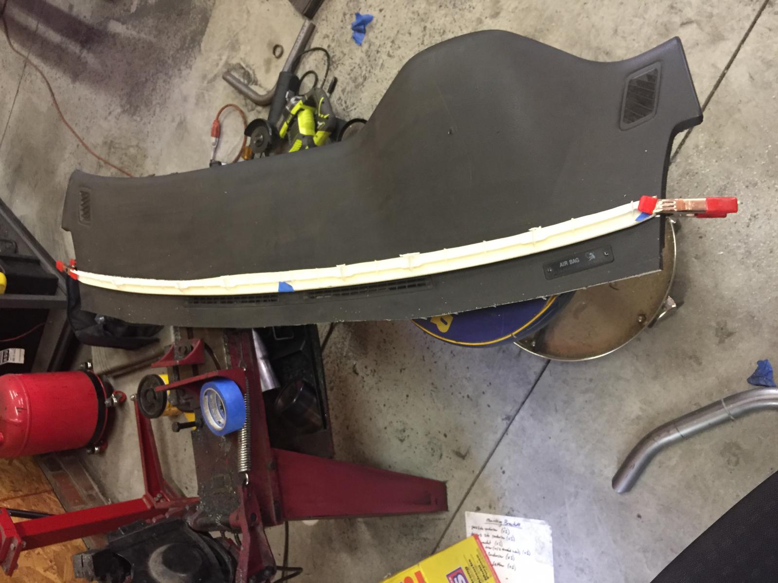

thank you! finally got to re-install it after building my cage. Here are some pics of it all mounted up. Center mount wont be complete until I finish the new trans tunnel/floor so it's sagging a little bit. I snagged a lancer dash bar from a local yard and cut the dash mounting brackets off of it. Potentially not as clean as making completely new tabs, but saved me the aggravation of trying to get it dead straight on my own and cutting a bunch of little brackets. The sides of the dash were not trimmed at all, the top (its removable) was cut back like 7", just enough to tuck the sides of the dash behind the edge of the a-pillars. I've got it leaning a few degrees downward in comparison to the evo I measured the other day, but this was to achieve a clean window to dash lid line without the sides of the dash fitting unevenly. Any questions just let me know! thanks!
Attachment 18231
Attachment 18232
Attachment 18233
Here's a pic of my old setup. It wasn't bad, and I was able to fit the evo center console and armrest without much modificationAttachment 18234

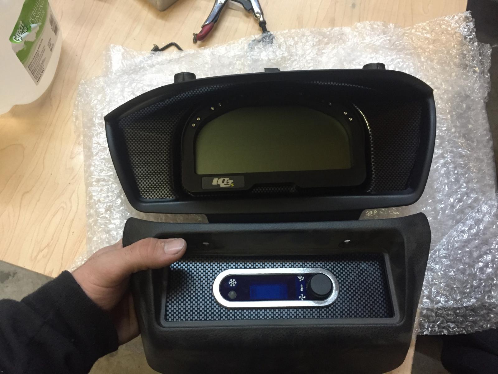

im running an AEM in this truck as well as a vintage air ac/heat assembly, so opted to go with this cluster and climate control to keep things cleaner and simplify the wiring. panels will be black, didnt know the carbon was fake when I ordered the panel lol
Attachment 18235
Attachment 18236
Attachment 18237
Attachment 18238
Attachment 18239
