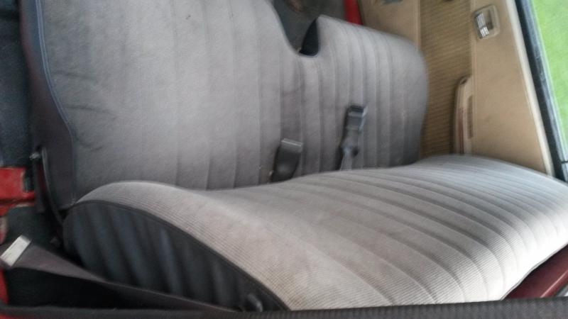

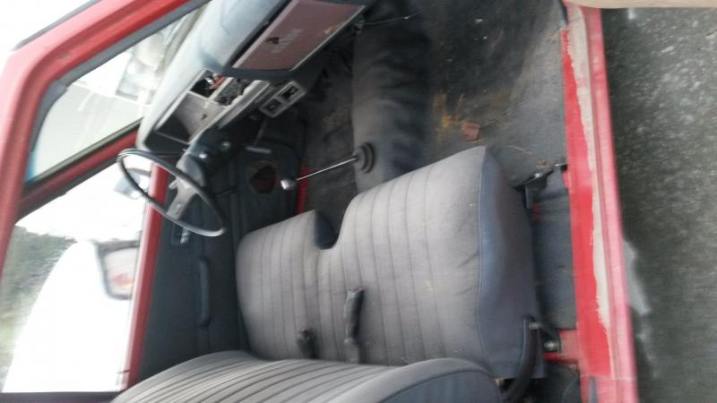

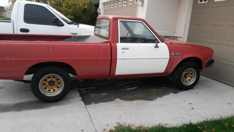

I keep asking questions about my truck throughout the forums, figured I'd just start a build thread. I'm working on the name still. This is my 2nd D-50 but I did very little to my first one (regret getting rid of it). I'm building it to be my daily driver, and while I plan to keep performance primarily stock, I am going to rebuild nearly everything. I'm still deciding on how much body modifications to do, but I'm definitely repainting and doing new wheels. First and foremost, got to get it running. I bought it with a blown head gasket and found out it has newer head, without the jet valves!!! Not sure how much the previous owner spent on that but I'm not complaining. Vehicle came with the 2.0 but someone switched it to the 2.6. Got myself a weber carb and conversion plate. So far planning on just keeping the stock mechanical fuel pump.Attachment 11820Attachment 11821Attachment 11822Attachment 11823Attachment 11824Attachment 11825Attachment 11826Attachment 11827Attachment 11828Attachment 11829Attachment 11830Attachment 11831Attachment 11832Attachment 11833Attachment 11834Attachment 11835

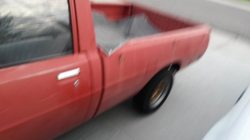

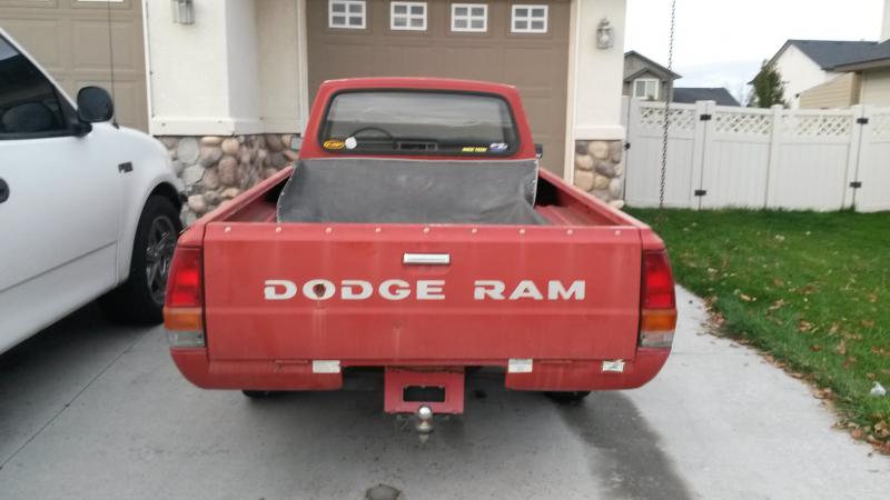

That last picture is the red I'm planning on painting this. Kandy red on a black base.
Can we pull mine in the booth to?
I absolutely despise body work. Only reason I'm painting at it all is because it's 2 different colors. I'll let you use my booth but you gotta do the work on both trucks. Haha

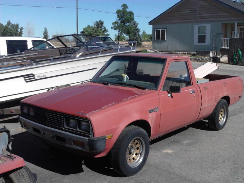

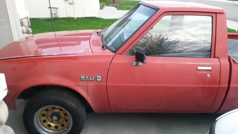

Great color choice. Looks like a good clean truck to start with. Those wheels look okay to me but yes some newer ones would be a nice touch. Good luck on wheel selection as the six lug leaves us quite limited with selections.
Yeah I've noticed that CRV. Until I find what I'm looking for I'm going to paint mine black. I agree that they aren't bad, but the gold isn't really my favorite. It really is a pretty clean base. Only major dent is on the hood and it came with a while new hood. Thank god, like I said, not a fan of body work.

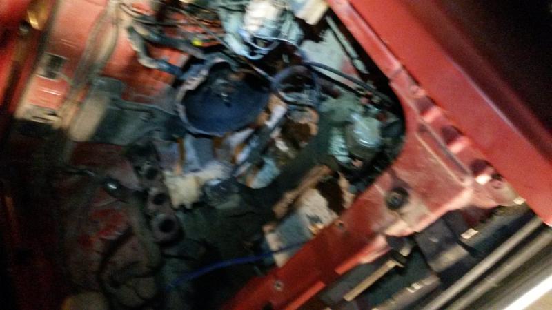

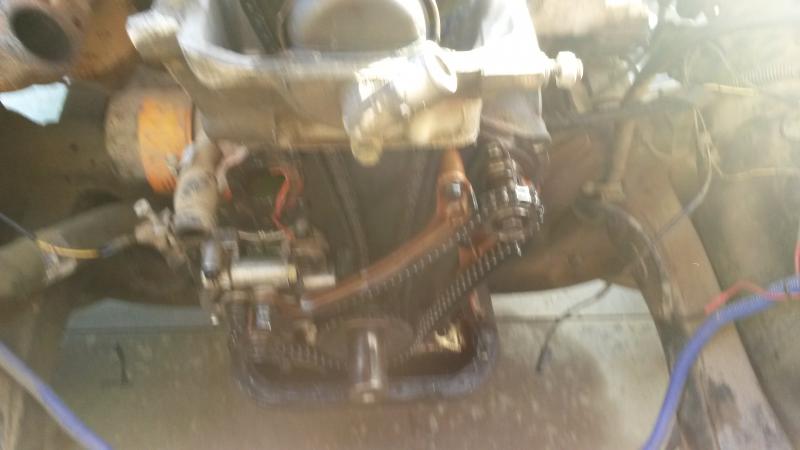

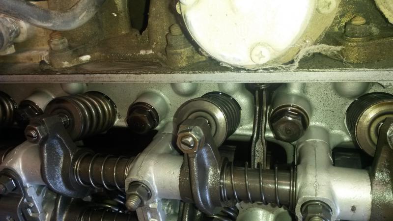

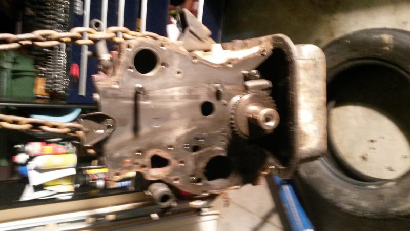

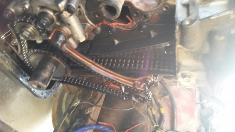

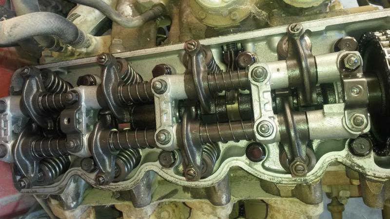

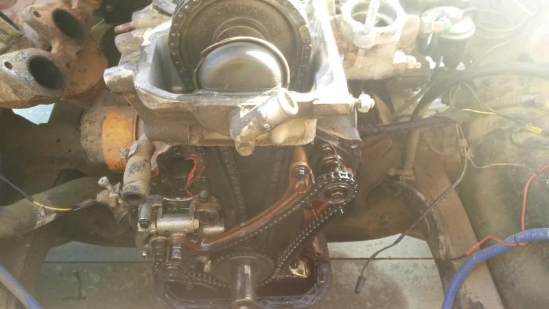

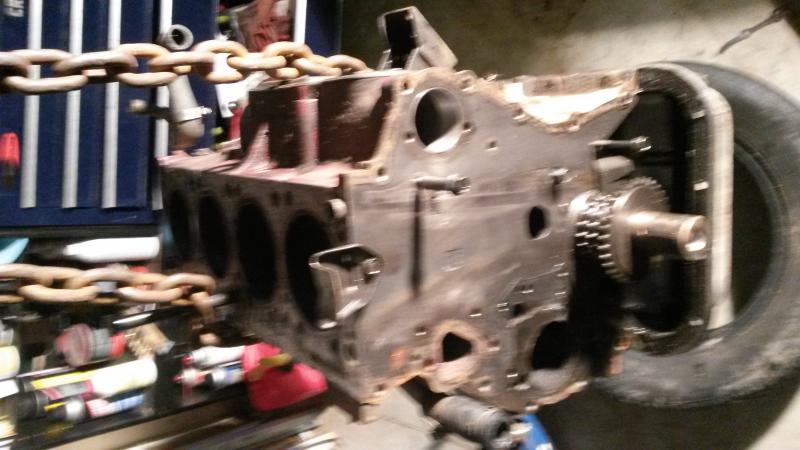

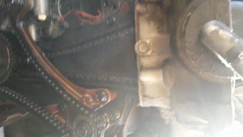

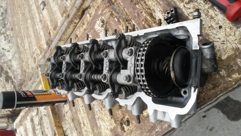

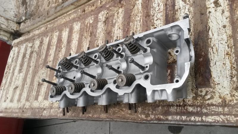

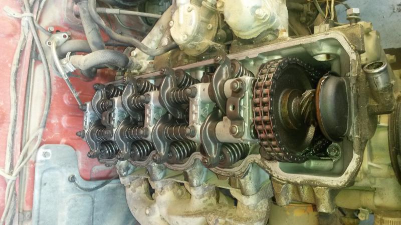

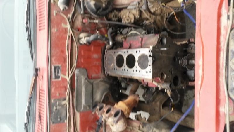

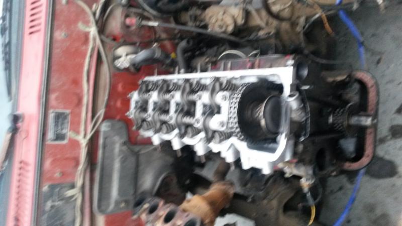

UPDATE: Adding the photos of the motor rebuild that I was going to upload 2 weeks ago, haha.
7 Attachment(s)

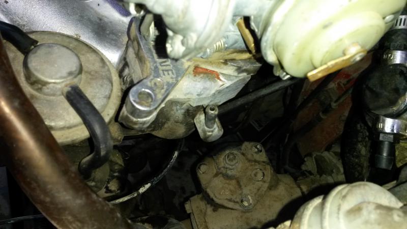

Should have taken pictures before I took it apart. Couple little things I need help with. Small vacuum line coming off the distributer. No idea where that goes. And the fuel system was messed up when I got it. I'll post pictures but I'm having a hard time routing the lines. Got one line going from tank to pump. One from pump to carb. Then I have one coming from the canister labeled "to ac" going no where, and one going from canister to tank. The one that says "to carb" on the canister has no line on it. Is it possible thru had the "to ac" line run to the carb for the return to tank? Does any of that make sense or do I need to get pictures?
Did you look at the first gen manual for the lines?
Manual isn't helping me out all that much because my truck came stock with a 2.0 (g52b) and I have a 2.6 (g54b) installed. That plus the aftermarket carb makes factory manuals sort of obsolete.
the 2 lines on the vapor canister - one went to a bowl vent on the original carb to the canister for vapor recovery. The other was a line that drew the recovered vapor from the canister to the carb after warmup - that fitting was on the firewall and went to the air cleaner. Look at my gallery pics on how I have it hooked up - since Geronimo is an 1980, his canister only has one line out of the top, but you get the idea. For the dizzy vacuum, use a port on the weber above the throttle plate - that is ported vacuum. That port should be on the valve cover side of the carb.
Pennyman, as always, you're awesome. Couple of quick clarification questions though. The dizzy vac line is perfect, thank you. The carb has two full size fuel line ports. One is obviously the "In" line for fuel feed, then there's another one directly under it, I'm wondering if that's either the vapor recovery, or the fuel return that you're talking about. The "To ac" line I was talking about earlier likely went to that fitting you're talking about on the firewall (that's about how long the hose is) but there is no fitting there anymore. I'm wondering which one I should actually be sending to that open port on the carb. I'll check out your gallery and see if your pics help clarify at all.
the third line off the pump does go to a fuel return line on your truck - Geronimo had a totally different system for that - he uses a 3 port can that split the vapor off and sends it to the tank instaed of the pump doing it.
If that is a Weber, they give you 2 fuel line places to attach the fuel line in, depending on the way your carb is installed and the fuel line points toward it.
My canister has also been change so that the vapor from the tank is pushed/sucked down the carb when the tank reaches high pressure build up. My return fuel line is no more (plugged). The vapor hose is connected to a plastic one way valve leading to the carb that opens when the pressure reaches it's limit in the tank.
That 3 port can that you're talking about pm is the same one I'm talking about. The 3 ports are labeled "to ac, to carb, to tank".
Okay I did some looking at some other Ram50's. I found one with the G54b motor and one with the G52b motor, both had the same 3 port canister that I'm talking about on my truck. On the 2.0 with an Air Conditioning pump installed, I followed the line going from the "to a/c" port and it following the firewall all the way to the driver's side of the truck. The carb was off this truck so I couldn't follow the "to carb" line, but the "to tank" obviously wrapped under the firewall as if returning to the fuel tank.
The 2.6 G54b did not have a factory A/C system and I followed the line going from the 3 port can labeled "to a/c" and it went to a small white regulator looking thing where it just plugged back into itself. This regulator looking thing was mounted on the firewall, nearly dead center. So I'm back to my original question of where do I run these 2 lines ("to a/c" and "to carb")? There's only 2 ports on my carb and they're not labeled. My carb is a weber but a much more basic model than the ones I've seen on some of your trucks. Remember that my 3 port canister currently has nothing coming out of the "to carb" port.

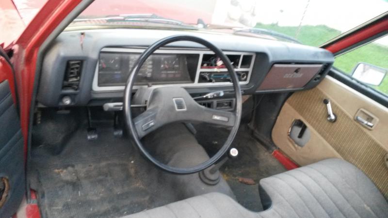

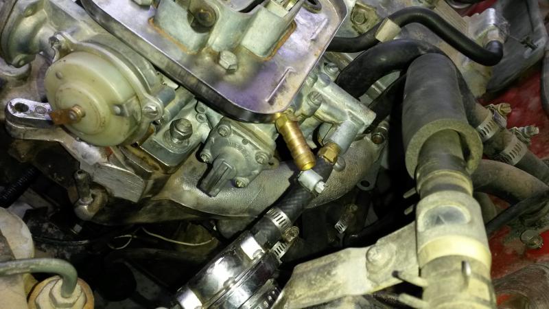

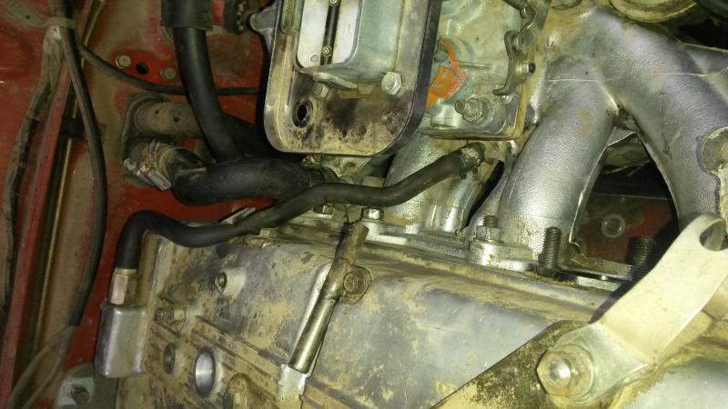

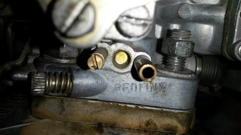

I have the dizzy vacuum line and I need to know where it goes. I have 2 ports open that it'll (kinda) fit. One on the intake right below the carb (pictured) and one right below the e-choke (also pictured). Then I have my 2 ports on the firewall side of the carb. One of them had the regulator on it because the donor truck had an electric fuel pump. Therefor I'm assuming its my "in" port. I'm assuming the other full size port is the one I'll put the "to carb" line from the vapor canistor? What about the final small port that I'm not using?
1 Attachment(s)
http://www.mightyram50.net/vbulletin...7&d=1418924967
Take the screw out of the one on the left at the base of the carb in picture #3 and connect your hose to that one. Cap off the one on the right. I made the mistake of using that one closest to the firewall and didn't realize it until I had my dizzy curved.
http://www.mightyram50.net/vbulletin...595662&thumb=1
Attachment 12223
Tighten that carb bolt too, looks like it is loose, lol.
lol thank you brad! I never would have guess that I'd have to uncap that!!
Yeah I was in the process of unbolting it.
