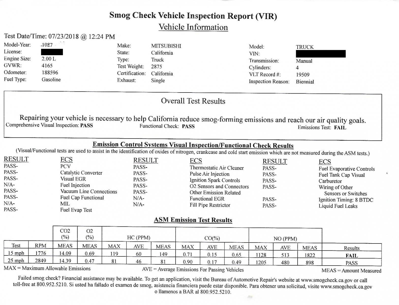

I failed smog the other day. Here's the cert. Any help would be greatly appreciated.Attachment 20932
I failed at 15mph but passed at 25mph.
One or possibly a combo of the following - EGR is clogged up, engine is out of tune, a vacuum leak, O2 sensor isn't functioning properly, CAT converter is bad or the engine isn't cooling properly. High NOx is as of a result of high combustion temps - high HC readings either a vacuum leak or something directly related to fuel mixture control like the O2 sensor or even possibly a clogged primary jet.
Thanks Geezer! So, before i smogged the truck and posted this, i had already re-timed the engine (cam was off by two teeth and so was the distro), cleaned and and tested EGR for functionality and it passed, replaced all vacuum lines, replaced O2 sensor with new OEM sensor, and had the Carb tuned by Carburetor Exchange.
Took it to a test and repair facility and they said it was my CAT, Thermostat, and Carbon build up in the cylinders on the pistons. Checked the CAT out, it was deteriorated inside so i had it replaced. Since i have 3 other vehicles, this one is sitting for a little while. Gonna replace the thermostat and use my borescope to check out the cylinders. If they appear to be all carboned up, i'll run a leak down test to see if it affecting the valves seating.

So a follow to my failed smog...Sorry it took so long.
I replaced my CAT and Thermostat and she's passing with flying colors again. As soon as i find the Smog Cert, i'll post up the new numbers! Thanks again to everyone for their help!

Hey everyone. I am brand new to this forum and this is my first post. I've got a 1989 Mighty Max with the G63B with 167xxx in it that will not pass CA smog. After it failed its first attempt, I replaced the CAT, muffler, 02 sensor, plugs (gapped to .43), wires, distributor cap, changed oil and filter, pulled the EGR and cleaned it ( it wasn't clogged, but a bit wet/oily looking), ran sea foam spray through the carb, and have been running 91 octane in it and drove it about 200 miles to hopefully clear the system out of any old bad crap. I've hooked up a vacuum gauge and the gauge reads that the engine is healthy. After doing all this, I took it to get a retest and was confident it would pass, but it failed again! And some of my numbers were worse than the original test, WTF! I've attached images of both test results. Thank you for taking the time to read and any inout would be much appreciated!
Attachment 23722
Attachment 23723
Did you swap the ignition coil? If it's weak, that will affect HC readings from not the air/fuel charge being burnt efficiently and in turn affect CO2 and other readings. An ignition coil typically lasts about 10 years before it starts to break down. Also, how hot was the engine when you got it into the testing station? The CAT works best when it's hot. Another thing - have you ever flushed your engine oil? Even with an oil change, there will be residual contaminated oil in the engine. The '89 engine should be a hydraulic head and if the hydraulic lash adjusters are gummed up, it will affect combustion chamber fill from a reduction in valve lift. Not sure what else to reccomend. The carb may also be overdue for a rebuild...
I swapped out the coil today. I'll flush the oil in the next few days as well. When I got the second smog test, it was only about 2 miles down the road and the truck wasn't that warm, think that could have any affect on the second test results?
From what I've looked up, the CAT works at it's most efficient when it is hot. One tip I found was to keep the engine running until it gets called in for testing in an attempt to keep the CAT hot. Your NOx readings look...extremely low (if I'm reading the report right) so that would indicate your mix isn't lean, the EGR is working properly along with the CAT and your engine temps aren't abnormally high. Having the engine at full operating temp will help as well. You swapped the plugs - you may need to consider trying either a performance plug or a plug in a higher heat range to fudge the numbers. Also try 'purging' the carb by taking the air filter off, opening the throttle at the linkage while placing your hand over the throats in an attempt to starve the engine of air. The sudden massive increase of internal vacuum might clear possible partial blockages in the jets and improve atomisation, which in turn should aid a cleaner air/fuel charge burn. A can of carby clean wouldn't hurt either. Not sure of what else I can suggest. Hopefully either another member will add their opinion to this and the next time you have to jump through the emissions testing hoop you'll pass.
