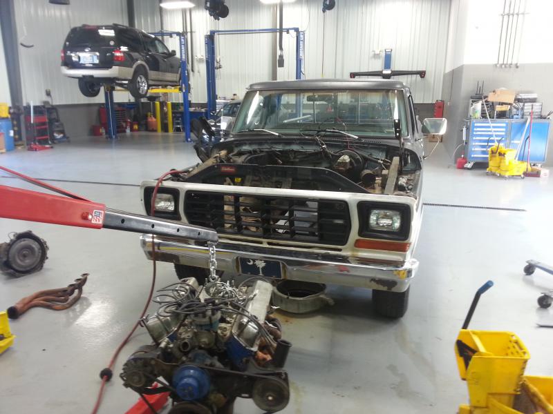

Well went and rescued the truck from my dads yard where it's been sitting for about 2 years, somehow a spark plug broke off into the cylinder as he was driving. His makeshift mechanic friend tore it down to the block and told him he didnt know what was wrong with it, he finally told me 100 bucks come get it, went up to nc and towed it down here, got a free motor from a buddies junker that had aboit 375, 000 on the clock, dropped that in and fired her up and so much smoke coming out the valve cover recirc to throttlebody, has to be rings or seals, this is my third vehicle and first project so pretty much full custom resto is gonna happen. Thought about a 5.0 or 318 swap but I have enough toys I want a little rc truck to cruise around in. I'm only 22 and I've been a mechanic for about 3 years now wanna build my first ride. And figured this should be a simple little project sohc fi 4 cylinder with manual trans and base everything, should be about as simple as I can get.
Started tear down today and here she is.

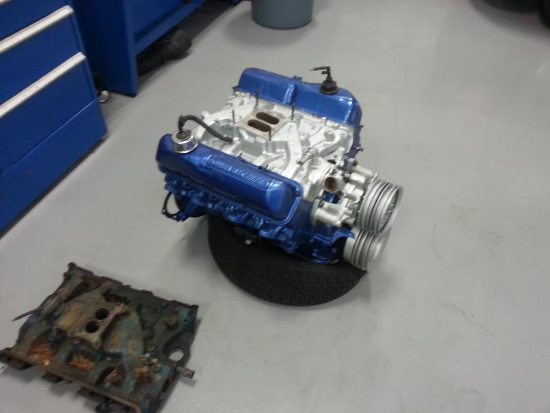

Attachment 7027Attachment 7028Attachment 7027Attachment 7028Updates buddy swapped his rebuilt 5.0 for a 390 in his 79 f100 so picked up his 302 and c4 for 200 bucks for helping him swap, fordubishi could I possibly get a pic of your crossmember set up?

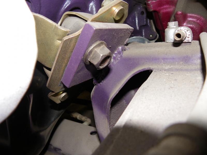

Sure I can get a pic tomorrow, it was super easy to make. 3" x 1/2" flat bar with some holes in it. then a small step to mount the tranny mount into it.
engine mounts were made from pieces of the same flat bar welded to the factory front x-member.

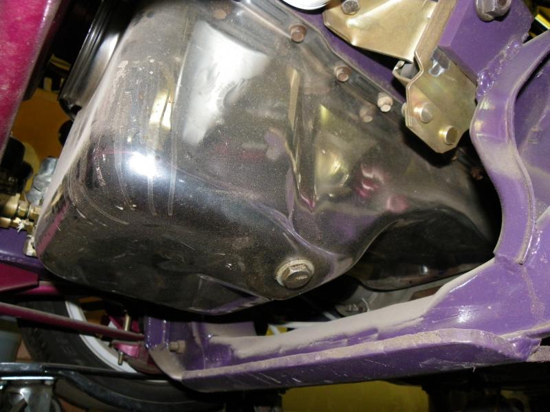

and I used a front sump oil pan

Are those the stock mounts on the 302 and just welded the flat bar for placement?
Yep stock energy suspension Mustang replacements on the welded flat bar. I'll have the pic of the Tranny x-member for you today.

Top shot of the passenger side engine mount.
Attachment 7043
Drivers side mount.

Very nice pick up from your friend on that engine. You must have a good friend there and that is the way to do it for sure. You know the history of the engine now and you'll also have some mechanical information from him as well if you have any issues with it later on. Keep posting your progress, we are watching.

Yea thats my brother from another mother, best man at my wedding work right beside him all day good dude, helped him pull that motor out of his grampa's truck about a year ago, he had to go bigger for his boat he has a 22ft center console about 5000lbs dry plus trailer fuel and our beer when we go that 302 was having to work, 390 will be alot better
