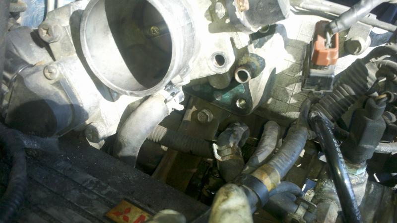

Throttle Body Thread Resurrection
Attachment 6974
BEFORE
Attachment 6975
AFTER
So after digging this up from the archives, I decided to try it. I wanted to keep function as close to OE as possible, and gratefully there was enough hose to just bypass the throttle body with no other mod needed. I only had to disconnect the intake manifold support and run the hose under it. Then I topped off the coolant and took a test drive. Haven't adjusted timing or anything, but so far so good - started, ran, and Temp Needle was on point. That's a good start, and we'll go from there.
