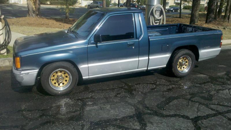

1994 MM 2.4 EFI - Tow Truck for the Race Car
Attachment 289Attachment 290

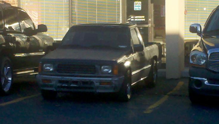

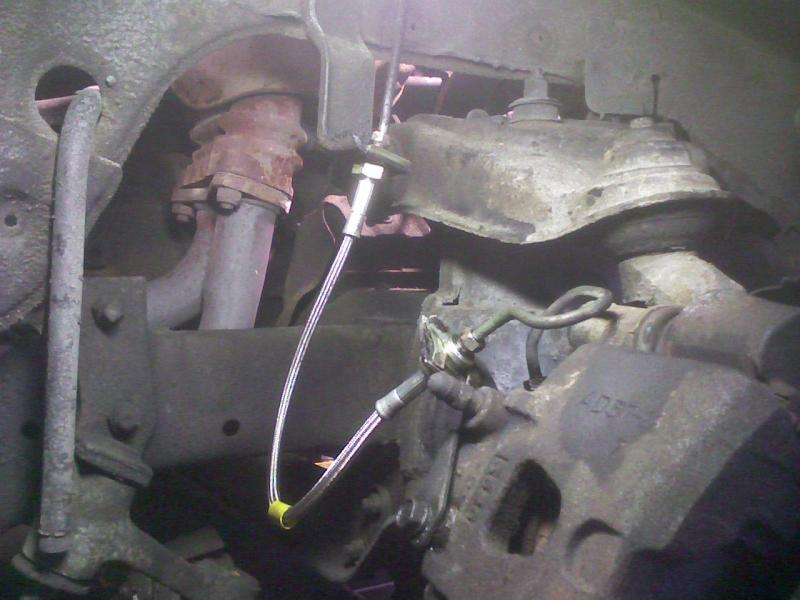

Still fairly early stages and spaced out based on my work schedule, but piece by piece preparing Max for the summer and his role as "The Guardian" for Blue. Blue is my 1990 Plymouth Laser RS-T who I'm preparing for the road course with a goal of 350-400 WHP. You may hear more about her or see some of her pics too as this build progresses. I'm building them to work together.

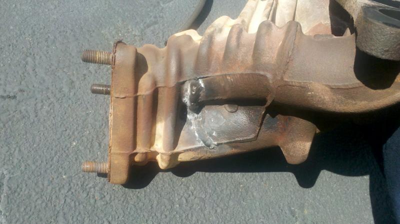

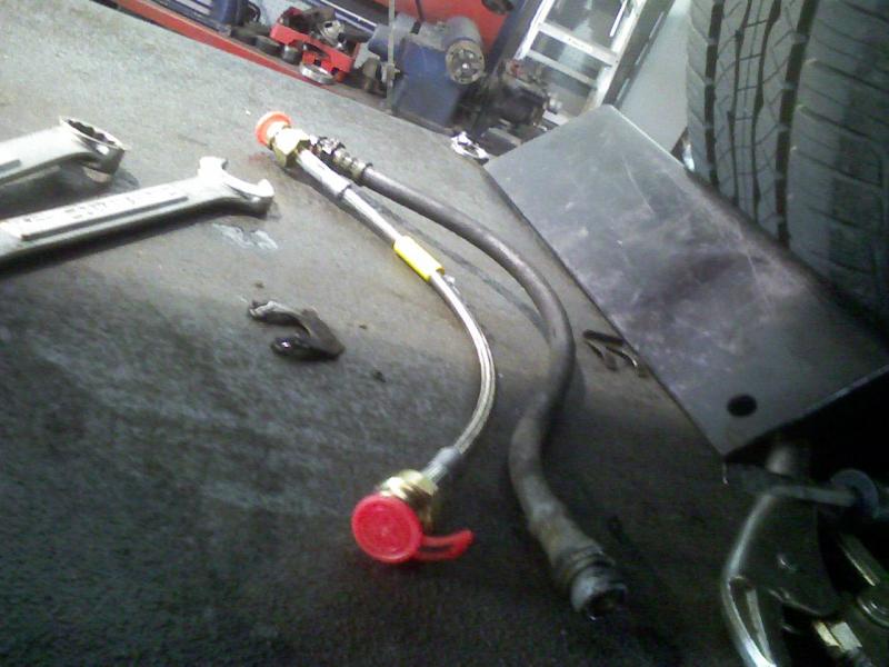

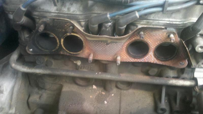

Anyway, I've mainly been trying to make it as solid an OE platform as possible before i start getting too heavy into mods. I repaired a broken crank pulley for the balance shaft belt, got new bearings and seals for the transmission and replaced a broken clutch cable, had a crack in my cast iron exhaust manifold brazed shut, bought a full size wheel for the spare tire, got SS Braided Brake Hoses, got a K&N OE, and did maintenance (Alignment, Oil Change, Tune Up, Tire Rotation, etc.)
Probably the first "show and shine" upgrade I made was getting my tint done.
The brake line pics are the only ones I can load from my phone at the moment
Ill post more soon. Thanks for checking out my project!
Finn

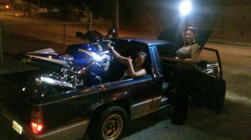

Look at Max doing work! Friend's cousin had unexpected electrical issue with his bike. Sucks because we were on our way to a proper strip club... :(
Gratefully his swing arm wasn't stretched! Carried all four of us and his GSX-R 750 to his alternate transpo and the night continued. Good Times!
Don't let people sleep on our trucks... they go HARD. :thumbup: Max to the rescue!

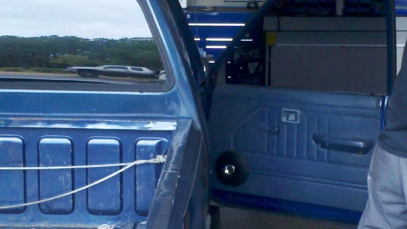

'90 Laser RS-T... found in the backyard of the auto shop of a family friend. Needed some basic repair to pass state inspection, but a steal as car, parts and labor only cost about $1K. Very slow but steady buildup of key points to make car fast and fun but still reliable, legal and safe. Homeboy doing me a favor putting the transmission in with upgraded axles. DEF looking forward to feeling the difference with the new tranny and LSD :thumbup: As far as the truck's body work, there's a good bit of work to be done, so I'm just glad it's not rusting out. That way as long as the motor's strong, I can let the body work wait. Did get a chance to get the suspension on, pics in another post coming soon...

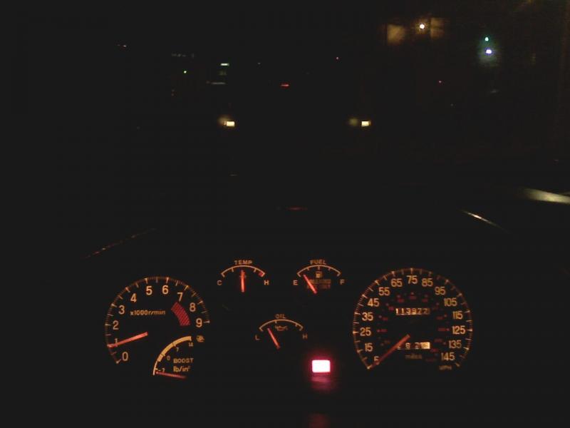

Finally! The Tach Cluster...#Nice

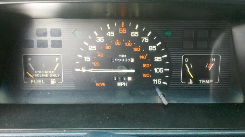

Gratefully, I was finally able to find a tach cluster salvage for a reasonable price. I installed it in the parking lot of the yard, to make sure it worked, (because I had to drive about an hour to get it), and it popped right in - good to go! :cheers: I had to use scotch brite to get some of the rust off of the metal connector that was sticking out, but other that that, it was easy. Reading the instructions that talked about re-routing the speedo cable, it took me a sec to realize the best way to do that.
When I first moved the cable, I tried to put it UNDER the metal bracket. That made the cable too short. There was a round hole going THROUGH the metal bracket that made the cable just the right length and angle.
The sender (for the gauge) that I got from Advance looked HUGE by comparison to the online pics, but it threaded in and works fine.
My truck got 15K mi younger with the install (LOL) so I have to find out how to roll the ODO forward so it will match, and we'll be solid. Anybody have any tips?
I'm grateful for the progress. I've got to re-check the timing and reset the idle speed and go from there.
I'm not exactly sure what I'm going to do next, but I'll definitely keep you posted.
Thanks for checking me out.
Stay "Tuned"! :thumbup:

2 Attachment(s)
Narrowly Avoided Tach Gauge Disaster... #closeone
Ok, so first I tried to use the "drill in the speedo plug" method... clearly it would have taken a thousand years to add the number of miles I needed my ODO to show... Because I didn't want my grandchildren to be the first people to enjoy the new gauges, I decided to take the gauges apart and fix things that way... #really?! :shakehead:
Long story short, I got to the point where I had taken both clusters apart to swap odos, I had taken the tach cluster odometer itself out and was trying to turn the numbers to match what I needed. I felt like I was in an Indiana Jones movie or I was trying to decipher an ancient stone mason's key...:bang: It was like a Rubix Cube gone bad...
What's more, when I finally figured out how to set the numbers, and I got the odometer numbers back in the odometer housing, I missed one detail that made the numbers point down a little in the bezel, and I almost lost the "baby-small" retainer clip that holds the numbers in the housing. Gratefully my friend was here and eventually found it. (I was already going to the truck to try to swap the odo from the original cluster.) Seeing the old odo showed me how to align the new one though, had to take to small clip off again, but i learned from my mistakes and kept it close this time. (*note* friends don't let friends take apart small things on carpet)
When I put everything back together this time, the numbers lined up, everything was properly adjusted and we were finally good to go. I put the gauges back in the truck, and when I was able to test drive, the numbers roll over as the should. (*I'm glad they didn't roll backwards, or have bigger numbers roll before smaller numbers) :lmao:
So, now the gauges are in and the numbers are true and I can put this chapter of the build to rest...#whew!:clap:
I'm not sure what will be my next mod, but I'll definitely keep you posted.
Stay "tuned"! :thumbup:

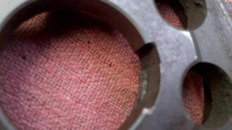

Ok, back to the build. We talked about the oil pan for the Laser. Never did find a reasonably priced aluminum replacement, so I had to sniff out a tried and true OE. Gratefully there was an AWD Talon with just what I needed. (hated to see an AWD like that, like it was an awesome horse left for dead in the open plain to get picked apart by vultures...) Well, it is what it is, so I had to be the vulture this time. Pan had a nice pickup baffle already in (not sure if the OE Laser pan had that too - long time since it's been off), but that will help when I'm on the road course. I've decided to campaign the RS-T in NASA Pro Racing's "Performance Touring" Class -(final mods determine who you actually run against on track, as long as there within that base class). But a stock '90 RS-T is classed PTE.
It was a milkshake that brought this Talon to the yard... Water/Oil mix in the pan when I pulled the plug. Good sign that it still held fluid. I pulled the pan, and the bolts, and kept the cut oil return line. All threads good, plug good, even filled it with water and let it sit for a while to ensure no cracks before I bought. #allgood :thumbup:
So hopefully, that will put the day the Laser is on the road, that much closer. Thanks for "tuning" in! :cheers:
