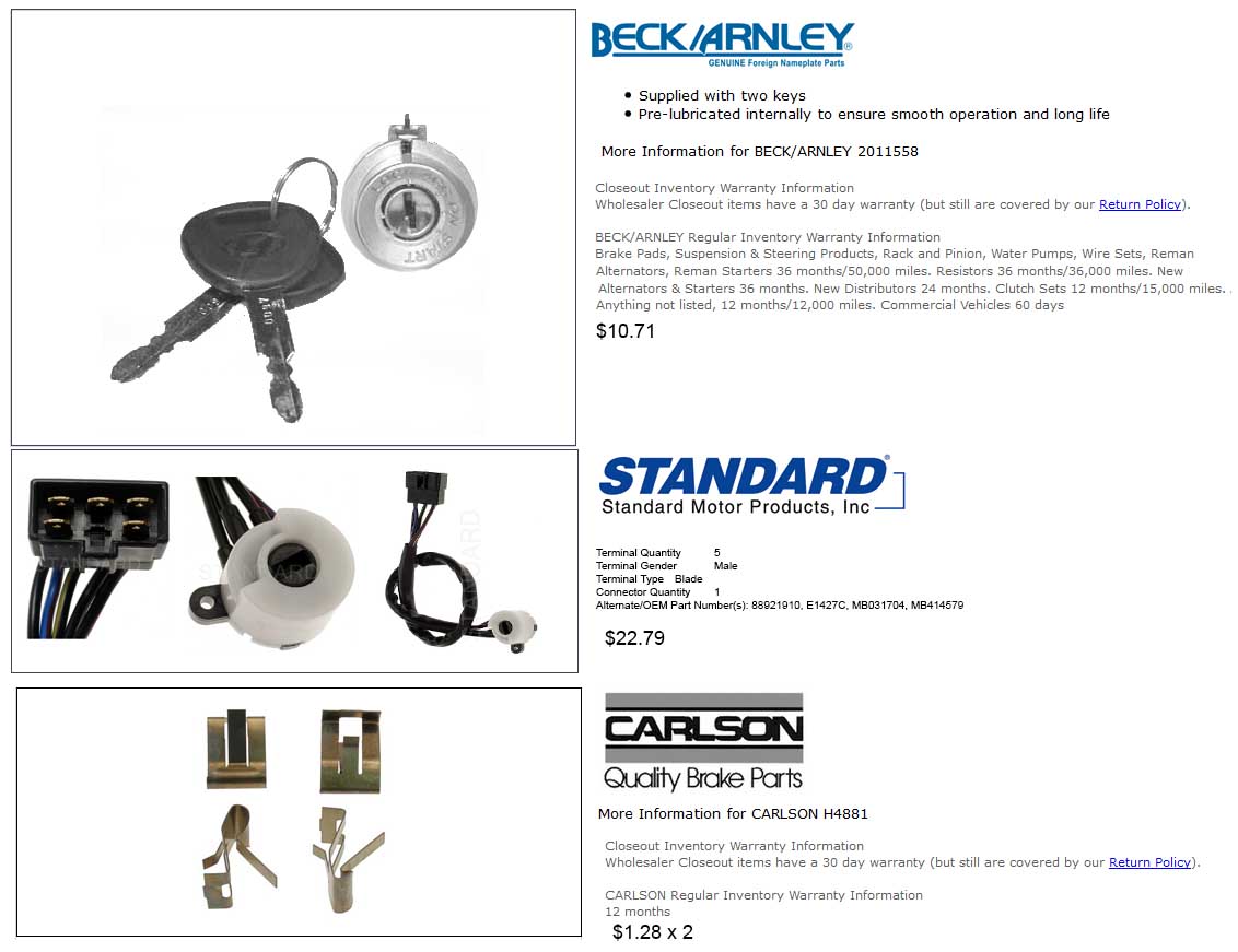

Just placed an order at RockAuto.com
The prices were great and they had what I needed.
Attachment 16463
I am replacing the ignition system key switch and the electrical switch since the keys are able to come out while the truck is running.
I also am doing front brakes. Turning rotors and replacing pads and clips.

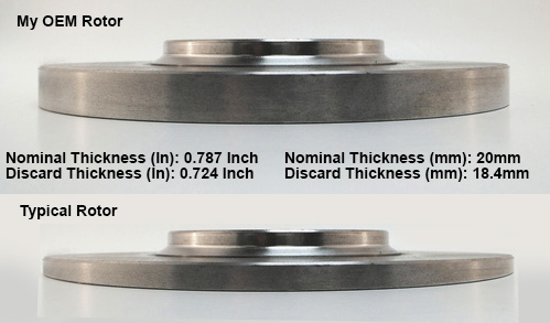

I really don't think I will have an issue with the brakes being turned, it's normal procedure. The pulsating just started and it was so subtle you could hardly feel it. The reason I had it done was because I am taking truck on a long drive. It allowed me to grease all the zerks and the bearings, wire brush the collected road dirt off suspension parts, inspect and check for any bad ball joints or tie-rod ends.
I know there are no cracks in the rotors, after 28+years they just needed a minor amount removed on resurfacing for a good contact with brake pads. I have never heard of a rotor cracking as well. These rotors are thick and doubt very much they would crack.
We have extreme weather here and they would crack under the heat or cold before just applying the brakes. I also have always taken care of this truck and don't abuse these types of items. My first set of tires I installed lasted over 80K miles, which is 128747.52 Kilometers.
The brakes also have air ducting built into the shield. There was no sign at all of an over heated rotor, grease was still in great shaped, not cooked, and the bearings were definitely not worth replacing because of their condition.
I also feel that the rotors would of remained fine except for the backing plate that I mentioned that sits between the pad and the caliper. It somehow worked loose from the plunger side pad only and shifted to one side. This most likely allowed the pad to wobble ever so slightly and created the irregular surface.
I have full faith in the truck and the shop that turned them. He specified the limit that he could remove from the rotor and I really don't think 2 mm or 1mm from each side will effect the rotor to a point of disintegration.
Attachment 16478
I've encountered plenty of cracked rotors on solid and vented discs as a result of being overheated (o.k. not on a MM/D50 specifically). In fact I've only recently replaced the rotors on my Lantra Sportswagon that were both cracked and warped (it had been used by the PO to tow a caravan - just stupid...) On any vehicle I've owned that has had a brake issue I've tried to source a direct bolt-on upgrade to avoid the problem coming back to haunt me.

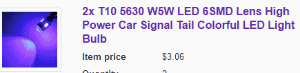

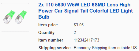

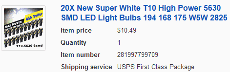

I have located some very good LED lights for our trucks and wanted to share them with everyone. I have replace the entire dash lighting on my Toyota MR2 and was so happy with the performance, color, brightness and also allowed the dimmer to work, that I installed them in my truck too. I ordered the turn signal/flasher lights in green, the bright light indicator light in blue and the rest in white light, in addition to assorted for HVAC display. The dimmer still works with these LED lights as well.
Here are the LED lights I purchased on Ebay
White Lights
Attachment 19416
Green Turn Signal Lights
Attachment 19417
Blue Bright Lights Light
Attachment 19418

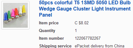

Assorted Variety for HVAC Control Area and Customizing Display - Small LED
Attachment 19419
Need to take a pic of the end result Brad. The factory lighting in Gen 1's is on par with a couple of tea candles - barely. Still haven't found the source of your noise yet Brad?
