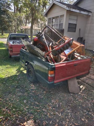

Puttin in some work. Loaded up and headed to scrap yard.Attachment 27127Attachment 27128

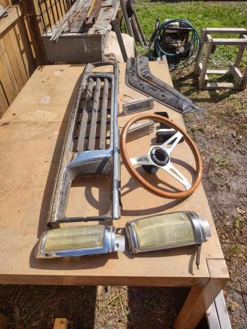

Junk yard score.
grille , clear turn signals & marker lamps , NRG steering wheel , dash clock and smoke vent visorsAttachment 27715
Been a while since you posted. Nice haul from the yard :thumbup:

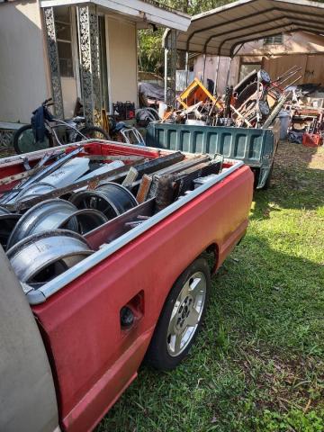

Wow it's really been a whole year. All I do is abuse this truck. Pretty much just goes to home depot , junkyard , or scrap yard. Sometimes the occasional furniture hauling.

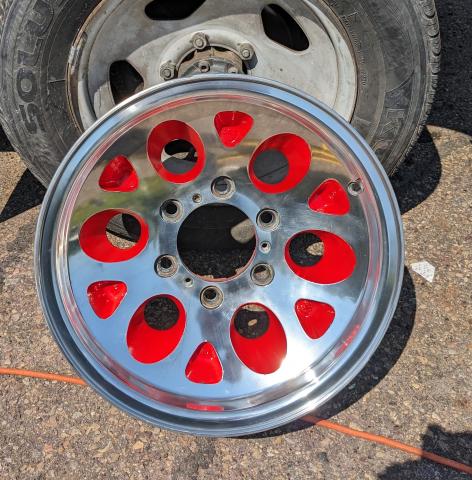

Finally got around to installing new tires that I bought last year. Wanted to clean up a spare set of rims first. It takes a long time to sand off all the clear coat and get down to the corrosion of the aluminum. Then sand sand sand....buff buff buff. They look much better. Not perfect. Your results may vary
I used aircraft remover to get the clearcoat off my rims. Then starting with 220 grit and working my way up to 1000-grit, after that came the polishing starting with black rouge, then white and then jewelers. I am no pro, and it took me 4 weekends. My back did not appreciate it.http://www.mightyram50.net/vbulletin...id=28261&stc=1
So now I have the matching pair of wheels on the bed trailer and two matching full size spares.
