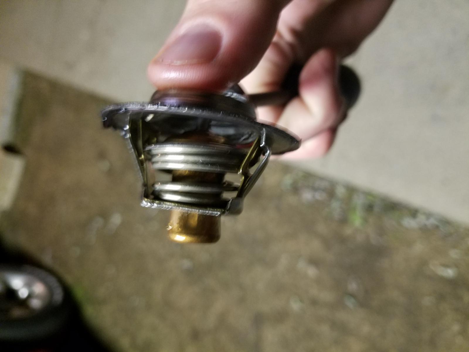

My over cooling issue was easy to fix. Attachment 21232
new vacuum advance units are only 20 or 30 bucks, and are easy to change out. Looks like a fail safe thermostat. Must have gotten warm enough to jam it open.

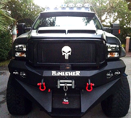

big beefy winch mount bumpers? :grin: I like where you're taking this truck

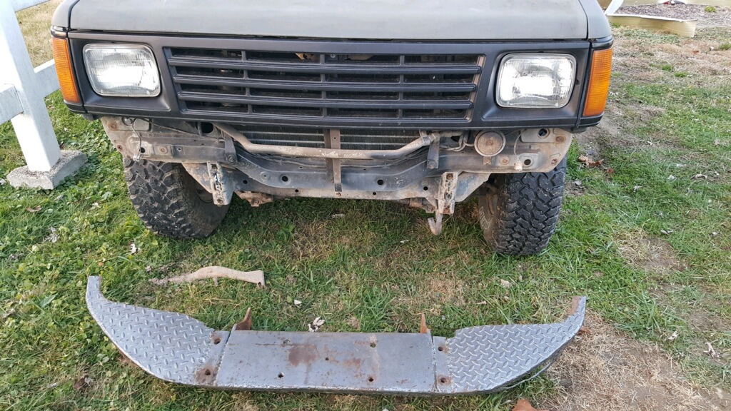

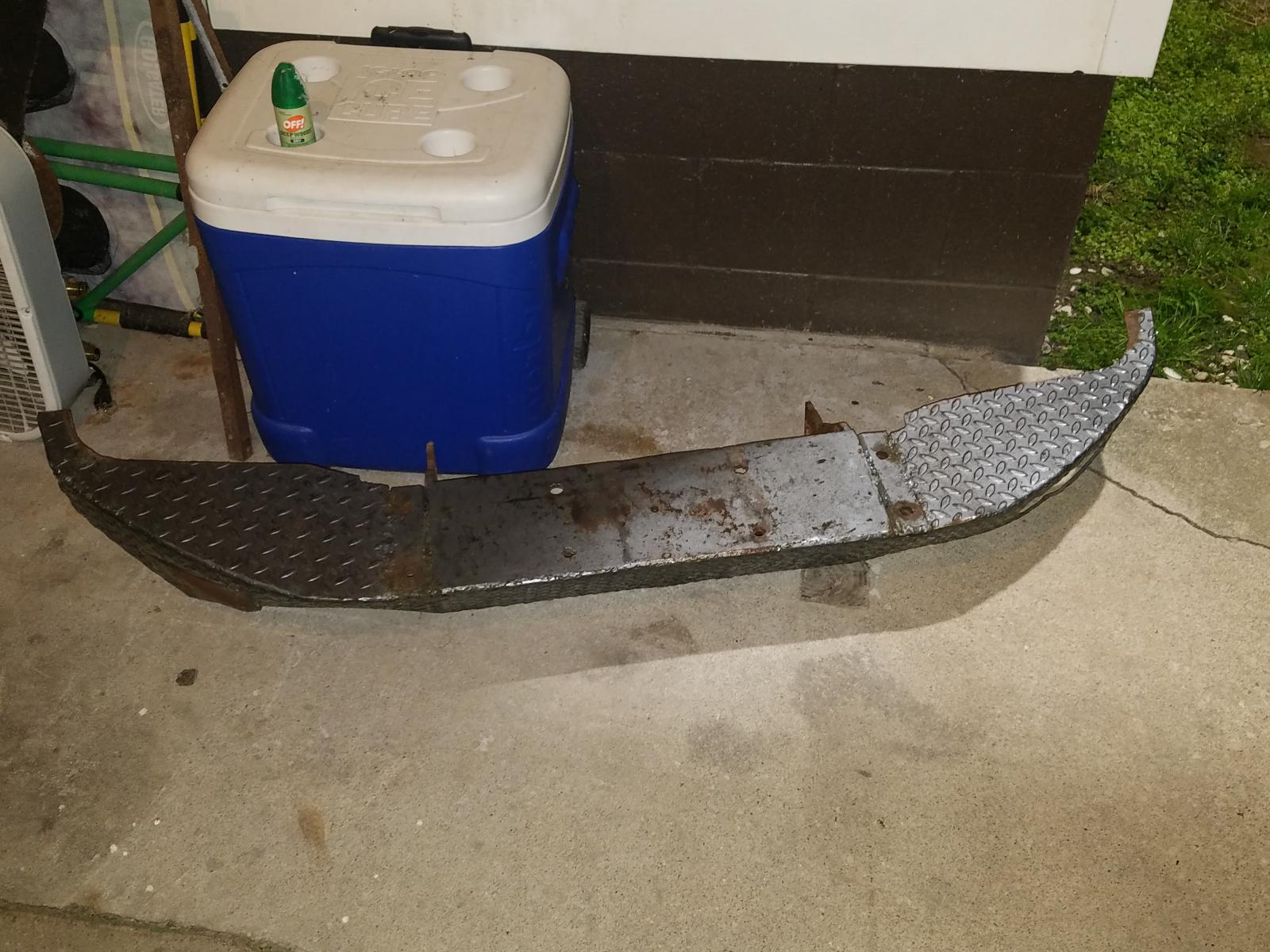

Found a bumper that I'm gonna try and transplant on the MM.
Attachment 21291
Attachment 21294
Woah that is a serious piece of metal. Anyone stupid enough to brake check you with that thing bolted up is in for a bad day.
I can't wait to get it on. I'm gonna add a stinger and shackle mounts to it.
Nice, skid plate too?
Nice bumper for sure. Nothing like showing that one in a rear view mirror. lol

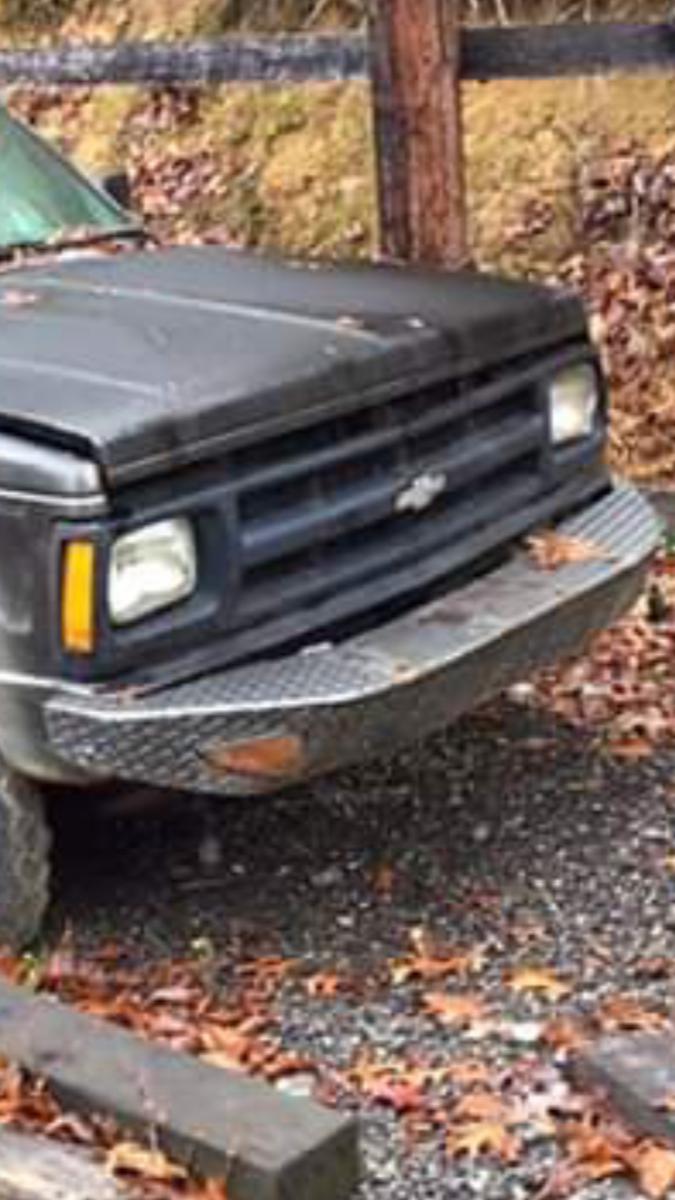

Attachment 21298
too bad that hangs down so low - negates the lift on the truck...
Well I'm gonna have to build some brackets to make it fit the frame rails. It's about 5 inches wider than an s-10.
