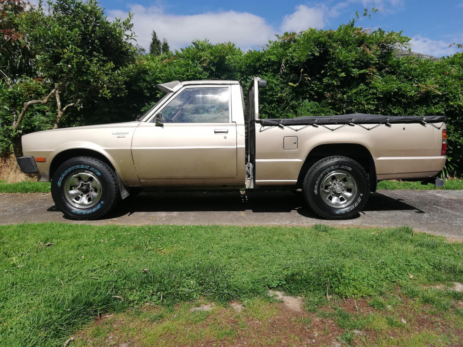

Got a flat today, same corner as earlier this year. Then found my jack was missing.
Bugger
Borrowed a very dodgy euro one and drove onwards an hour to the closest welder repair shop. (Should just buy the one on special for $350, what a drag) and went right to the auto store and bought a bottle jack to live permanently under the seat.
How's that?
Might have to wash the truck now....
It's not cheap being an 80s guy I'll tell ya. But I couldn't have a Chinese white lettering tyre.
