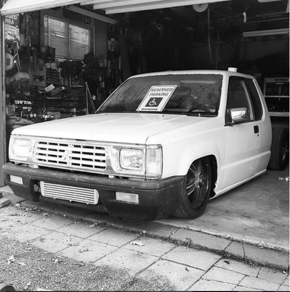

Niceeeeee! I was wondering if you were still working on your truck. Looks like the valve covers need some TLC? Looking good lowered!
Gawd your garage looks like mine, Border line hoarder and border line...Save that I might need it, lol.
Thanks Brad, and yeah the valve cover will be getting replaced with another one once it gets some work done to it and I powdercoat it.
And yeah that's my dad's garage, it has tons of tools from when my GPA worked at the naval yard, and a bunch of other crap they like to hoard and not throw away. You should have seen it a year or two ago lol, before I cleaned it to be able to put my truck in there.

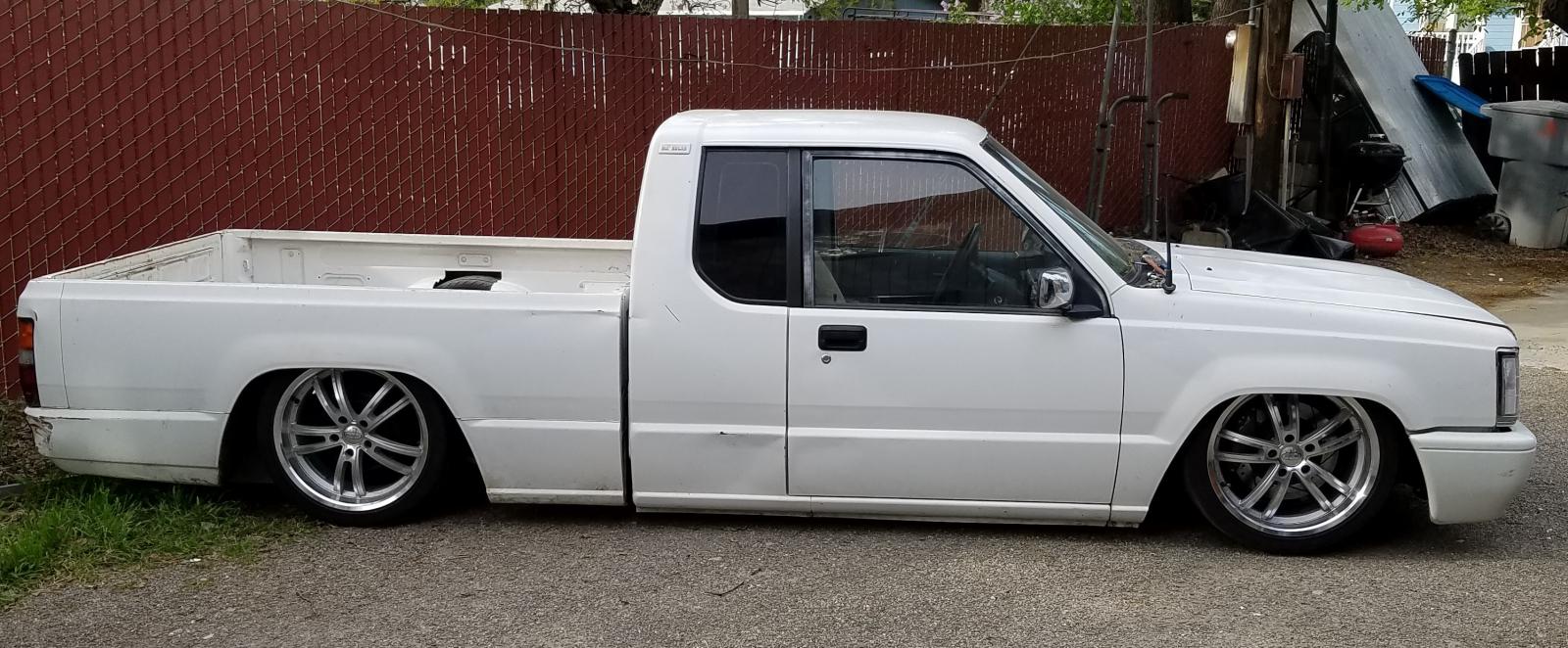

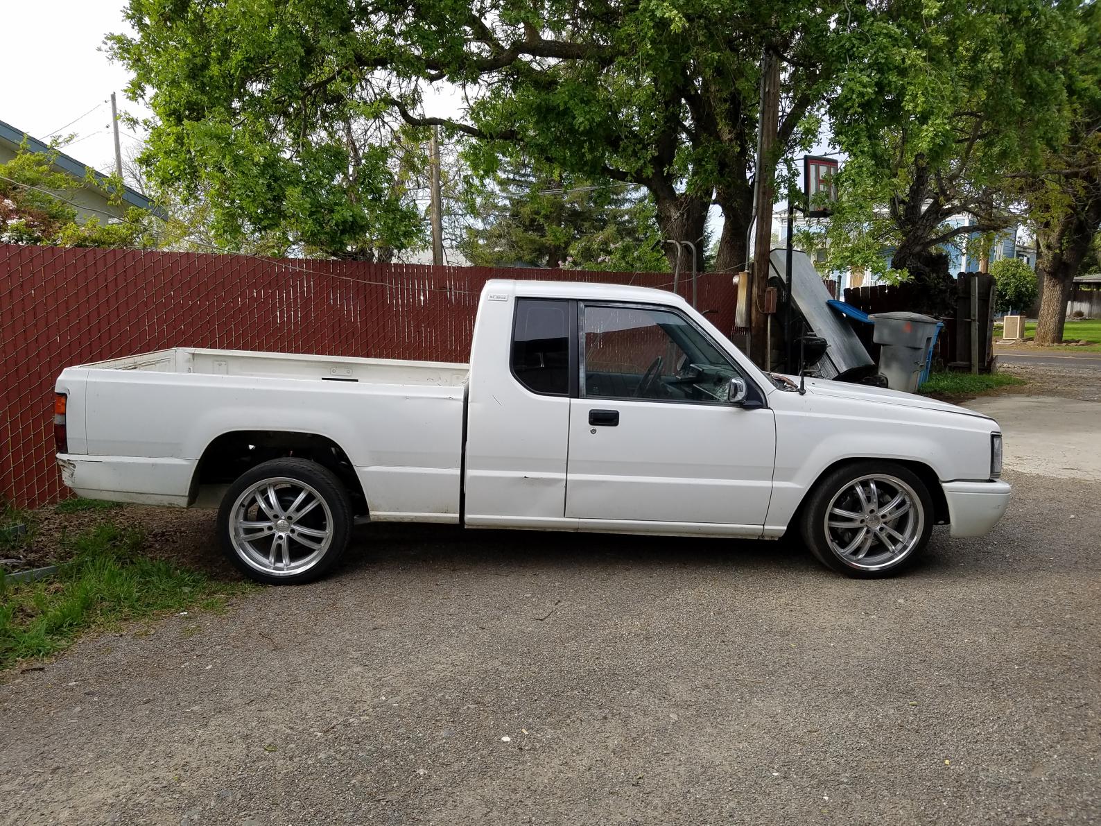

Ok so some pics and updates. Got the bed cut out as much as it needs to be to lay frame, its just rough cut, I still need to finish grind everywhere I cut.

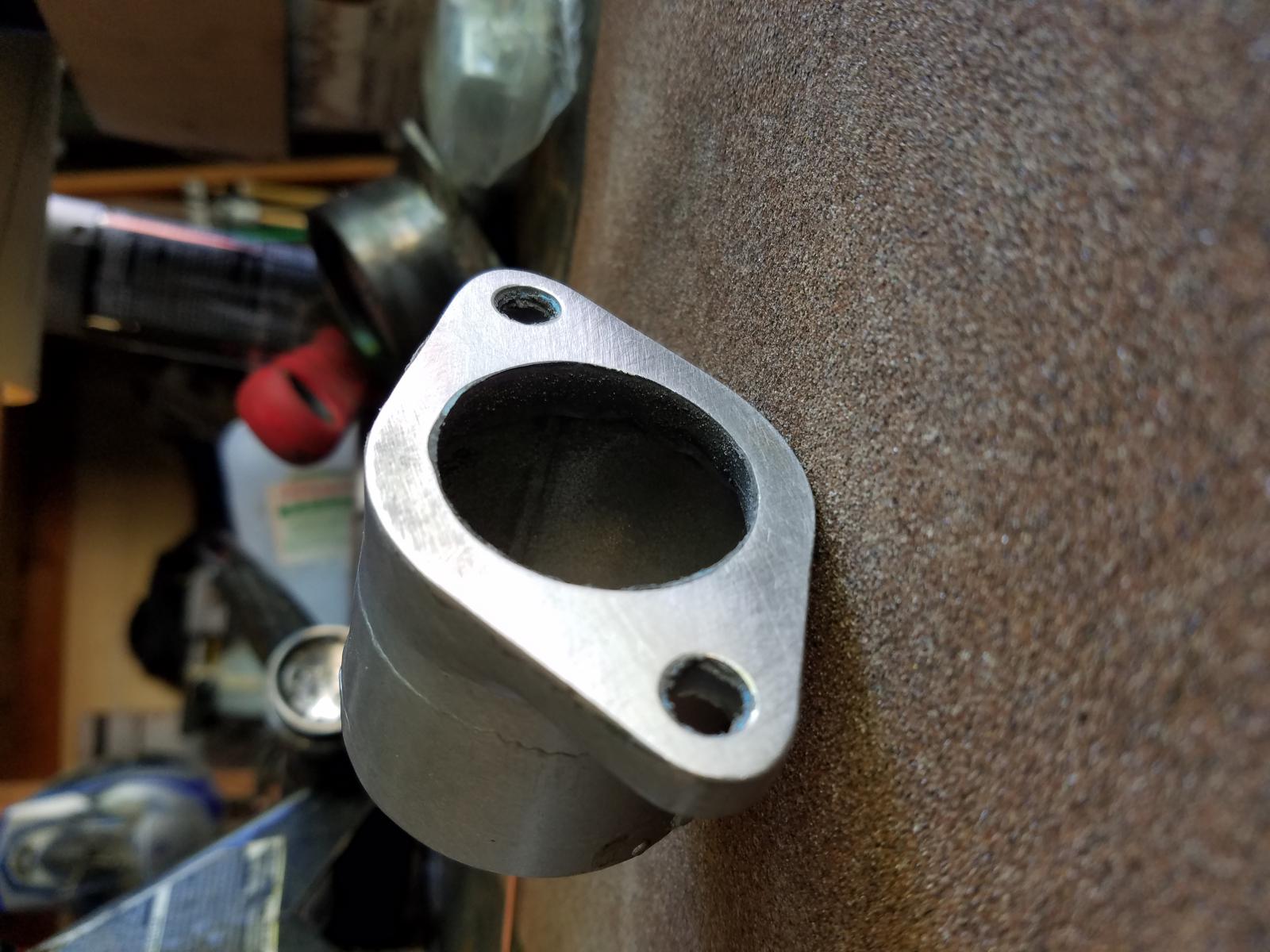

Here's the flange coming off my turbo to connect to my intercooler piping, it was a little warped so it was giving me a pretty big boost leak.So a lot of sanding later(stainless steel) on a flat surface and I got it flat. Here's a pic where you can see the low spots on the left and right(guess not the upload killed the quality).

Full lift in back, front could go up another inch or so. Donk
Attachment 16380
And laying frame
Attachment 16384
