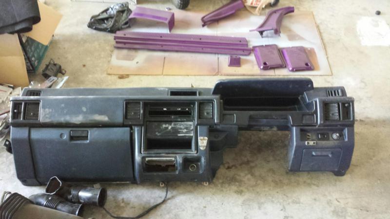

use a pressure washer with some strong detergent to spray off the rest of that acid. It probably got between the hood frame and the metal above when it slung off the pulley. Or take the hood off, flip it over and pour a baking soda mix on it and let it sit for an hour or so, then hose it off.

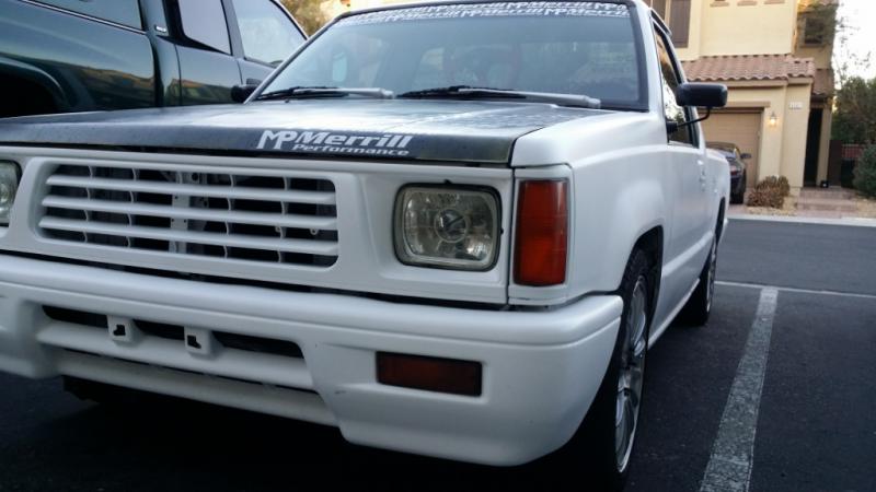

Two things happened today.
The first thing is my truck finally got a good wash since the crack head painted it. I've been to a few washes since, but since the paint job is terrible, the dirt never came off until today. The secret is a Scotch Brite with some soap and water. The great news is the dirt comes right off, my paint is flat and doesn't show Scotch Brite scratches, and the truck looks good as new (maybe better/smoother). The bad news is it takes damn near 3 friggin hours to scrub the exterior down to clean it. It's whatever anyway.... It looks decent again.

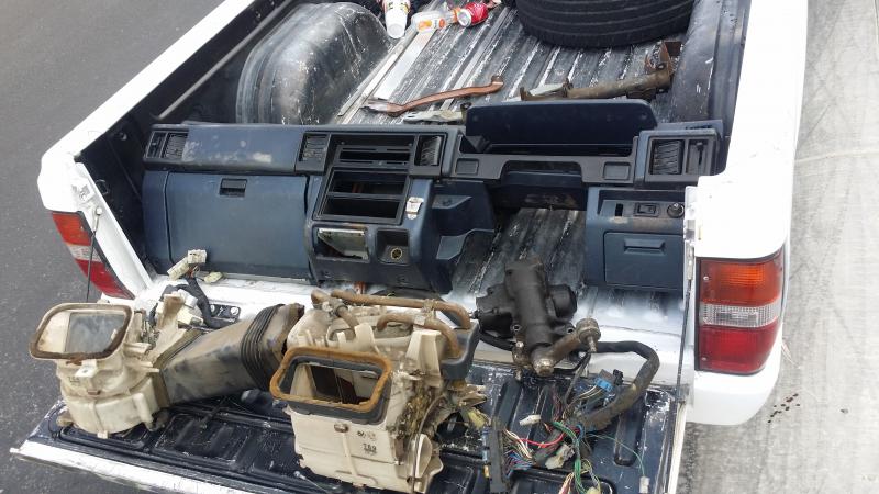

The second thing to happen today is:
Attachment 11686
Look carefully at the pic.... This build just got serious :secret:
and the best part of this conversion - it is all factory parts from Asia...
Either you've flipped the dash photograph...which is a cruel thing to do to a dyslexic...or you're preparing to put the steering wheel on the right-hand side, thus tempting geezer101 to steal your truck. That's 'entrapment', you know.
Truck looks terrific regardless :)
but if he takes the truck back with him, won't it revert to LHD? LOL
That is a real RHD dash from a postal truck. Everything I need to swap is there (just not in the pic). I've been contemplating RHD swapping since I started this build. I was talking to a few people over seas about gathering what I need and shipping here. I just didn't want to spend all that much. All this was less than 200 bucks, so I couldn't resist. A very good friend of mine found it and snatched it up for me. All I need to do is go pick it up and swap it.
I'm swamped with clients projects and vehicles right now, but eventually I'll find the time to get this done. Shouldn't be too difficult to get done once I start on it (average time is a week for me on RHD swaps for me).

Here is a little more RHD love....
Attachment 11852
Just to make this easier for those planning to swap (or just following for info), all you need is the dash with all components (frame work, ducts, brackets, etc.), RHD blower motor, RHD cooling unit (for AC if you have it) or AC cooling unit bypass (shown in pic), RHD heater unit, RHD steering gear unit (steering box), and the RHD harness.
The HVAC cluster is also mirrored. However, I have crawled it over and even verified there is nothing stopping you from using the LHD HVAC cluster and cables. The LHD bezel (piece with the vents and radio) fits in the RHD dash as well as the HVAC cluster and vice versa. You don't need the RHD HVAC cluster per se, but it is cool to have. Most people would probably never notice the difference.
One other thing you will need is a RHD shifter for all you 5 speed people. Yes - the shifter. If you notice on your LHD truck, the shifter angles toward you, the driver on the left. Take a moment and jump over to the passenger (right) side and reach for the shifter.... Notice how far away it seems? You can either buy a RHD shifter for your swap, or modify yours to angle the other way.
If you look at your factory firewall you will see a "mirrored impression" which has all the same features and stamping as the other side. That basically means if you draw a vertical line down the center of the firewall, you will notice that the right side has stamping and impressions for all the components the same as the left side. RHD and LHD are a little different when it comes to the clutch cable, but the impression in the sheet metal is still there. It is to the left of the brake booster. This will require a RHD clutch pedal if you want to keep it factory. Virtually every component can be swapped over to the other side using the existing firewall.
Simply speaking, all you need to do is cut one section from the left, and transplant it to the right. If you do not have a welder, you will have a harder time. However, don't let that discourage you. You can simply cut new holes and use new hardware while cutting patch panels for the other side. Some clever brackets will have to be made if you do not have a welder, but if you are creative and ambitious, you can do it. This is an easy RHD swap compared to other vehicles. I will get more info and confirmation later when I perform this swap, but right now, that is what I have concluded. There will be some other snags, but its little stuff.
