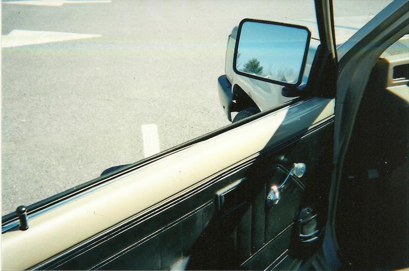

I like the top 2 inches of plastic naugahyde removed from the door panels, revealing the painted metal. But there are clamps on a strip of metal to stretch the plastic and attach to the top of the door. That strip has holes to fit in. I agonized about how to trim that out.
Attachment 8831
I had a couple ideas, and one was to use plastic chrome stripping with self-adhesive backing. I didn't want to go that route, but finally got desparate to do SOMETHING. Turns out, it works okay. We'll see how summer heat affects the trim pieces. For now, the adhesive is holding good.
Attachment 8832

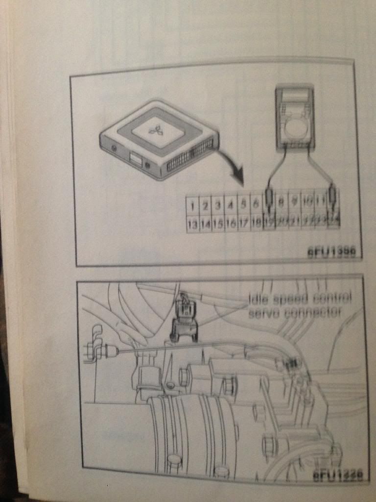

well? howd it go? want me to take better pics of those? id love to copy the thing so everybody could have access to the complete manual but the thing is big and that would take forever lol but yeah it seems its a big process to do a lot of things on this where as my neon is stupid simple and super reliable and gets amazing gas mileage which is why im swapping lol not to mention being a dodge guy i want my little dodge truck to have a dodge heart but thats more than a lot of people can handle by themselves
I got into it enough to have a feel for what to connect. I did get read-outs from the ECU but I still don't understand a lot of it. Also was able to get a read-out from the TPS but it was way off...not sure what to think. Anyway, what you helped me with got me this far, and I'll keep working with it, but it was getting dark and I had things to do. I also want to keep reading up on it so I have a better idea how to procede.
Am I to understand I have to take the ECU out? Or is there a connector coming off of that? It looks like I have to take it out, but then it will be disconnected. So I have to keep studying until it makes sense to me.
Someone recommended taking the ECU out, anyway, to check for leaks on the capacitors.
I need to get the engine up to operating temperature, and will allot some time to do that today, make the adjustments as I understand them, and go from there. Between what you've provided and my manual, I should be able to get good results.
