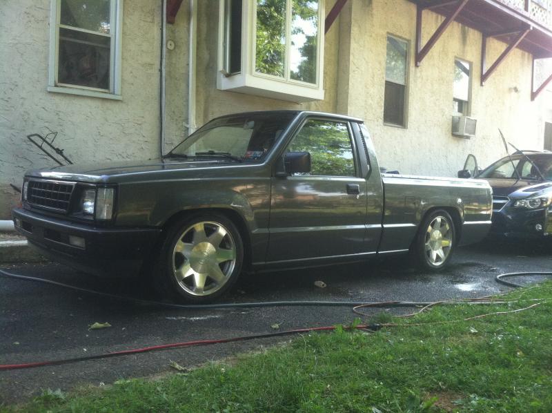

Got it cleaned up after sitting so long. It's still crooked so that's annoying but I'm working on it
Looks good though. So what are you gonna do to even it out? Start with some new front springs?

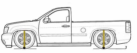

The first step in identifying the cause of a leaning vehicle, is to measure the extent of the problem. Tire pressure and size should be carefully checked before proceeding. Make sure all tires are the same size and the air pressure is equal, within one PSI.
A measurement can be taken with a tape measure to learn the amount the vehicle is leaning. The center of the wheel opening to the ground is a good reference.
Height can be measured in center of wheel opening
The height from the four wheel openings to the ground is measured and recorded. This should be carried out on a flat and level surface. Height variations from front to rear are normal on many vehicles. Height differences front to rear are often a part of styling and unless the appearance is unusual, are usually not a problem.

Side to side should not exceed half an inch or 13 MM
Differences in height, from side to side, should not exceed half an inch (13MM) and the less difference the better. If the vehicle leans more than half an inch in the front or rear, the problem is worth addressing.
