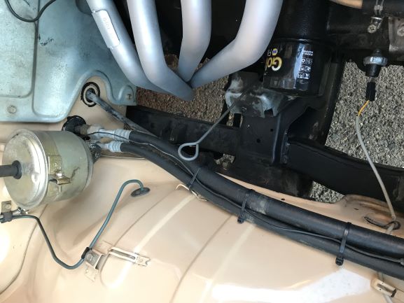

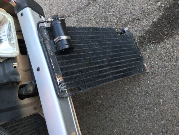

I mentioned installing A/C in this truck - nothing is easy
Hoses through the firewall
http://www.mightyram50.net/vbulletin...id=26763&stc=1

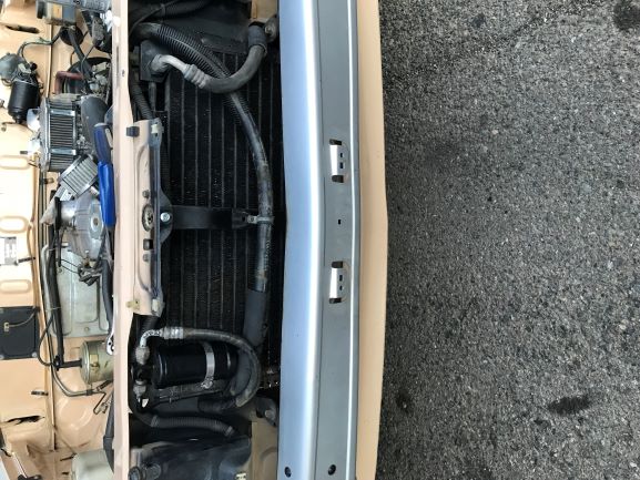

I had to cut all of the condenser mounts off and reposition the lowers to make this fit in front of the radiator. I also installed a new receiver/dryer
http://www.mightyram50.net/vbulletin...id=26764&stc=1
Everything installed
http://www.mightyram50.net/vbulletin...id=26765&stc=1
Now it doesn't look like an old skool hockey player with front teeth missing...
http://www.mightyram50.net/vbulletin...id=26766&stc=1

Now it's all back together it looks awesome :grin: What are you using for the A/C condenser fan? And I would use an electric thermofan instead of the pump driven clutch fan. The A/C does cause a restriction, but the mechanically driven fan was kinda crap from the get go. I think the electric radiator fan should fix the issue. And with the big, clunky clutch fan gone it will de-govern the engine and you'll gain throttle response.
Everything is a pain in LHD trucks. A/C hoses have to take a long route, the clutch and throttle cables are looping back at themselves, the brake booster and master cylinder are packed up against the intake... :rolleyes:

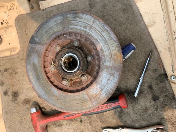

Update:
http://www.mightyram50.net/vbulletin...id=26771&stc=1

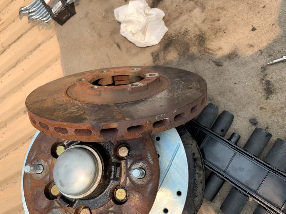

Old rotor from the 1994 MM that I pulled at the Upull yard
http://www.mightyram50.net/vbulletin...id=26772&stc=1

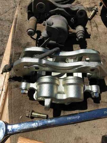

Comparison of original single piston caliper vs Montero dual piston caliper

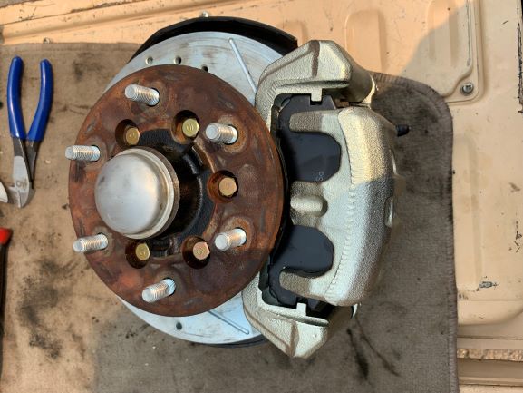

Complete assembly

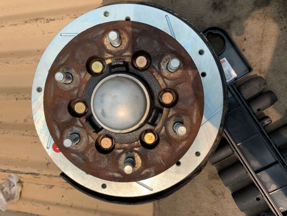

Old rotor

I started out buying the complete brake/spindle assembly from a 1994 MM.
Improved vented rotors and single piston caliper.
The spindles bolt right on to an early (my 1979) Dodge D50/Mighty Max.
Turns out that a Montero dual piston caliper also bolts to the '94 spindle - direct fit.
I had to trim the dust shield very slightly.
I bought a set of drilled/slotted/plated rotors on ebay, they also came with new ceramic pads.
I bought rebuilt calipers (also from eBay) for a 1997 Montero sport 2x4.
The only parts I am missing are the brackets and brake lines the connect the calipers too the chassis.

There was a lot of debate about front brake swaps on the Gen 1 trucks. I went out of my way to do a comparo in a JY to end the confusion. Awesome when everything is a nut and bolt swap - your new brakes will be a massive improvement and they look cool too. How much overhang are you getting from pad to rotor on the twin piston set up?
you get like 4mm from memory on mine
I'll check, but 4mm doesn't sound like a big deal...
It is surprising how well it fits, although the caliper is huge compared to the old unit.
4mm is acceptable. The factory Gen 1 brake assemblies are almost comical compared to the twin piston and vented rotor brakes.
^^^ Funny, all of the MM brake assemblies (2x4) are interchangeable if you use the entire units. Pop the upper/lower B joints, the tie rod and the brake hose, then bolt on to any MM first or second gen. Maybe even the later ones.
Even the calipers have the same mounting bracket bolt pattern.
*only Gen 1 and Gen 2. Gen 3 has a much taller steering hub assembly but the caliper 'will' fit (I tried messing with a caliper swap and the caliper touched the edge of the rotor - a tiny bit of grinding and it would work) Know you guys didn't get Gen 3's but in the event that someone stumbles on one...
