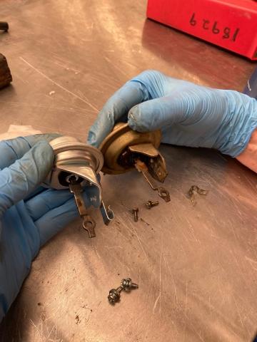

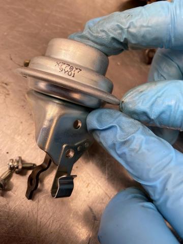

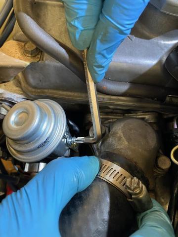

UPDATE: The truck currently starts & runs good, idle speed a little high by 100 RPM or so (but not always?) ~ got my laptop fixed & can upload photos now ~ used laser tach, timing light & hand vacuum pump to discover a new problem, the distributor vacuum advance diaphragm began leaking, did not advance the ignition timing ~ tested the mechanical advance, it works ok...
1) Replaced the dist vacuum advance actuator & tested vacuum advance, works good...

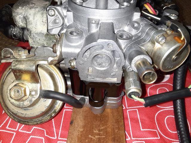

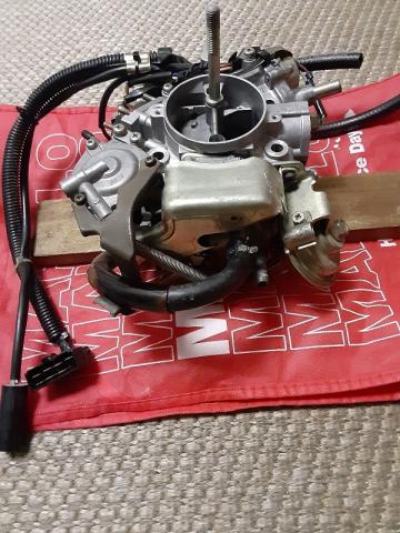

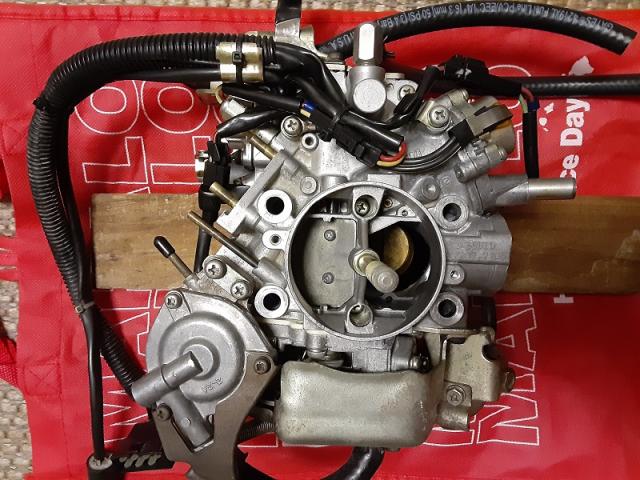

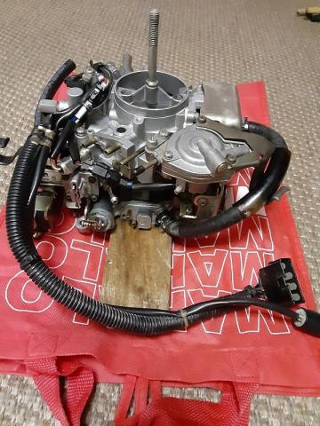

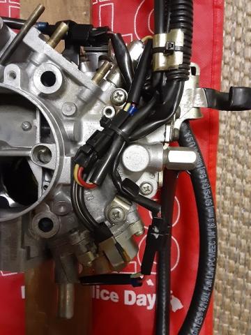

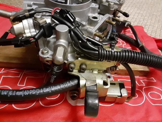

REBUILT MIKUNI PHOTOS
http://www.mightyram50.net/vbulletin...id=26046&stc=1http://www.mightyram50.net/vbulletin...id=26047&stc=1http://www.mightyram50.net/vbulletin...id=26048&stc=1http://www.mightyram50.net/vbulletin...id=26049&stc=1http://www.mightyram50.net/vbulletin...id=26050&stc=1http://www.mightyram50.net/vbulletin...id=26051&stc=1http://www.mightyram50.net/vbulletin...id=26052&stc=1
NOTICE ANYTHING MISSING ON THIS CARBURETOR PHOTO (?) LUCKILY FIXED IT BEFORE CONNECTING FUEL & COOLANT :^) COULD NOT GET THE AIR CLEANER TO FIT ON THE CARB & WHEN I WENT TO GET THE MISSING PLATE & GASKET, NOTICED I ALSO FORGOT TO INSTALL BOTH THROTTLE VENTURIES OMG..!
http://www.mightyram50.net/vbulletin...id=26054&stc=1

NEW VACUUM ADVANCE PHOTOS
http://www.mightyram50.net/vbulletin...id=25862&stc=1http://www.mightyram50.net/vbulletin...id=25863&stc=1http://www.mightyram50.net/vbulletin...id=25864&stc=1http://www.mightyram50.net/vbulletin...id=25865&stc=1

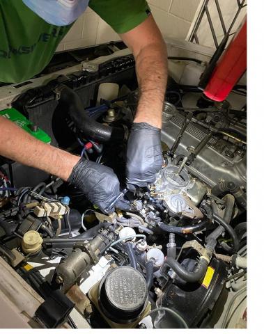

GETTING GROCERIES PHOTO
http://www.mightyram50.net/vbulletin...id=25866&stc=1
