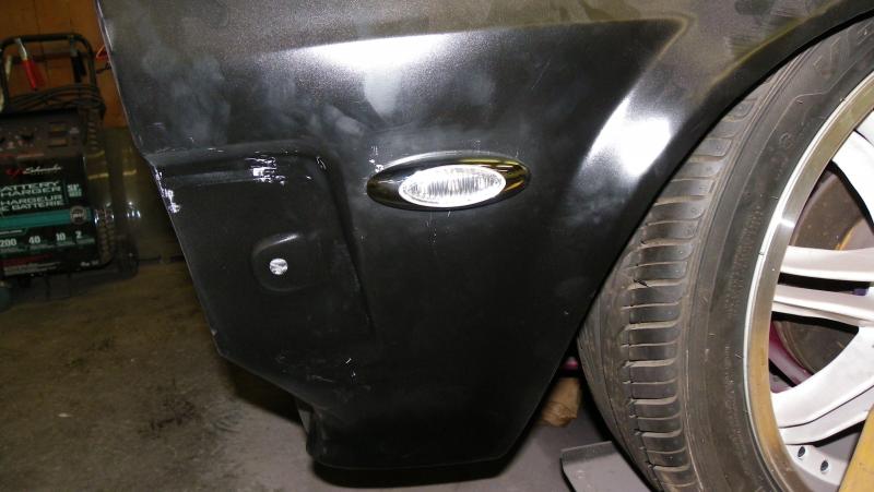

Found some nice clear LED marker lights and they even screw into the factory mounting holes.The bed holes are a little to big so I'll have to fill them when I do the body work on it.

Cough, part#, Cough, caugh...
LOL Camoit....... Grote part #47923 for the amber and #47922 for the red
GRRR! I like those better than mine! Damnit.....
Still don't like chrome, but that can be "fixed".
Mebbe some other time.
The chrome is just a trim ring so I might sand them down and paint them body color. I'll leave them chrome for now and see how it looks with the final paint on it.

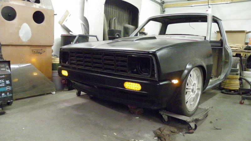

Quick pic of basically what it will look like when the front end is all back together with the lights on.
Attachment 3019
front sheet metal on and lights turned on.

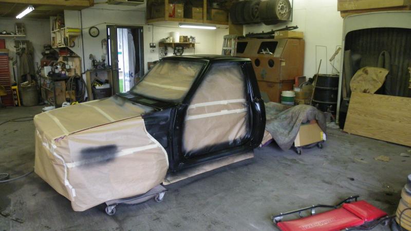

Spent the day masking the truck and putting the first coat of primer on.I will be doing another coat then sanding it all. After that it gets shot in E-coat and then painting the door jams and window openings in body color.Maybe by next week I will have the sheet metal all back on and bolted down.
Attachment 3036
Cab in first coat of primer
