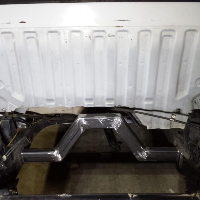

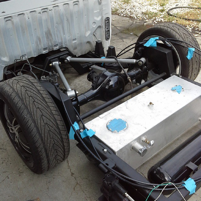

The tranny cross member i cut out the center hump section and cut a new piece out of 1/8 and welded it in. Ill be bolting it up like bobbyk? Did for the time being until i make a new crossmember.
Im making my bars using end links from custom connection and thorbros.
Also got the crossmember welded in tonight:
Attachment 12962

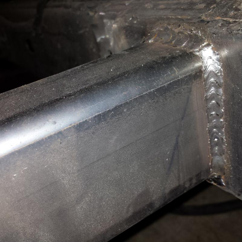

Weld shot, getting more consistent
Attachment 12963
