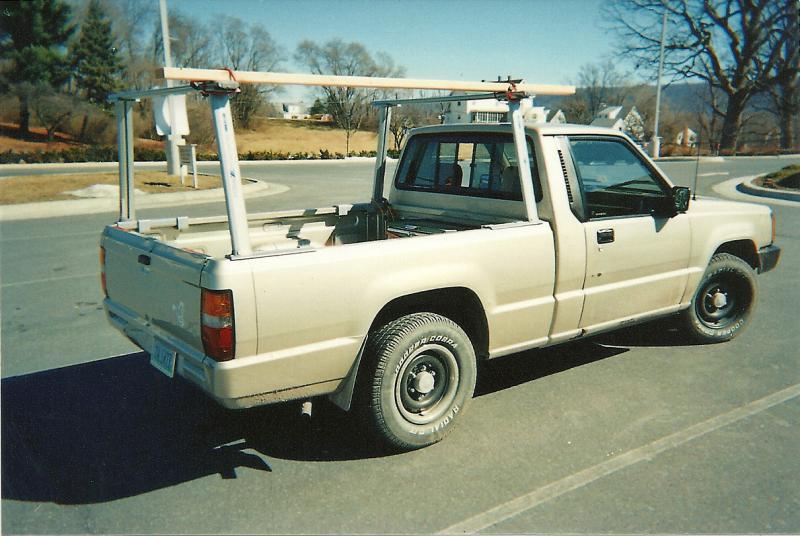

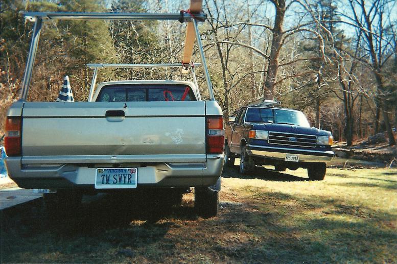

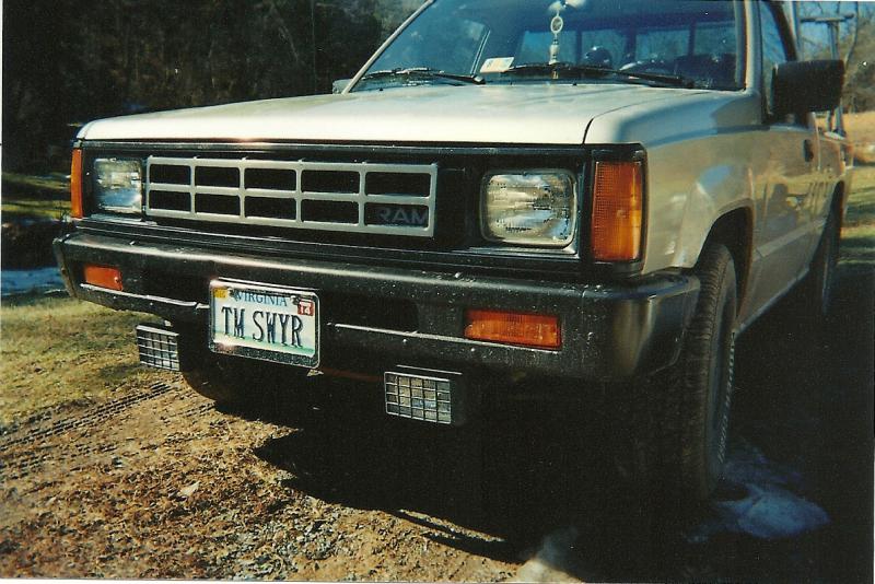

Pony, in service, with the ladder rack I found
Attachment 8235 Attachment 8236 Attachment 8237
rock on! good seeing it driving now

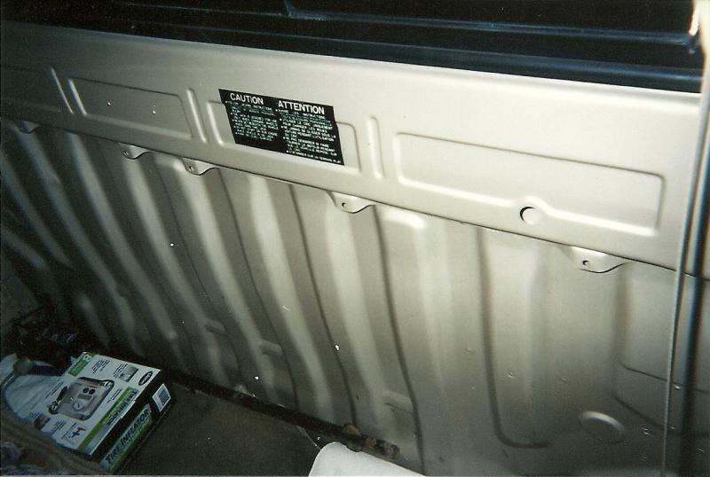

Now that it's mechanically sound (and my trust in it is back on track) I can focus on some cosmetic stuff, and doing something with behind the bench seat, for storage, so those pesky body parts aren't in the public view.

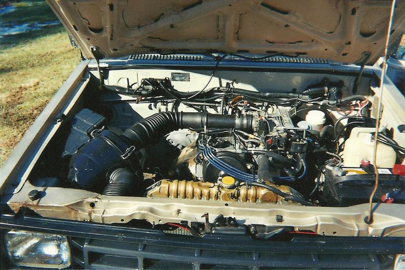

I can happily report that oil consumption is way down from what it was, just as thillskier reported in his valve-seal replacement thread. The valve seals are - no question - an important component of the engine to prevent oil consumption, but with two dropped valve guides (defeating two valve seals) the consumption was pretty alarming. Having corrected all that, I'm finding some oil consumption (the truck has 217,435 miles on it) but reasonable for the mileage. I'm guessing a half-quart every fill-up, which is a far cry better than a quart every 100 miles. Panrider reports a different oil-consumption problem with his 2.0, and it turned out to be jet valves. He solved the problem by capping off the jet valves.
There is still smoking at cold start-ups, but sitting for two or three hours, then starting, doesn't result in appreciable smoke. This leads me to think the intake seals (soft rubber) are not sealing as well as the plastic seals (on the exhaust). There is (sigh of relief) no smoke on down-hill decelleration.

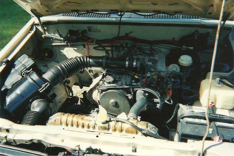

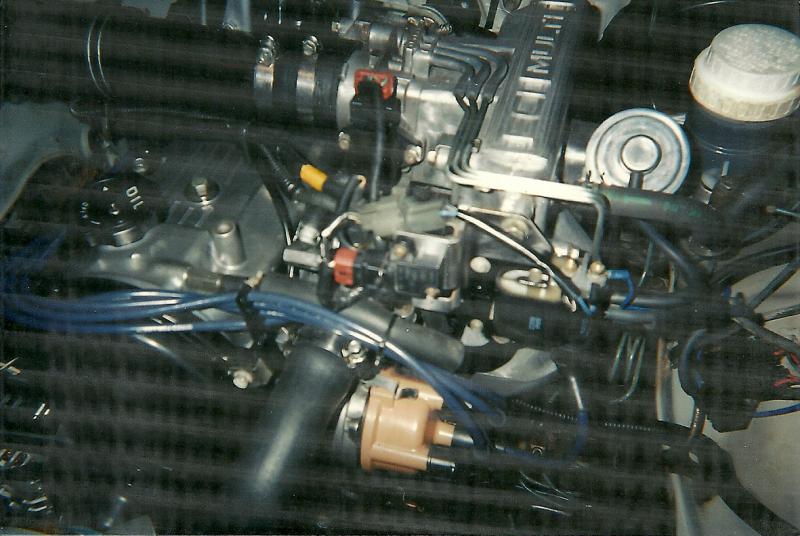

I've had good experiences with the disposable cameras, but every now and then, you get one that's just sort of odd. Below, my intention was to take pictures of the engine compartment for future points-of-referrence. This is how the film developed, as it did for the sunset pic I took at the top of the hill.
Attachment 8250 Attachment 8251

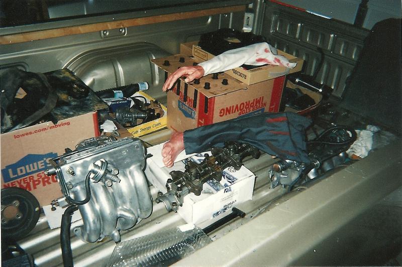

Re-torqued the head (warm engine) and replaced intake valve seals. The whole operation took 6 hours, and that was pretty much non-stop. I took off each valve spring in order to replace the intake seal and check the exhaust seal (I gave them some love-taps to make absolutely sure they were seated properly). I had to remove the throttle body (but not the plenum) to get to #2 and 3 cylinders' valve springs. I had the gasket for it left over from the head gasket set so that was breezy.
The rubber intake seals came off real easy, adding to my suspicion that they were inadequate and causing some of the cold start-up-smoking, but I'm sure I have a couple worn valve guides, too. I remain confident the smoking will be minimised, at any rate.

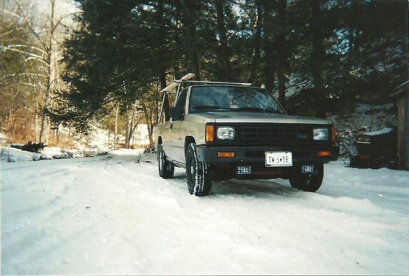

Ever since I got the engine fixed, I've been wanting to do an updated photo, but this winter hasn't allowed for it...until today. On the left, 5 months ago, on the right, this morning:
Attachment 8404 Attachment 8405

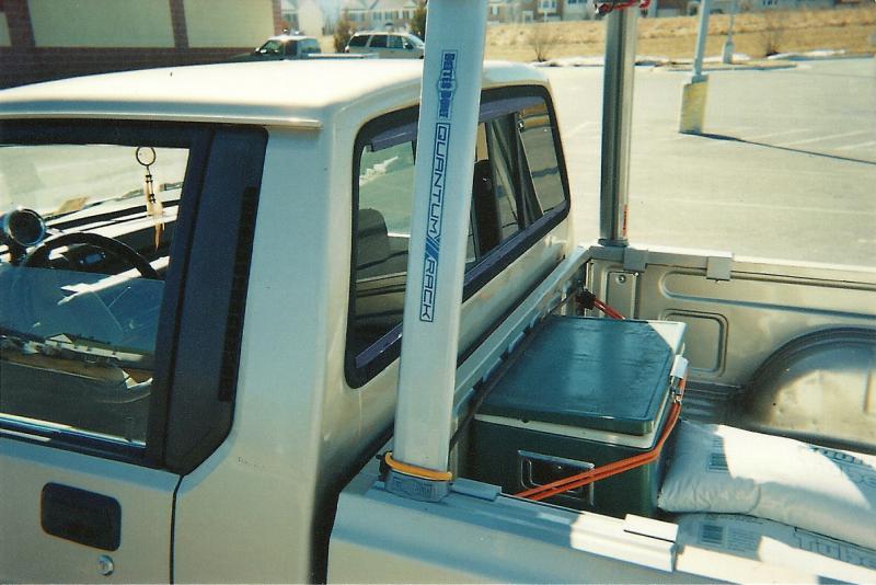

The ladder rack I found for $100: I had to cut 12-inches off the horizontals
Attachment 8409 Attachment 8410
