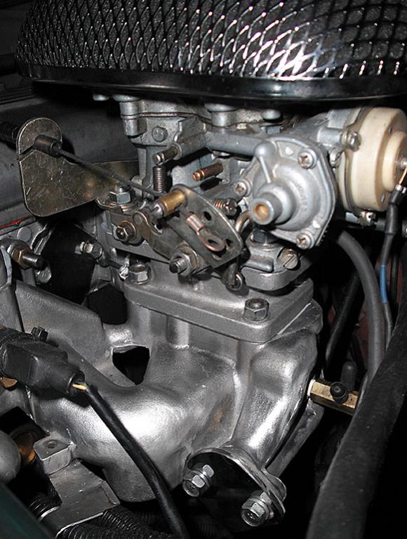

Just finished Weber/electric fuel pump installation Wednesday. Took my little truck out for about 20 minutes, put a big simile on my face. Runs very very well, far better then at any time since I bought it (about 3 yrs. ago, just after which mikuni carb/jet valve/oil pum and more all began to fail). I posted elsewhere this motor went of local rebuilder shortly thereafter including motor R&R, he screwed everything imaginable up and the truck has been sitting ever since.
Turns out I had blown head gasket (never overheated, no consensus amongst my friends who looked at it why it failed). Had head redone, reinstalled along w/Weber etc.

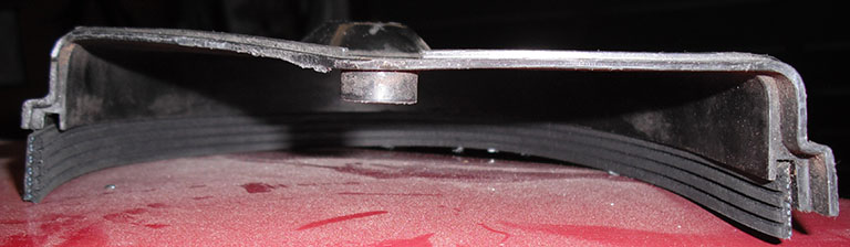

Attachment 6553
Notice the rear main seal parts above. You need to oil the seal and the crankshaft a lot so that the seal does not flip the seal lip over while sliding it into place. Grab both sides of the seal and turn it as your pushing it on, sort of like driving a car and turning wheel back and forth. Do it evenly until it cannot go any further. The next thing to put on is the seal ring. This will determine if you’re going to have a leak or not, if done wrong. The ring has to go on the seal and protect it. The ring also has a hole on one edge that looks like a drain hole or lube hole. This hole must be at the bottom or 6 o'clock position when placed onto engine.
I'm looking at NAPA's seal/gasket set, which does not appear to include the "seal ring" you describe. Should I expect to see this when I drop trans? ... or do I need to purchase one?
mikewarme recommends a "repair sleeve". I found one herehttp://www.discountautoparts.com/cat...al-seals/99315 for about $35, NAPA's main store here has one (they call it speedy slave) for about $55.
That's the part mikewarme describes, correct?
How is this installed, specifically relative to the catalogue diagram BradMPH posted above?
Quote:
But, before it goes on you need to put this stuff called anaerobic sealer on the seal and the ring's lower 1/2. This special sealer glue will not dry when left in the plain air; it only hardens when everything is bolted together and creates an air tight seal from the air. This glue stuff keeps the rear main seal from spinning and leaking and seals the ring up against the main seal. This is important if you want the seal to not leak.
