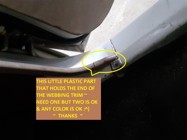

Dang hero you know how to stay busy !! If you go & happen to see a 4X4 1986 front hub cap I need it ~ one more of them front painted types and I will have a full set...

boozehero ~ I got the hub caps off ebay BUT I do wish that plastic door trim piece was available (maybe the Gen2 trucks use the same piece?) THANKS for thinking of me & the hub caps ~ I gotta clean em paint em attach em including a few dabs of silicone ~ dang front 4X4 things fall off so easy

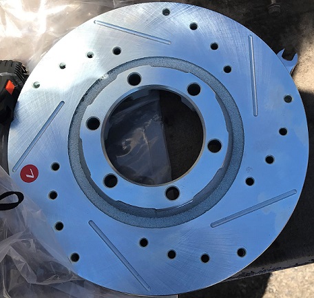

Anyway, here's a pic of one of the new front rotors going on this jewel

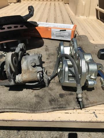

This is a comparison of the 2 piston caliper from a Montero vs the single piston caliper from a 1994 Mighty Max.
The dust shield needs to be trimmed, otherwise it's a direct bolt on.

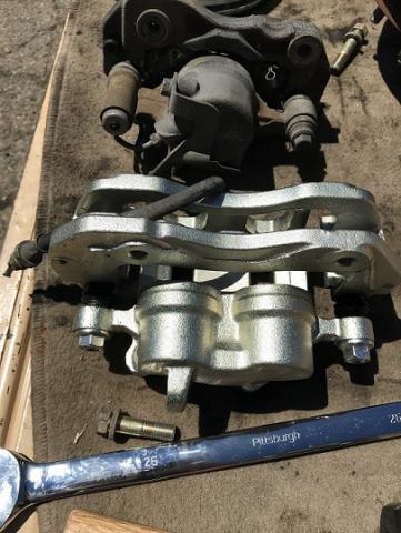

http://www.mightyram50.net/vbulletin...id=26678&stc=1
Here's another shot. The rotor assembly in the background is from a 1994 Mighty and is a direct bolt on to my 1979.
I've already sourced ceramic pads for the Montero calipers.
