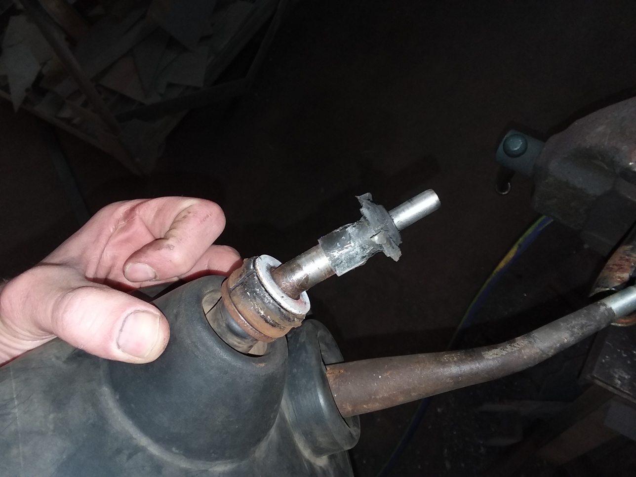

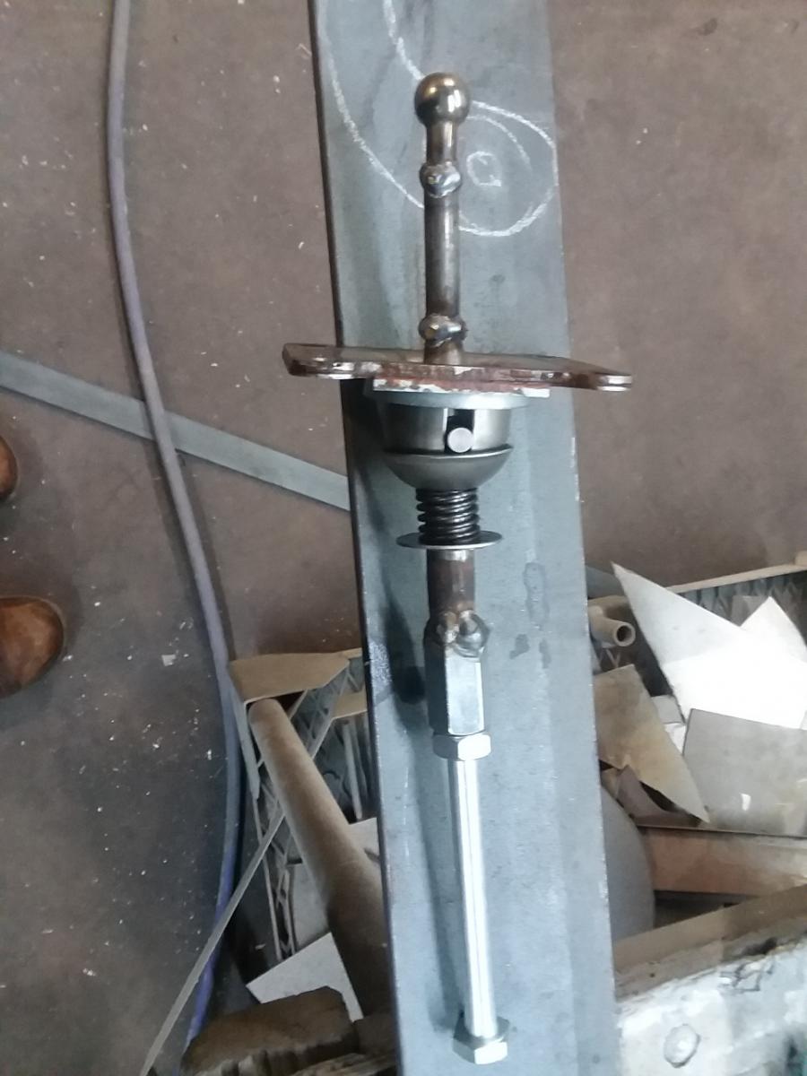

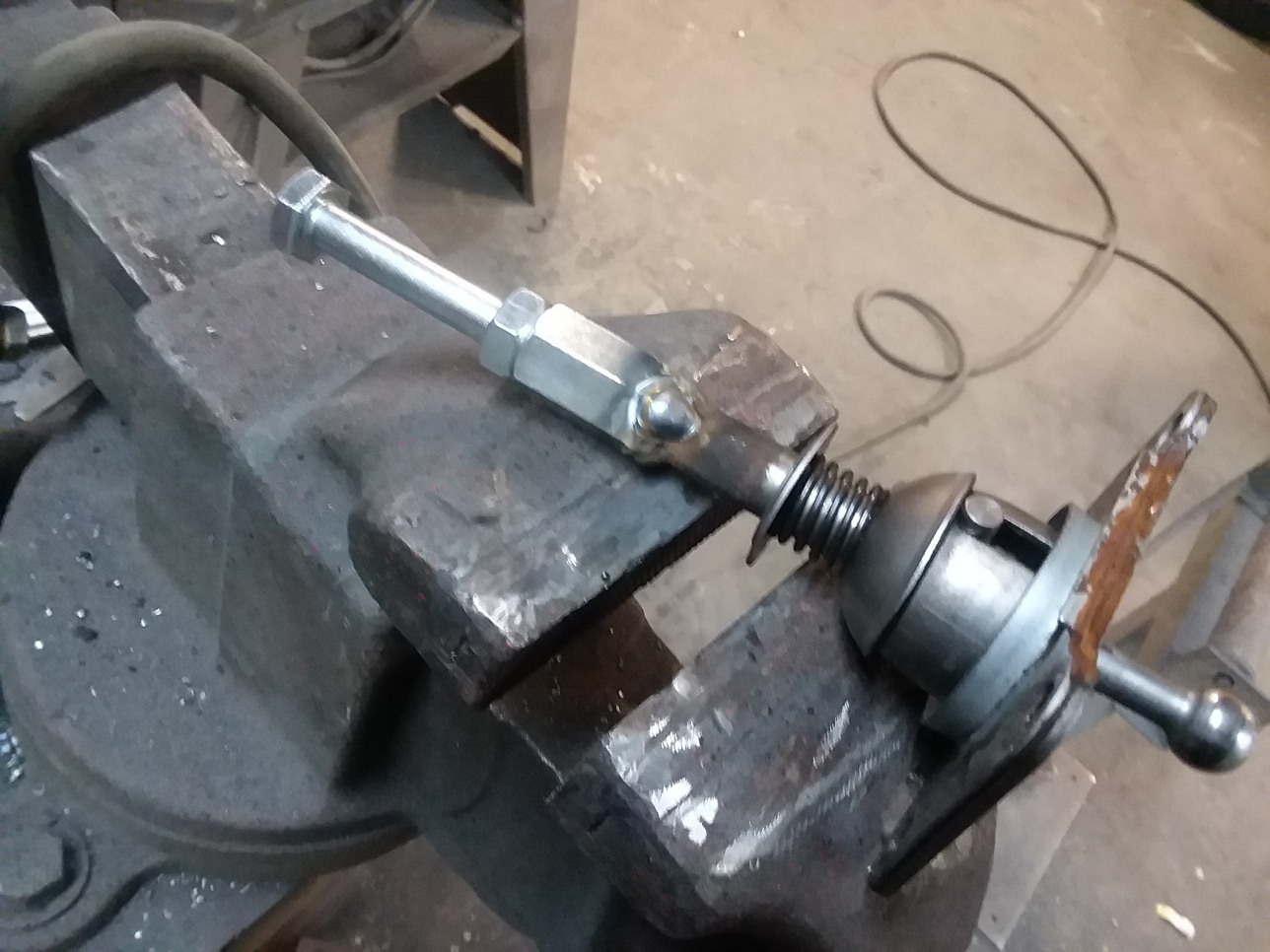

it was an uber bitch getting the upper off the shifter, had to cut open the side and pry it
open. i deleted the rubber insert, and added a thick heavy piece of 5/8" round stock to add
some heft to the upper, welded the upper portion to it, and an m10 bolt to the bottom to
thread into the shifter collar i welded on the lower shifter unit.
Attachment 22676 Attachment 22677 Attachment 22678
Attachment 22679 Attachment 22680 Attachment 22681
Attachment 22682 Attachment 22683 Attachment 22684
Attachment 22685 Attachment 22686 Attachment 22687
Attachment 22688 Attachment 22689 Attachment 22690

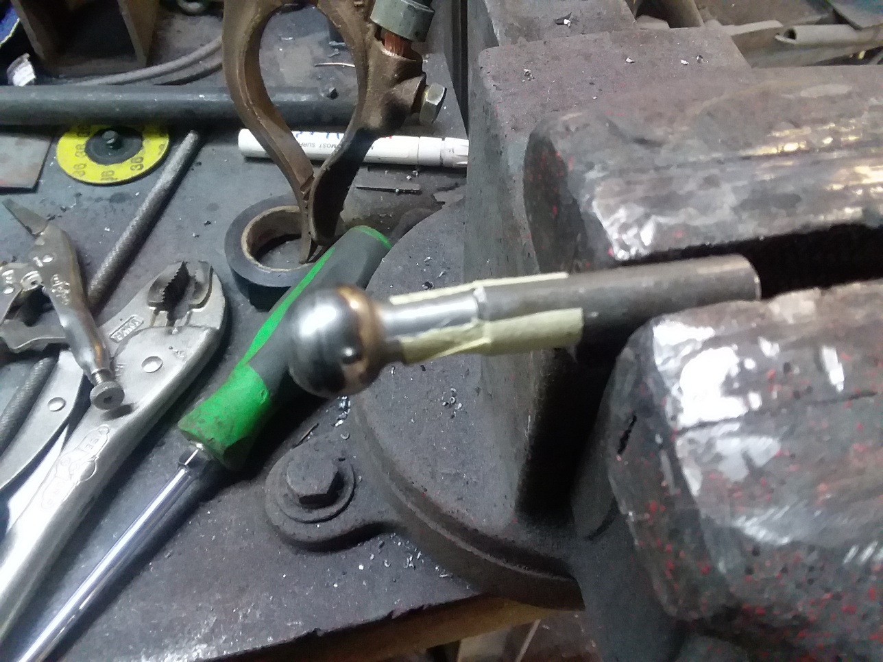

little trick i use to tack-weld small parts together you cant clamp. wrap masking tape
tite over the seam, then cut a strip out off the seam and tack weld it, flip over and repeat.
then pull the tape, wash off the adheasive and finish welding. G'nice.
finish product puts it right next to the steering wheel, throw is about 3-3.5 inches from 3rd to 4th.

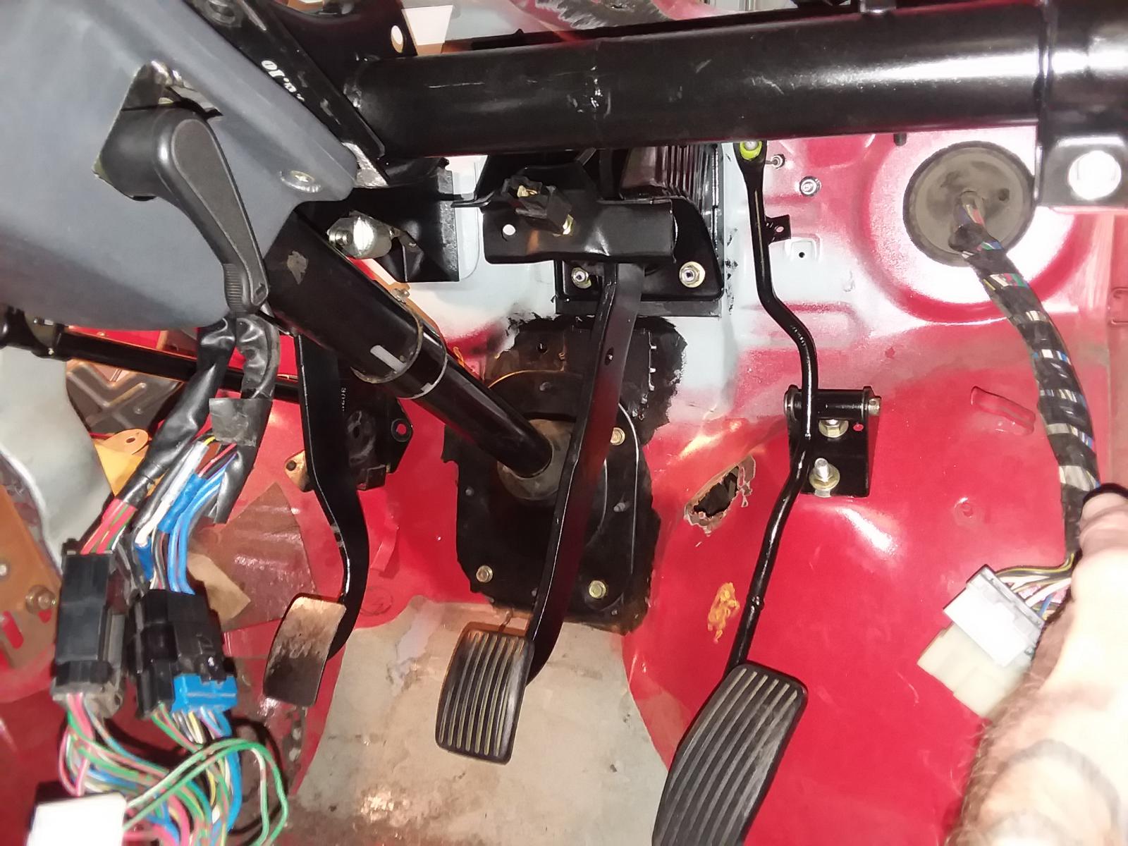

Only thing is I just pulled all the pedals & mounts out to get sandblasted & painted, as Mitsubishi
sent most of it out bare steel, so long as it was hidden up under the dashboard. Sshudve been
done a while back but now its all modified & ready for finishing.
It'll give me time to sort out the wires & radiator.

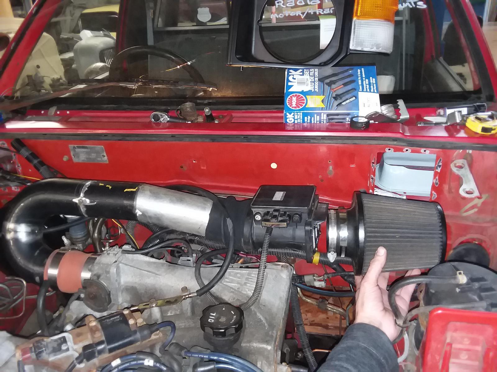

got the intake piping sorted, just have to cut out the flange to bolt the cone filter to the MAF:
Attachment 22750 Attachment 22749

finished up the intake
Attachment 22838

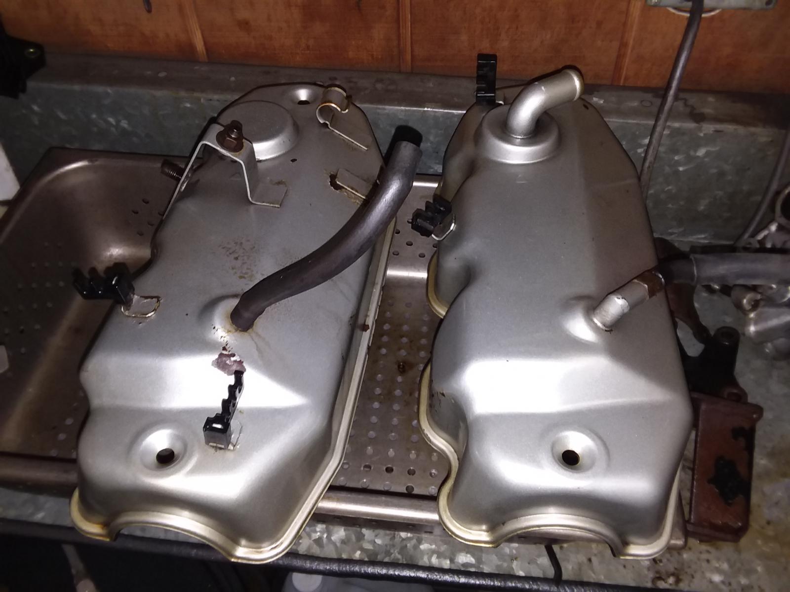

rocker covers are pretty damn good looking for 30 years old:
Attachment 22851

As much as I didnt want to give a white about this engine, my nagging compulsiveness
along w my father lead to most everything I unbolted to get sandblasted & painted, except for
the rocker covers which are in very good shape & I can't bring myself to mess up how well they
look for nearly 30 years old. ( I only washed the lower intake Mani, was NOT feeling pulling injectors
out & whatnot.... So no blast/paint for that)

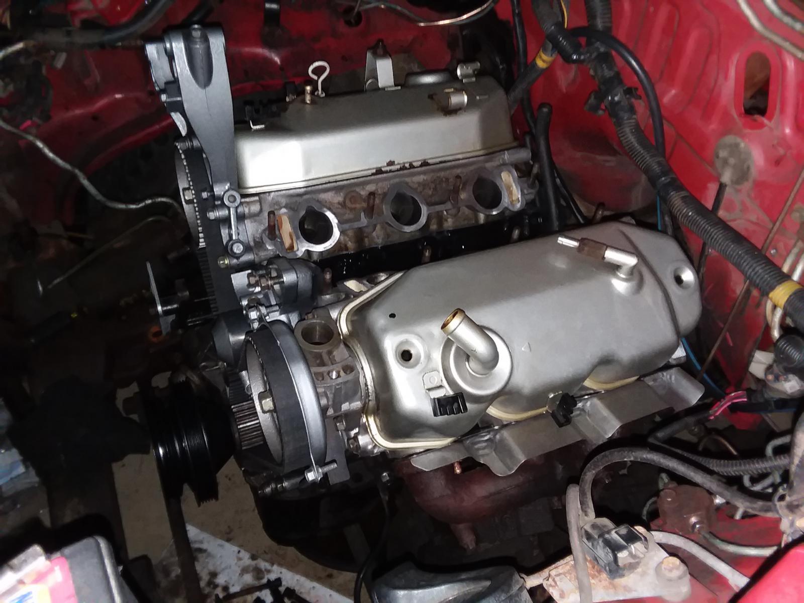

Attachment 22887 Attachment 22888 Attachment 22889
getting closer. still havent gotten the rest of the parts i need to button up the engine,
but soon ill have it back running so i can get it over to the body shop to get back on the
front end.

The clean up of the engine was worth it. It's one of those things you regret not taking a shot at when you had the opportunity. Nothing beats a fresh looking motor :thumbup:
indeed sir. well put. i am glad i did it now.

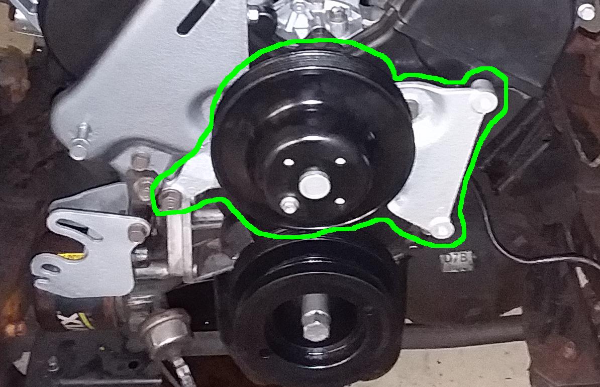

HELP!
i need a good used fan idler assemblie!!!
anybody got a 6g72 fan idler assembly they wana sell???
Attachment 23250
This guy. i need the pulley too.
LMK, thanks
