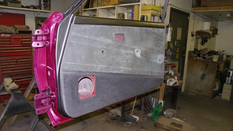

got some more painting done today,finished the inside colors and the outside in E-coat.
Attachment 2747
Interior gray and iris done.
Attachment 2746
Door in Epoxy Coat

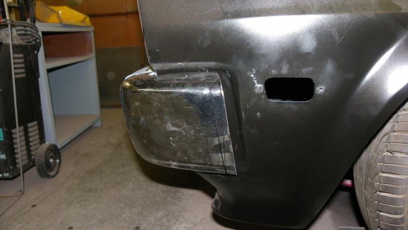

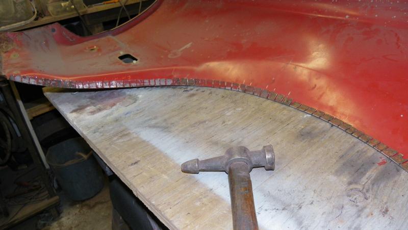

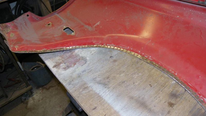

Folded over the lip on the fender to give the tire more clearance.

Notching the flange.

Flange folded over
Attachment 2759
JB Weld to make smooth.
Why not bondo?
Bondo will crack were the JB Weld will bond the metal together and flow into the cuts.Also the JB Weld put a little more strength into the edge.
How about fiberglass resin? That crap does not crack even with lots of flex.
Fiberglass resin is great for flexibility but has no structural strength without the glass.
I agree - devcon makes metal - filled 2 part epoxy that works so well it can be drilled, tapped, ground, and with withstand up to 300 degrees

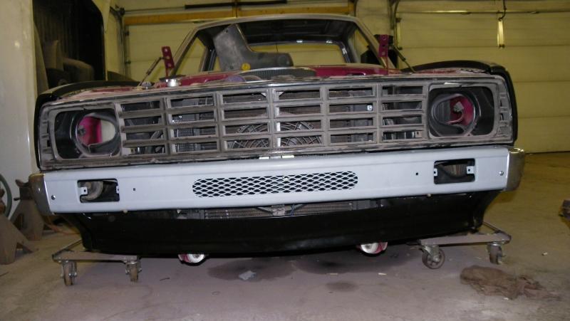

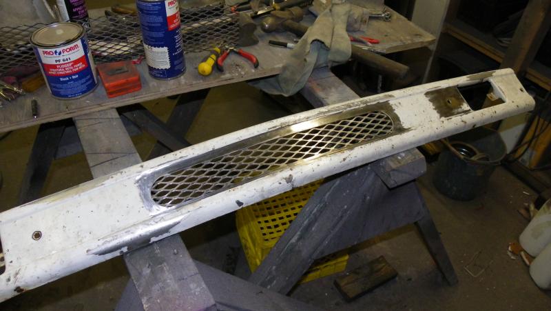

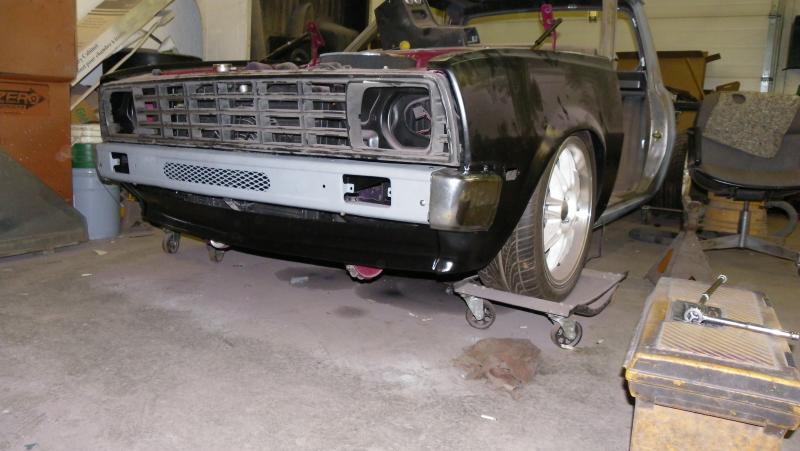

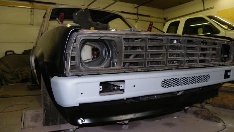

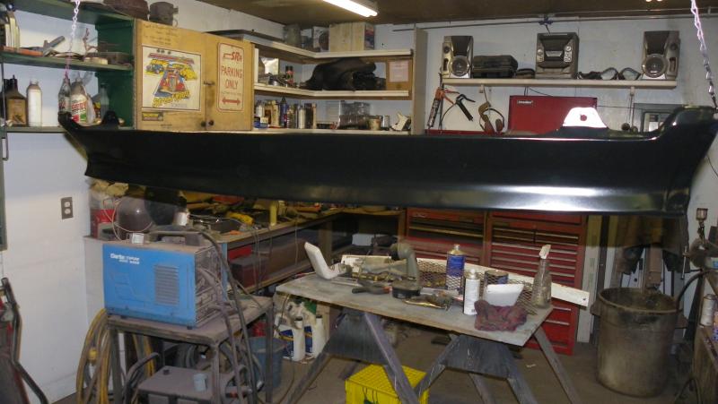

Got some more stuff done today, E-coated the valance and started on the bumper mods.
Attachment 2786
Valance
Attachment 2785
little more air flow for the rad.
going to try and make steel end caps for the bumper and maybe go with a different set of turn/marker lights.
You going to chrome the expanded steel?
Say yes....
Nope, might go black but not sure if I'm doing the bumper black or body color yet. If I go body color I will see how it looks and then maybe paint it black.
Chrome goes on the inside not the outside :P

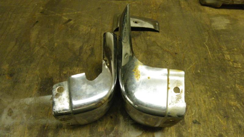

My buddy who painted Geronimo got a set of metal end caps from a Toyota truck bumper, possibly a early 4runner, and grafted them onto his 81 Arrow truck.
That was the other way I was thinking of going Pennyman. I found new end caps online for $13.00 but I'm not paying $89.00 shipping per.

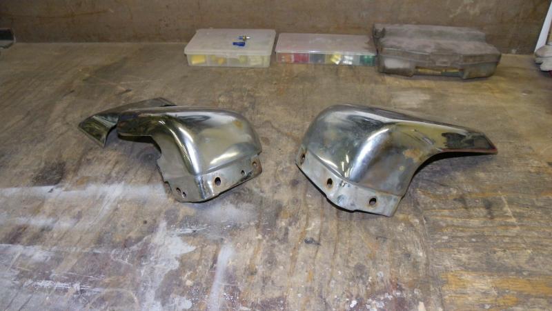

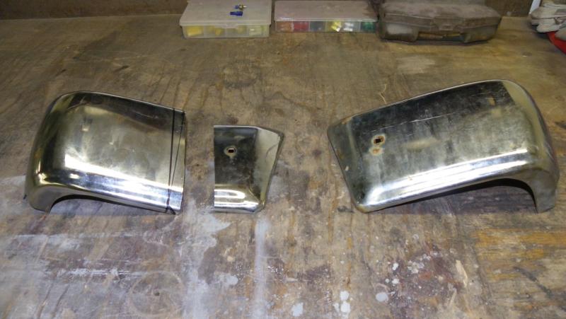

Was out at Pick-N-Pull for a few hrs yesterday and found some bumper end caps off an 86 Nissan. Started doing a rough fit up on my bumper and with a little cutting,grinding and welding it looks like they are going to work. I will take pic's of what was needed to modify them to fit.
Attachment 2876
First test fit for clearance.

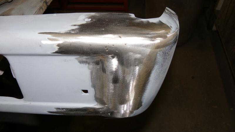

Here we go with the end cap mods........
Attachment 2878 Attachment 2877
shortening the caps.
Attachment 2879
Notching to clear fender lip
Attachment 2880 Attachment 2881
Rough fit up before doing some welding to fill the back of the cap.
The first gen bumpers are the same sizes, the only real difference is the holes in the center. So the caps would fit the 84-86 as well with these mods.

Started welding up and blending in the end caps.Still have some touch ups and smoothing to do but it looks like is going to turn out ok.
Attachment 2902
Drivers side cap welded.
Got the welding and grinding done. Have some small pin holes to fill but basically the bumper is done.
Attachment 2906
Drives side
Attachment 2907
Passengers side
so i now have an all steel 1 piece bumper :))

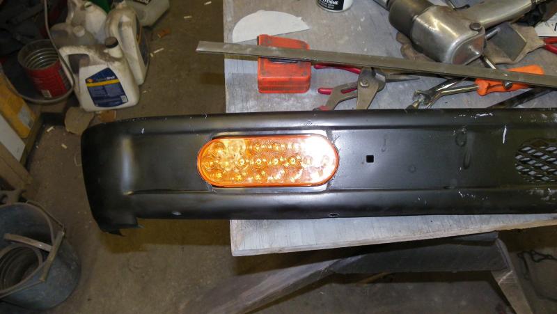

Yet another mod to the bumper. Making a LED truck turn signal fit into factory location.This is the first rough set up.
Attachment 2913
6.5" X 2" truck light.
take it you are not going to use the rubber grommet to hold in the light.
