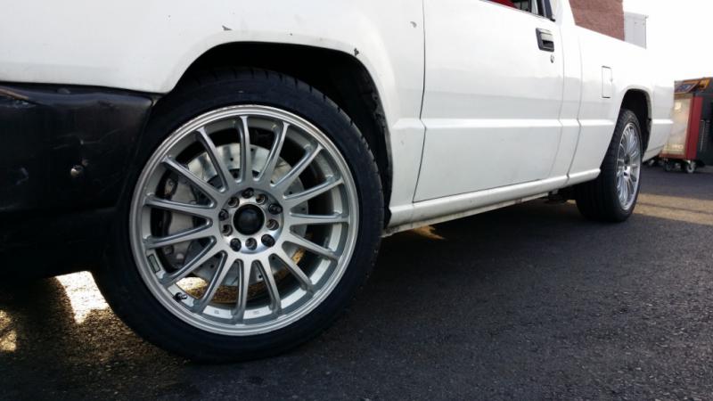

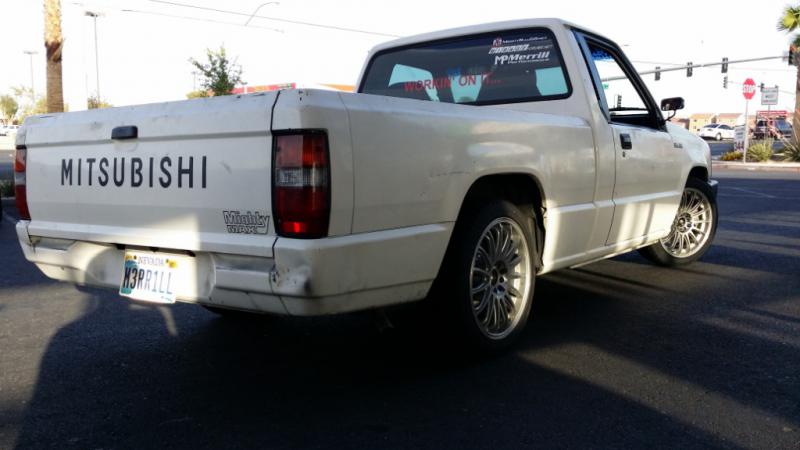

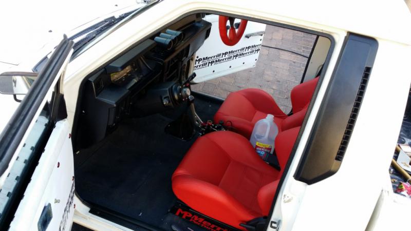

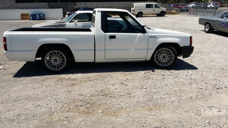

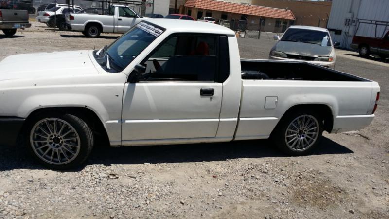

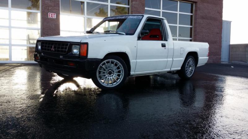

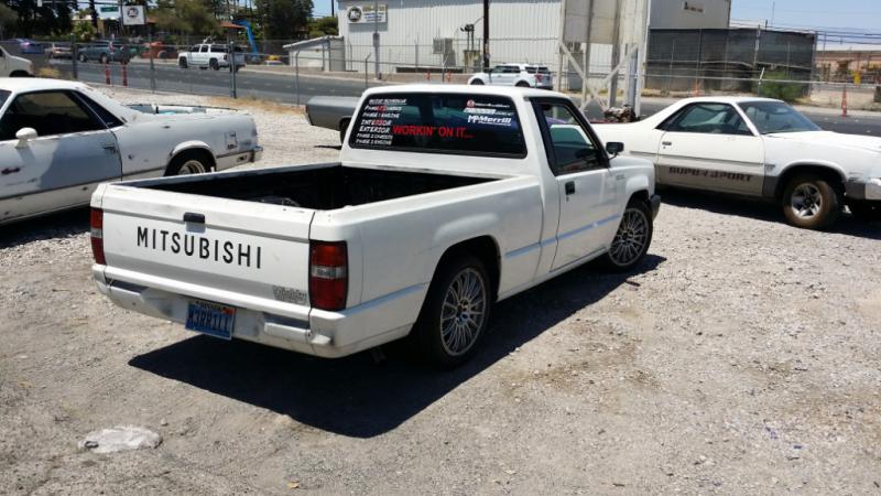

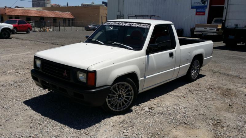

Phase 1 of the chassis is DONE!

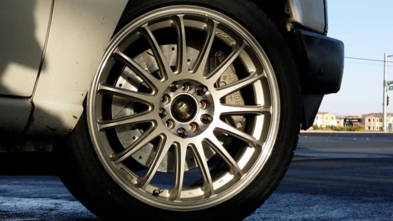

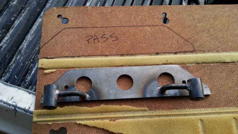

Just about everything went in as planned. I did find out my vendor screwed up the order, and I missed it. My drivers side caliper is the 91-93 caliper, while my passenger side is the 94+. Thankfully, the only difference is the legs that come off the caliper. Everything else is the exact same from pads, piston bores, and dimensions. I had to mod my bracket, and now it's all on there and stopping like a dream!

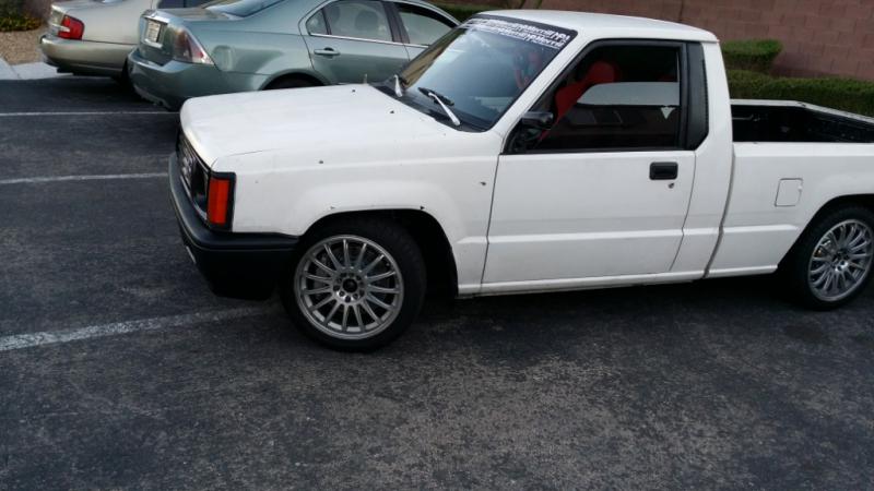

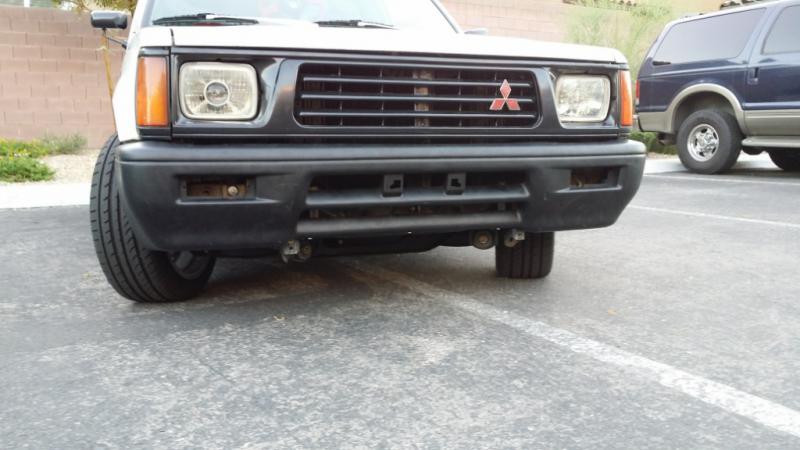

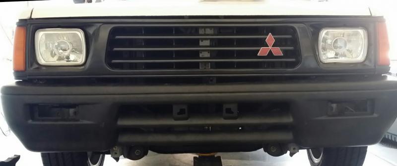

Above all, I'm mostly excited for my wheels to match :lol:

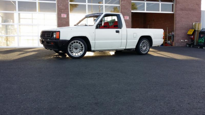

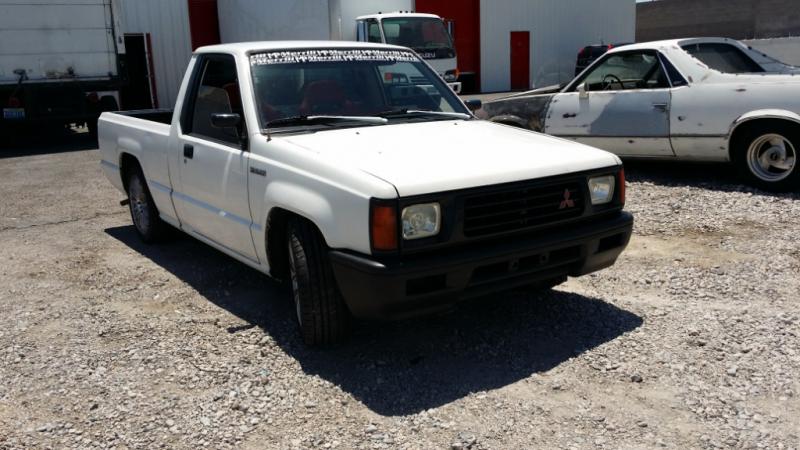

Calipers need their paint and special touch up front, but that can be done whenever.... I'm liking it all now, except the ride height. In these pics, the air shocks are full (to get it on and off the rack), and forgot to dump them. However, the ride height is slightly higher than it was with the other wheels. If I can hold out long enough (and not get impatient), Phase 2 of the chassis build will drop it lower.

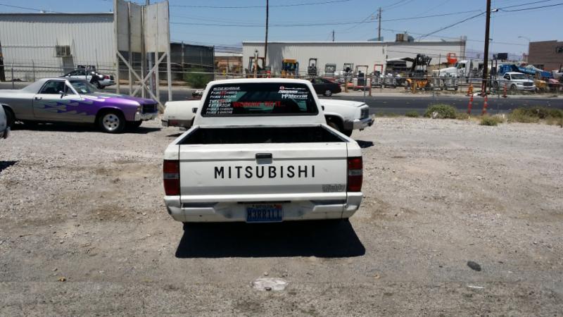

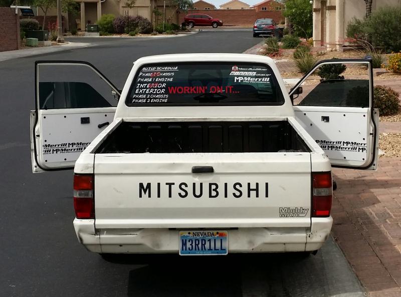

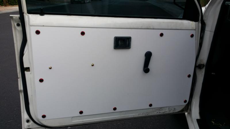

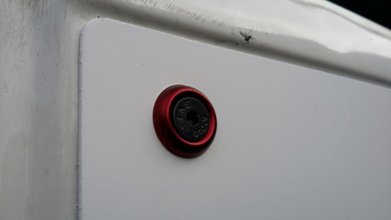

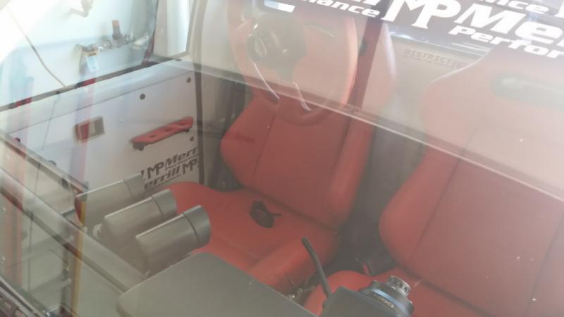

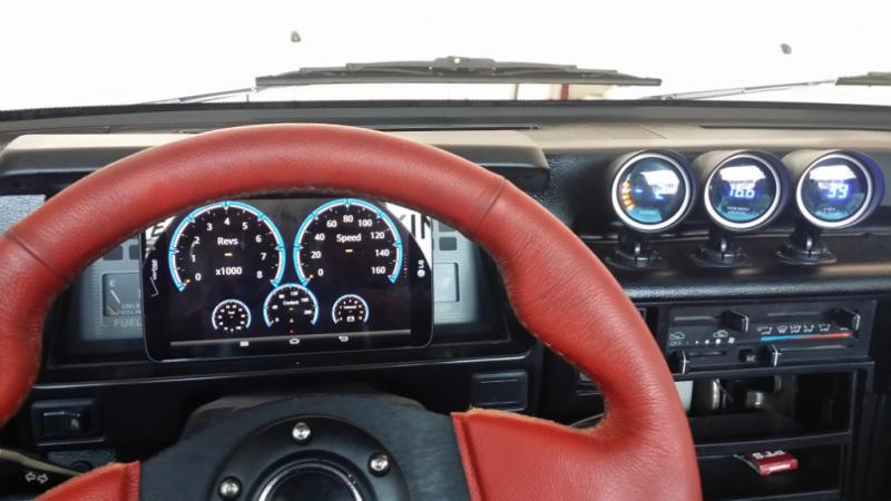

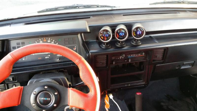

Attachment 10066Attachment 10067Attachment 10068Attachment 10069Attachment 10070Attachment 10071

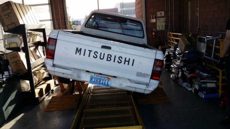

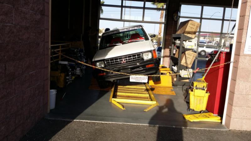

Just as I was ready to test drive, this happened....
Attachment 10072Attachment 10073
I was on the phone trying to operate the lift, so all I saw was one side of the truck go down, but when I turned around.... something didn't look right :lol:
For whatever reason, one side of the lift decided to drop while the other side stayed up. No harm done, but it sure did look funny... I guess next time I will pay attention.
