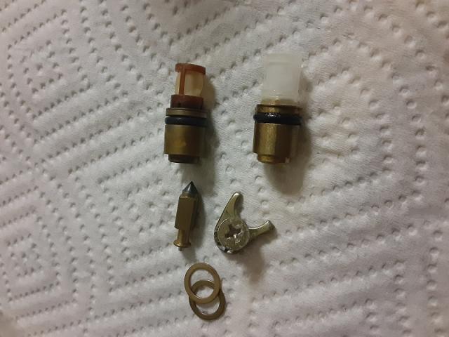

?? DISCOVERED ?? WHY OUR TRUCK WON'T START & DIED A SLOW DEATH TO THAT POINT ~ THE CARBURETOR FLOAT IS ABOUT 1/5 to 1/4 FULL OF FLUID, I JUST NOW GAVE IT A SHAKE... I LOOKED AT THE NEEDLE & SEAT, THEY BOTH LOOKED PERFECT... FUEL BOWL WAS DRY WHEN WE PULLED THE CARB TWO DAYS AGO; SO I BET THAT FLOAT COULD HAVE HAD EVEN MORE FUEL INSIDE AS IT WAS RIDING SLOSHING WAVES OF GAS..? JUST VACUUM TESTED THE NEW NEEDLE & SEAT 'n FLOAT ASSEMBLY ON MY REBUILD FRANKENSTEIN; PASSES EVERY TIME :^) ALSO APPLIED 12 VOLTS TO BOTH THE J/Y BVV ELECTROMAGNET & MY ORIGINAL; THE ORIGINAL HAS A LITTLE STRONGER PULL & IT WILL GET USED IN THE MONSTER... PLAYED PUZZLE WITH TOP & BOTTOM THROTTLE BODY GASKETS; ALMOST GOT TRICKED BY MINOR THROTTLE BORE SIZE DIFFERENCES... MIKES'S CARBURETORS SUPPLIED FILTER https://www.carburetor-parts.com/Mikuni-Solex_c_28.html
http://www.mightyram50.net/vbulletin...id=25754&stc=1http://www.mightyram50.net/vbulletin...id=25755&stc=1
Nice sleuth work xbox :thumbup: The fuel float full of crusty fuel - not so good...
Bummer they don't include a new float in the rebuild kit. They do with Weber and the one I got for my motorcycle. I thought they did with all kits.
I bought a replacement float from RA 'n it would probably work but it's a rather different configuration & as such, the float level measurement is taken a completely different way than the factory method (strange...) but I'm using my original float... It's a darn good thing member yamahauler sent me an FSM & member 4cylinders sent me a Mikuni carburetor in parts and a darn good thing parts puller Allen in Roseville, CA sent me the PicknPull 1985 California emissions Mikuni ~ without all these spare parts and a 2nd Mikuni carburetor; I do believe it would have been somewhere between tremendously difficult & darn near impossible for me to rebuild the Mikuni carburetor... With little to no practice and having to wait several months for parts, the memory fades with the large amount of time between disassembly & reassembly... There are four letter words that describe the situation better than my story above..!

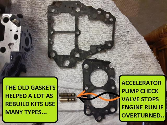

You don't get a choke release assist diaphragm (there are a few different types which is helpful too...) and some kits don't even have the accelerator pump diaphragm and gaskets in them (straight up useless as they are prone to failing). A 100% overhaul kit would have a new secondary actuator servo, a wax pellet for the choke, the choke assist and gaskets for 3 different 32-35DIDTA carb variants and the replacement fuel bowl float (say hi to a $500 rebuild kit) but they don't make them as nobody would buy them :)
I have a Hygrade FL87 float that's of no use to me. It's yours if you want it.
Regarding the ball in the float chamber, it sits in the channel in the bottom of the chamber shown in the first picture of your first post on 9/11/20. The ball is kept in the channel by two stamped strips of metal held in place by the two pins and screw/washer at mid-bottom of the chamber. In the event your grocery run takes a disastrous and unexpected turn, the ball pushes on either of the metal strips which in turn contacts the float stopping the fuel flow. I wouldn't worry about omitting the ball and definitely delete it if you don't have the metal strips. I've disassembled several remanufactured carbs and none of them had the ball and metal strips. Unless you do some serious 4-wheeling, omit it. Probability is in your favor.

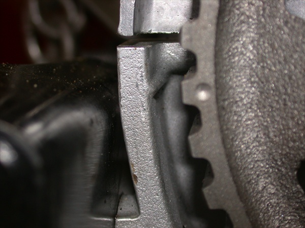

if the truck has a belt. The timing mark is below the flat of the head. Many people get it off 1 tooth because they go off the flat of the head.
http://www.mightyram50.net/vbulletin...id=25776&stc=1
I need these details, thanks guys... The timing mark I'm searching for is on the fan belt pulley somwhere, this truck has two V belts alt & pwr steering -- I'm gonna look at the pulley lip closest to the engine (Dr. geezer's advice)

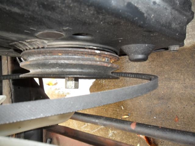

I misled you Xbox. I was picturing my Dakota when I told you about the mark. Here is a picture of mine. The white spot is the notch on the inner pulley closest to the timing belt cover. It is a notch so you should be able to feel it.
http://www.mightyram50.net/vbulletin...id=25777&stc=1
