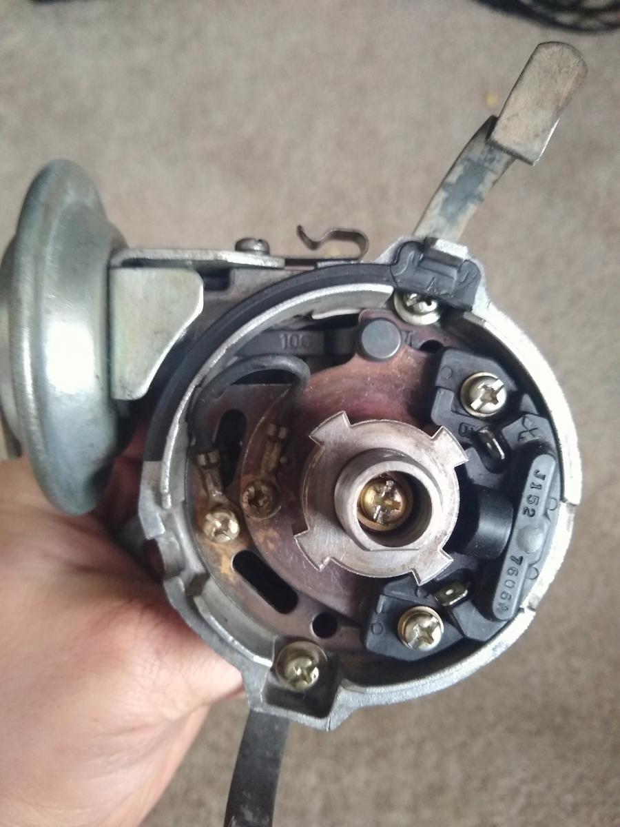

Working on getting the truck running right, it's not firing on cylinders 1 and 2. Decide to pull the distributor out and clean it, find all sorts of crap inside it. Get it back together, go to put the new cap on and the black plastic spacer/ring/gasket falls apart.
Turns out half of it was missing, causing the cap to tilt slightly and keeping the rotor from contacting number 1 and 2.
Tried spinning the distributor without any spacer, the rotor hits the posts inside. Now I need to figure out where the hell to find that spacer.
EDIT: figured I'd post a picture of the problem.

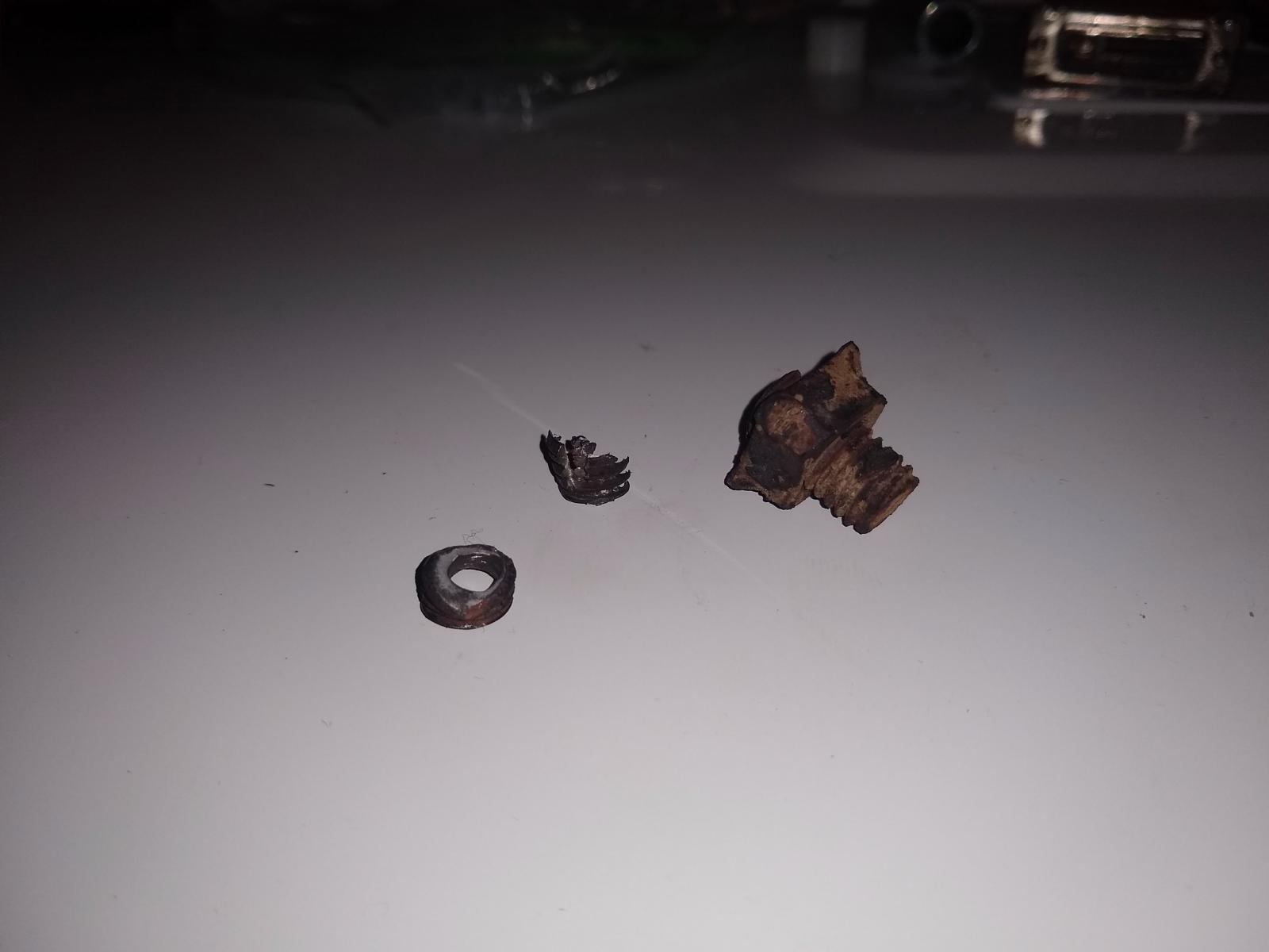

Got a lot done last night. I took a chisel to the broken bolts in the lower control arm, knocked one of the nuts completely off. The other one was a little more time consuming, but I finally got a drill bit through it and got it out. Below are pictures of my sucess. lol

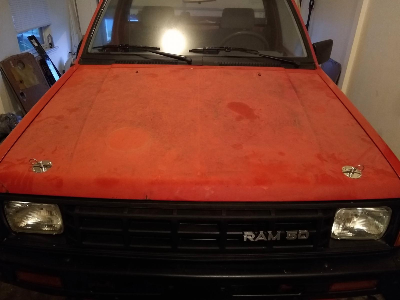

Once the new front shock was in, everything else kinda just fell into place. I got (almost) everything buttoned up, got the truck back down on all four wheels, and decided to make holes in the hood.

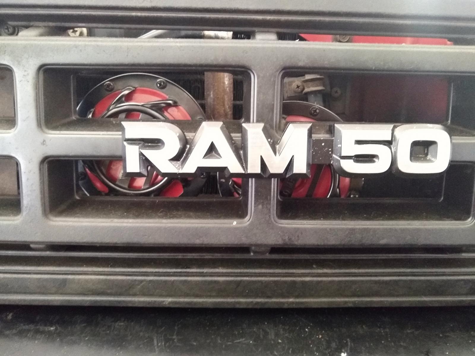

After fixing the button and cleaning off the contact points for it, I sounded the horn and was very disappointed. So I gave the truck some more bark to match it's bite.
