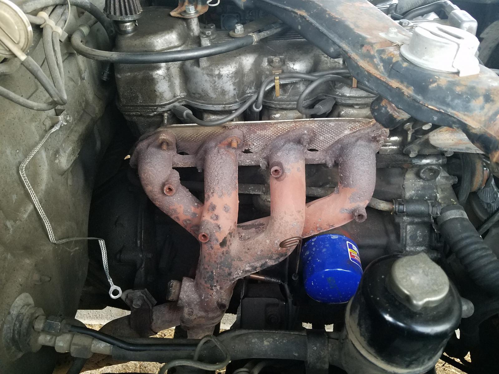

So the heat shield is giving me fits. I'm trying really hard not to break any bolts. Gonna let the pb blaster chill for the evening.
Attachment 21094
Somehow this evening murphys law didnt apply itself to my project. All the bolts came loose and everything went together smoothly. O2 sensor is installed.

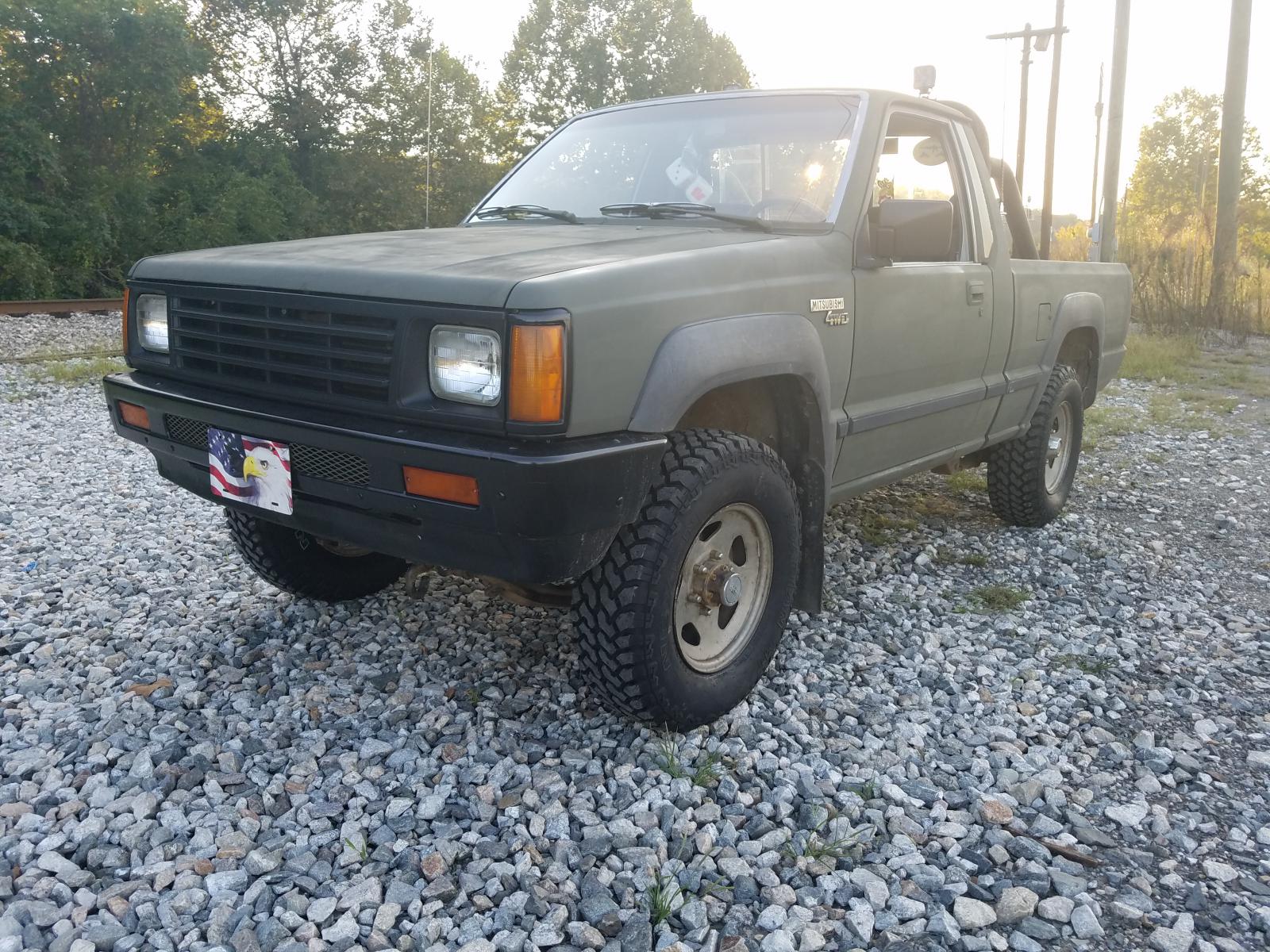

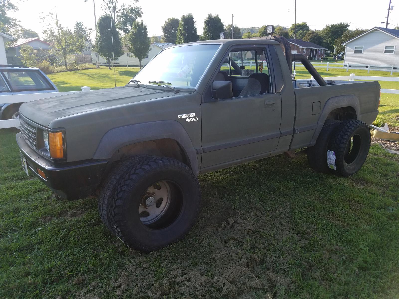

Hopefully I'll get it to that point eventually. I hope to have new tires by this weekend. Attachment 21138
New tires all around now.
Attachment 21139
Looking good mate. What tyres did you go for?
Looks like it means business :thumbup:
Sweet!

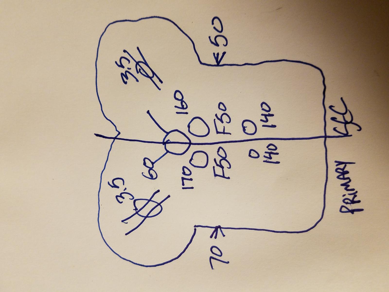

So I tore back into my weber. Power valve diaphragm is bad again and excuse my crude drawing of all the jets as of now. Anyone have any suggestions on where to start on jetting for a 2.6l?
From what I'm finding the jet sizes are for a factory DGAV minus the primary idle jet I've changed.
Attachment 21162
Just ordered an new power valve diaphragm and some main jets and air collectors. Any one any good with figuring out emulsion tubes? Or can tell me the characteristics of what certain sizes do to the operation of the carb?
Get a spare emulsion tube before you start meddling. I did a lot of research on them, and here are the big things that I took away. Holes at the top will lean lower in the rpm range. Holes at the bottom will lean higher in the rpm range. Holes above the fuel bowl level will delay the activation of the main jet because the air can flow through those holes and into the venturi without emulsifying any fuel. Too many holes at the top will lean out the high rpm as well. Holes that are below the fuel bowl level will cause the main circuit to activate earlier and enrich the mixture.
The diameter of the emulsion tube and steps/taper also plays a part in how it acts. Generally speaking, the larger the diameter of the emulsion tube, the less fuel reserve in the emulsion tube well and leaner it will be.
My jetting is far different from anything I have come across, but I feel it runs fairly well. It starts at 100 degrees, or 13 below. Doesn't diesel any more when I shut it off. I've towed up to 3000lbs, cruise routinely at 75 on the highway without having my foot buried in the throttle, and return an average of 22mpg mixed driving with the automatic.
I don't have it written down, but I believe what I am running (although i have a opened up exhaust and undercut valve stems) is a 130 main, 140 or 150 main air corrector. a 60 or 65 idle, and a 170 idle air corrector (I modified my carb to accept main jets as idle air corrector jets) but 170 is the stock size. I also have a 1mm hole drilled in my throttle plate opposite of the transition ports. I could never get the idle right until allowing more air in with the hole in the throttle plate. Otherwise I would have to have the idle speed screw in too far, and it would always diesel.
I think from here I need to reduce my idle air jet to get it to richen up just a tad at highway light throttle cruise, but this will mean enlarging the hole in the throttle plate to get enough air at idle. I also need to lean it out at low rpm heavy throttle which I will most likely try to accomplish with a few extra small holes in my emulsion tube. I am running a stock f50 at the moment.
