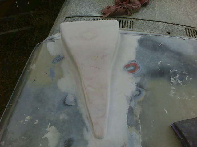

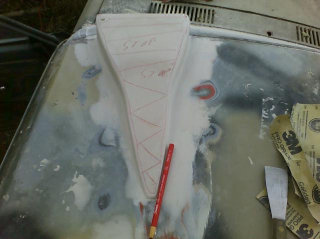

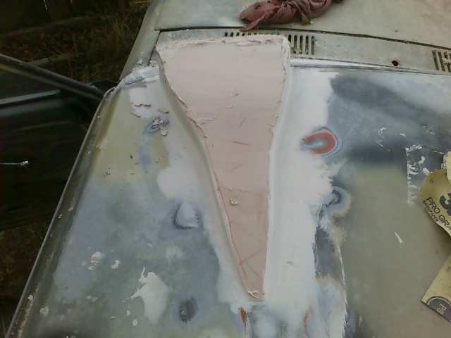

So I had some one ask me how is it when working with foam in building a plug for fiberglass you keep from burning through the Bondo and hitting the foam?
The answer is pretty simple. Use a "China Marker". AKA grease pencil.
What I do is put on the first coat of Bondo. Get it roughed in and mark it with the china marker. As you sand it will show through the Bondo when you hit 0.003 inch. That tells me when to stop sanding and add more Bondo where it needs it.
Here is what it looks like after I add Bondo.
Attachment 6883 Attachment 6884

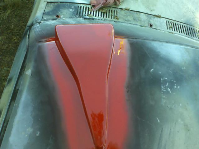

Ready for primer and paint. From here I can make the mold.
Attachment 6886

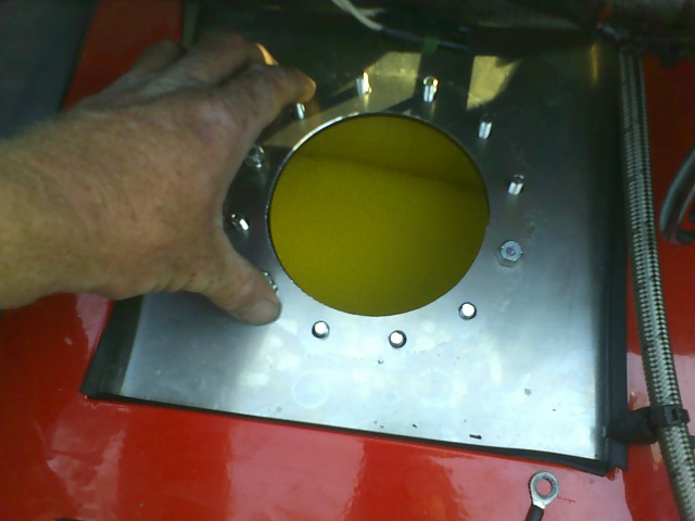

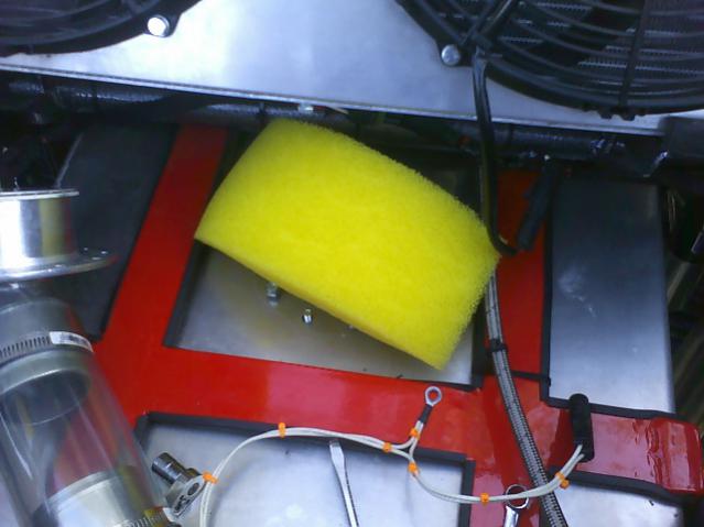

Well I'm finally down to the last of the nitty gritty stuff on the punch list. One problem was fuel would pull away from the fuel pick up tube during hard acceleration. I figured it was because the fuel cell needed more foam. I was correct. It only had 3 small chunks of foam in it. So I made a call to fuel safe and ordered more.

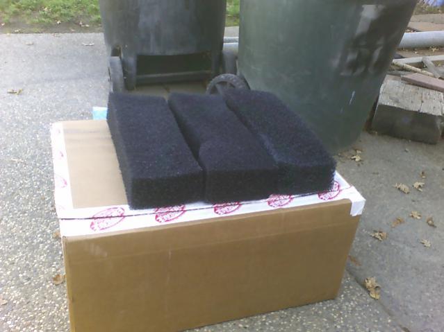

This shows old foam compared to the box of new foam.
Attachment 7051
The next problem was how to get it into the tank. It was a lot of foam and a small hole.
Needless to say with some time and blood things do fit. It was not a 10 minute job to say the least, but I got it done. That took care of the problem but caused another. Now it takes fuel just a little slow for me. Now I will remove the center peace and trim it down to allow for more surface area so the fuel can flow through it faster. I might even put a trench from front to the rear of the tank in the foam so fuel can flow in two more directions as the foam allows it to pass through.
Well it looks like I will need to dig in there one more time to get the foam and the fill rate to an optional flow.

Well the first part is done but I forgot to show what the finished look of the part. Here is the plug ready for molding. The part will be carbon fiber.
Attachment 7055

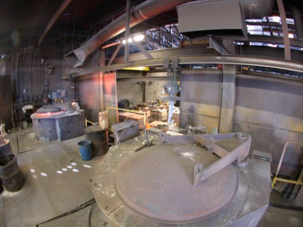

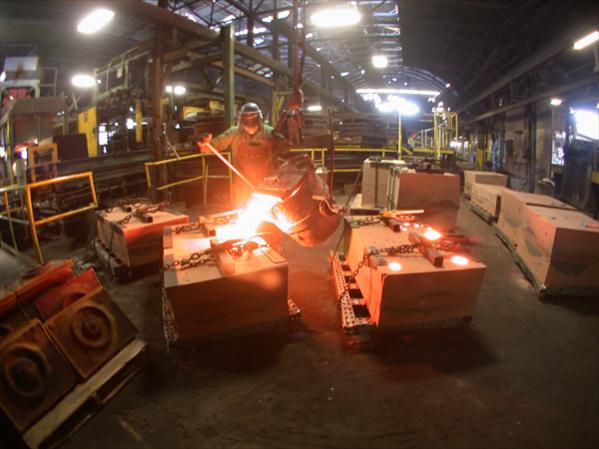

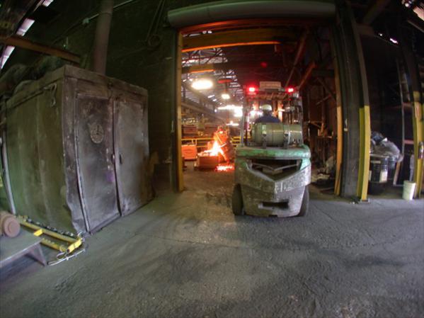

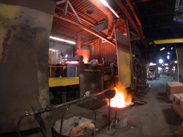

I went out and scouted a passable photo shoot location this week. It could work but it's just to tight to stick a truck in there and get the shots we are looking for. But it would make for great background. I need to find the right place. The background makes or breaks a cover shot. I'll find it. It just takes time. Lots of time.
This is Lodi Steel. They are willing to work with me but they only have a small furnace. About 2000 Lbs. It would make for a good looking back ground. I just love the colors.
Attachment 7446 Attachment 7447
Attachment 7448
Attachment 7449 Attachment 7450

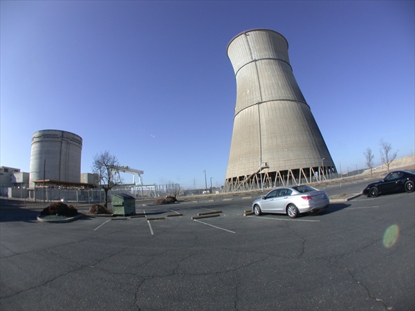

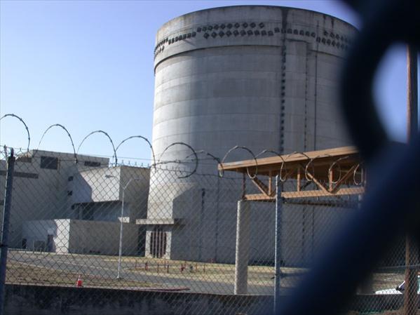

Here is another location I'm working on.
It will take some work and getting to the right person but in front of the reactor building would work.
So could the nuclear material loading area under the huge crane.
It can't be any harder then the DMV.

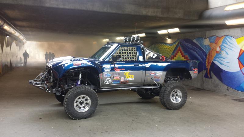

Well since the other locations did not pan out I settled with two locations I could get. Old Sacramento for evening glamor shoots and an equine boarding stable and training for the rest of the shoot. We will be shooting there tomorrow. Yes we do have a model to put into the shoots and NO you can not have her phone number. The Old Sacramento shoot went from noon tell midnight. The cops did show up because people thought there was a fire in the underpass we started to shoot in. Then we moved out into old town for the rest of the night. I'm glad I spent the time and money to get the permit. It saved our butt 3 times.
But hare some teasers of what is to come.
Shooting in the underpass.
https://fbcdn-sphotos-a-a.akamaihd.n...19069321_n.jpg
Here is one of the night shoots.
Funny thing is I was in the cab. But the exposure time is so long you don't see me go from sitting up to laying down and then reach up to flip the light switch off. This one was no good as the lights were on just a moment to long and are to "hot" for th picture.
https://scontent-b-lax.xx.fbcdn.net/...47415922_n.jpg
