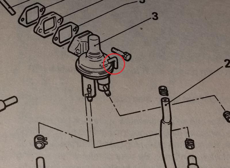

At this point i have it narrowed down to one last "leak". Coming from my Fuel Pump is a vent or something of that sort that runs from the top of the pump down to below the oil pan and then nowhere. Fuel spritzes out of that while the engine is running, is this supposed to happen or is it a sign of a bad fuel pump?
That should run back to a tube on the firewall and into the tank. If gas is coming out thats a bad thing.
that is the return line from the pump to the tank - there is supposed to be a small line that the hose goes on that goes back to the tank.
Alright, well that is something that i need to fix then, does anybody maybe know where to find a diagram of it. i checked the manual and its not quite clear.
Alright, i looked it up in the manual and it is of no help at all. Maybe i can get some more clarification from you guys I've circled the item in question.
Attachment 12224
Fuel return
Fuel pump
not original hood and the hood is to a different engine size so that doesn't help...I'm still having a hard time finding anything that is missing connections. I can't find where this thing would go...

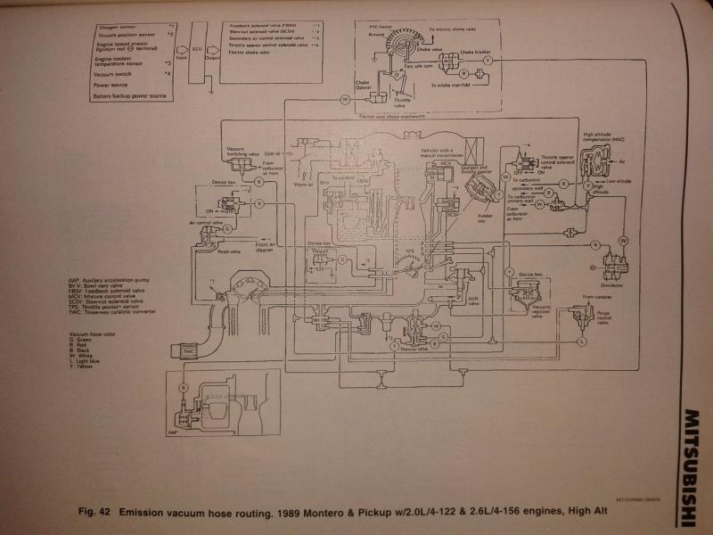

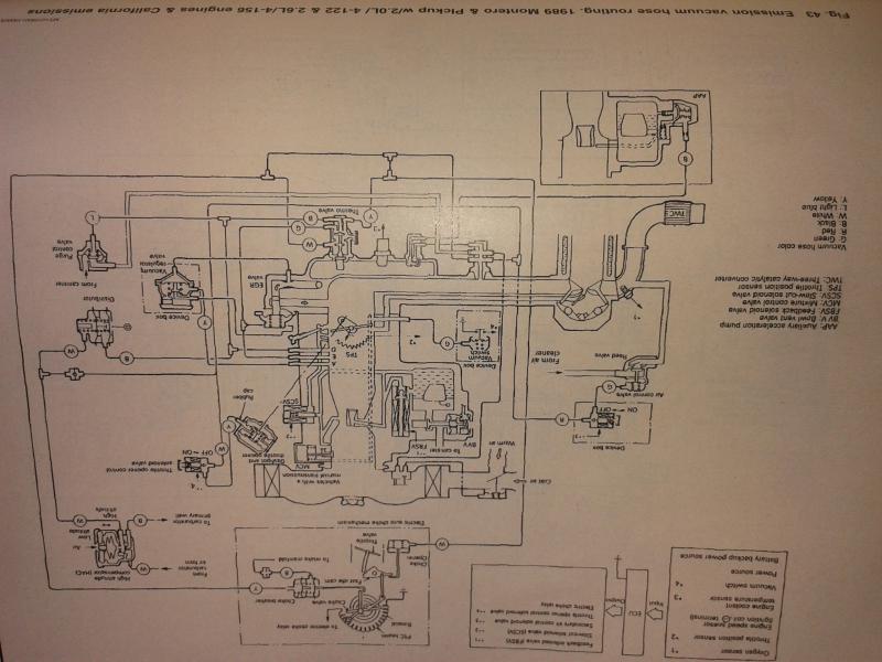

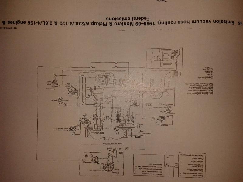

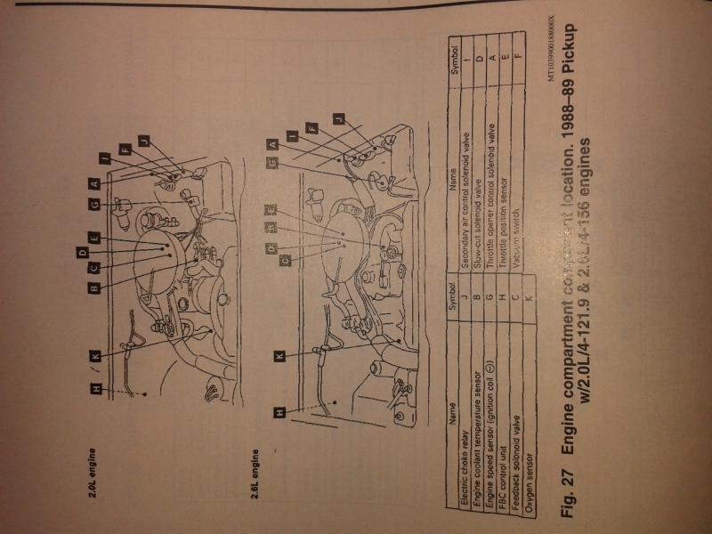

I suck at camera phone. Can someone flip the images? From my Motor emissions guide, HTH.

Flipped.
