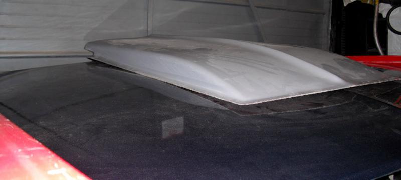

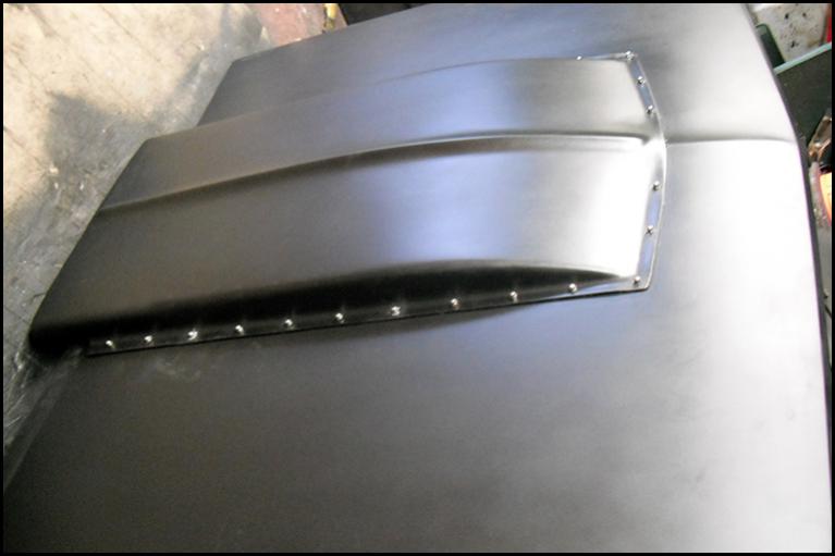

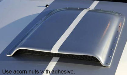

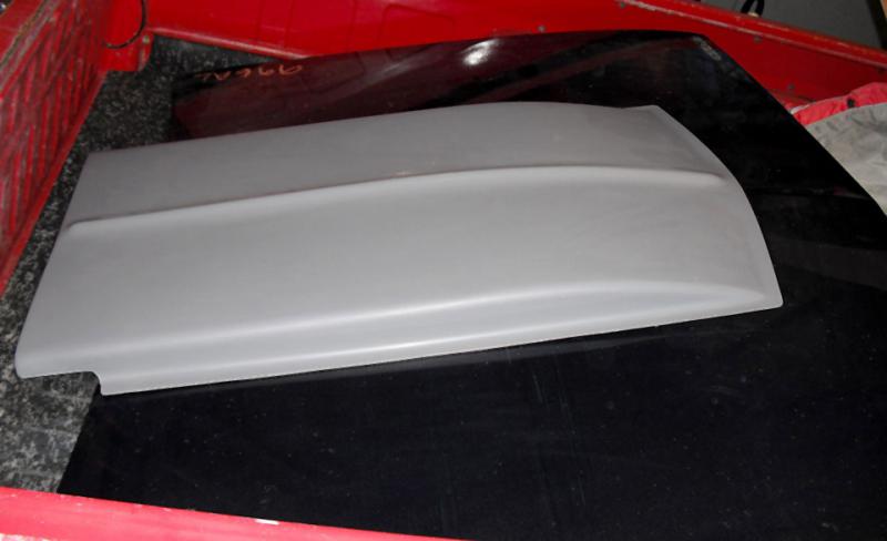

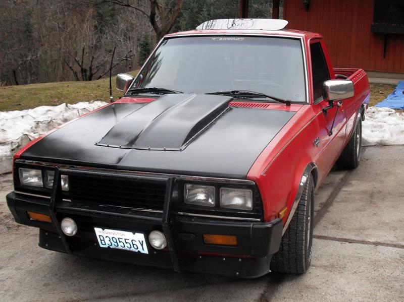

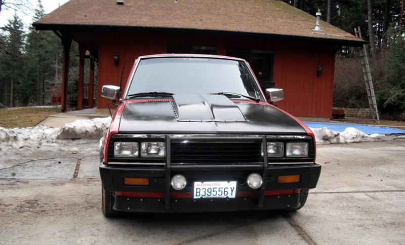

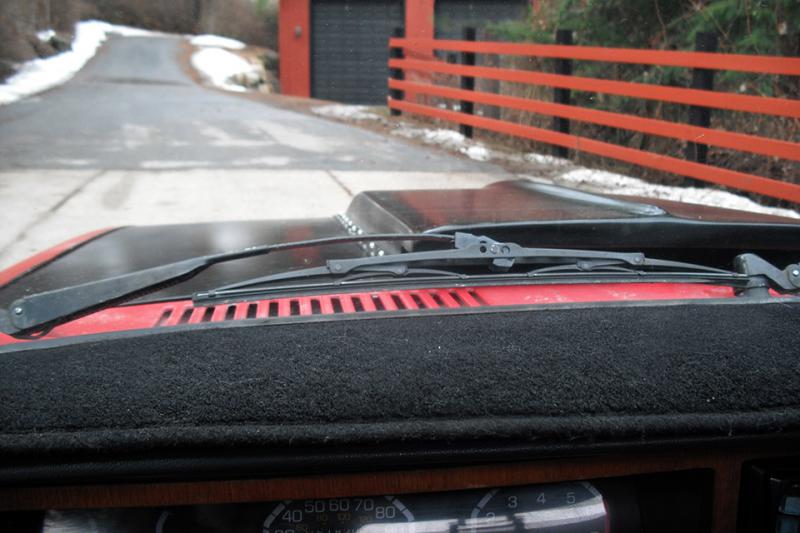

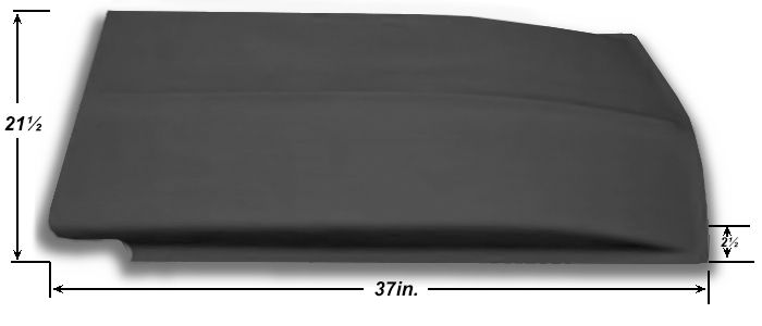

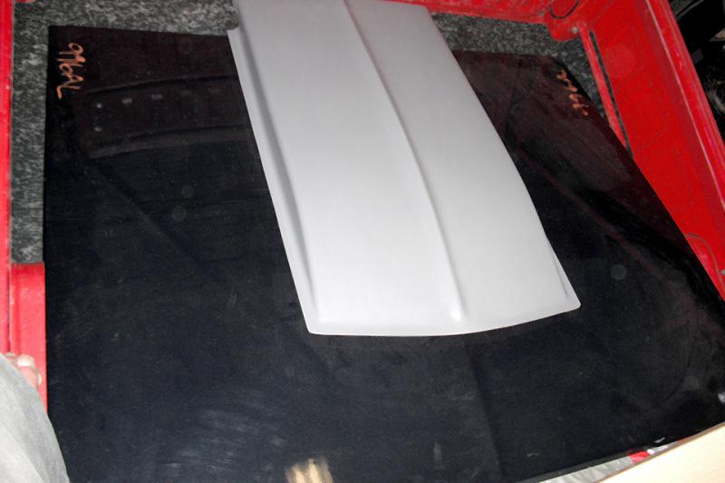

Before I redid Geronimo, I had an A+A fiberglass ABS cowl induction scoop that was attached with rivets and had the scoop sandwiched between 2 layers of fiberglass and bonded to the hood. After a few years, it started to crack at the corners, and even redoing it with the woven cloth did not solve the cracking at the corners. That is why I now have a Bolton scoop - I used Ultrafast urethane windshield sealant to bond the scoop to the hood. Its the same sealant windshield installers used to glue in windshields before airbags - it allowed the windshield to be kicked out if necessary
