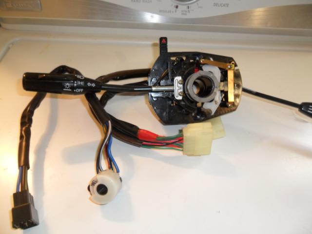

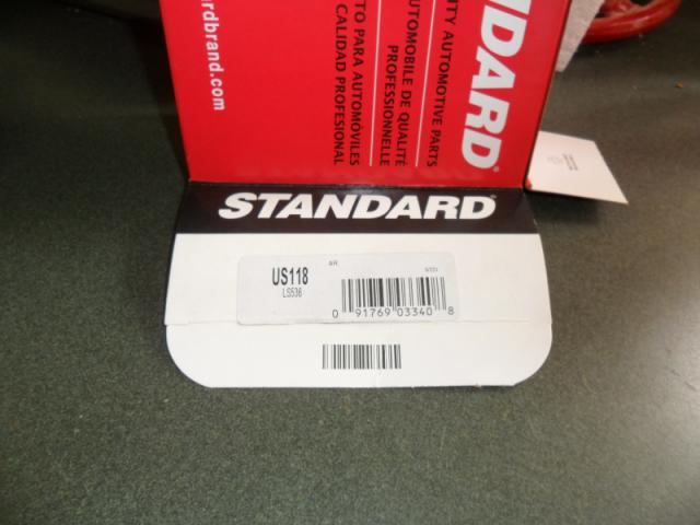

I found an after market ign switch the Standard US118. It has an extra wire to the connector which doesn't matter. That two wire connector that was taped to it is a separate part of the switch, well it did not come with anyway. I got it for $15 shipped. ! folks on Hollander and car-parts.com priced it and shipping different but it always ended up at $60 or better shipped for a used one and they insisted on sending me the key lock even though several did not have the keys! I decided to spend on a brand new "Mopar" multi switch too. see pic
I learned that the headlights do not work with the steering wheel off.

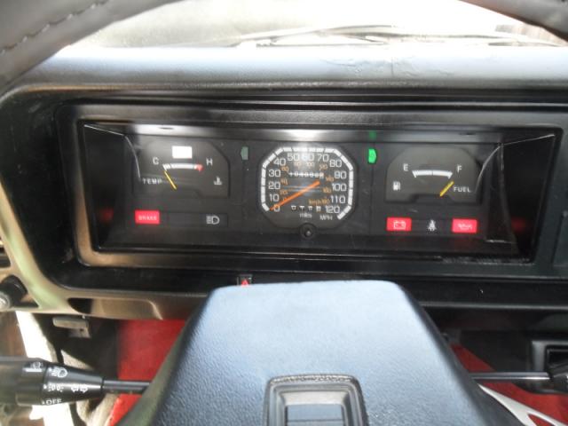

I put them both in and it started no hesitation 4 times. I put all it back together. The picture of my instruments is what it does when the key is on and the head lights are on. At least this time the blinkers worked but that right indicator light stays lit and the left one glows dimly when the head lights are on.
