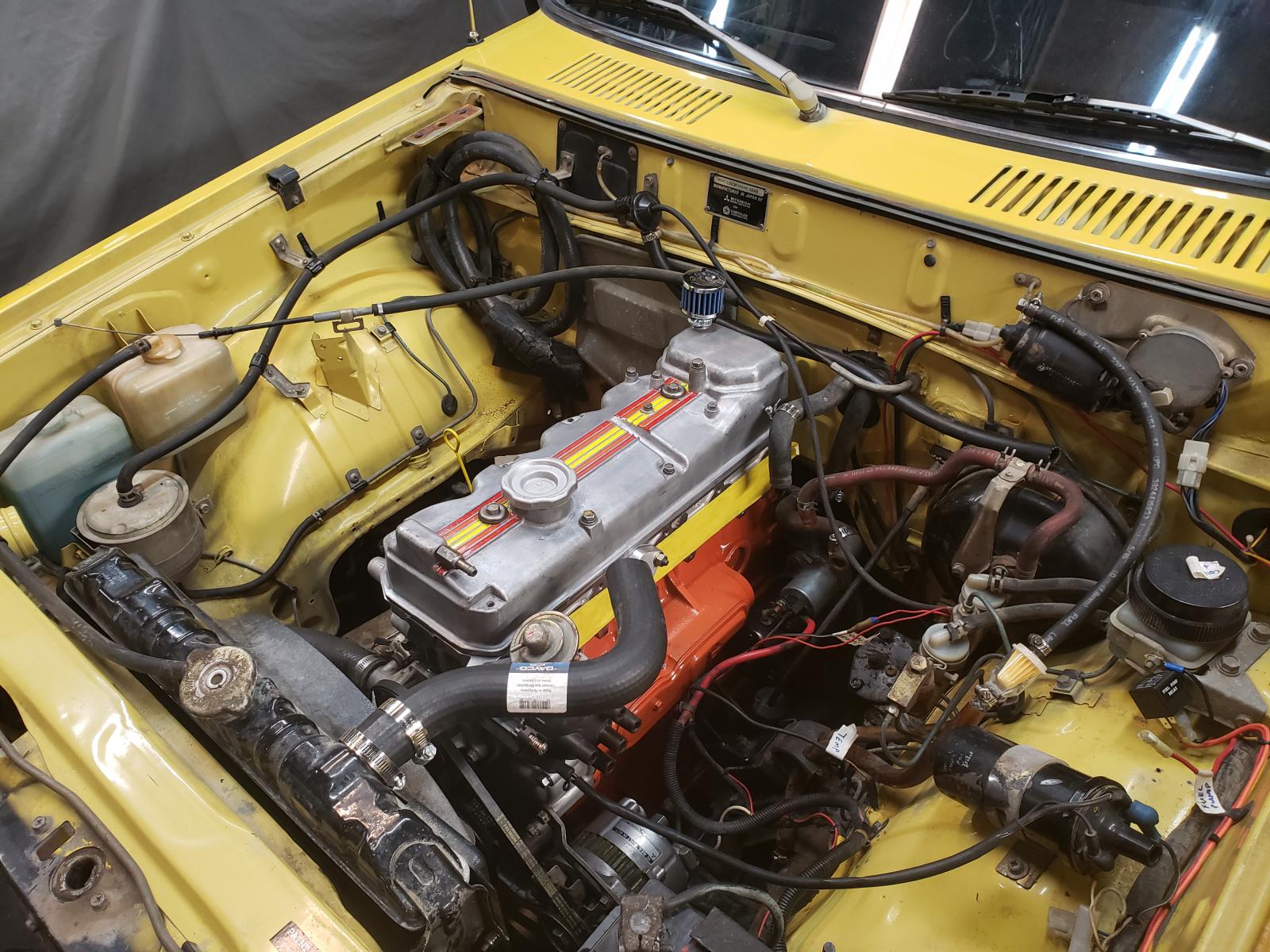

I delivered the rebuild kit and head to my engine builder on Friday evening. I hope to have the completed long block back in the next week or so. In the mean time I installed a relay/with inline fused power supply under the hood for the electric fuel pump. There is a switched power wire that was part of the A/C system that I am going to use for the relay exciter wire as well as the electric choke on the Weber. I mounted the relay on the stud where the stock fuel filter mounted under the hood. That put it where it were it is easy to attach to the battery and that switched power lead. All I have to do now is install the fuel pump down by the fuel tank on the frame.
