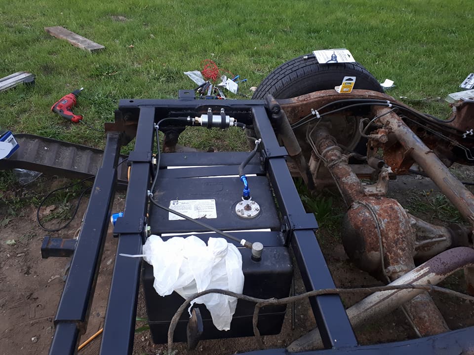

The tank is mounted under the bed at the back. I centered it so that I could run dual pipes if I decided the V8 the truck
Attachment 23518
You fill the truck through a surface mounted boat filler neck with a lock.

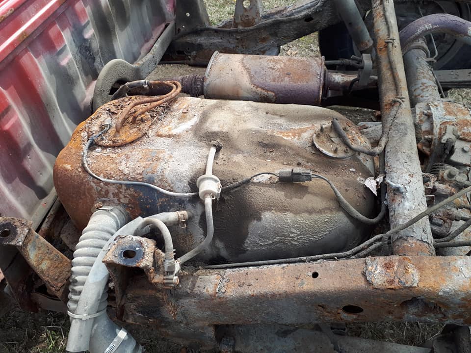

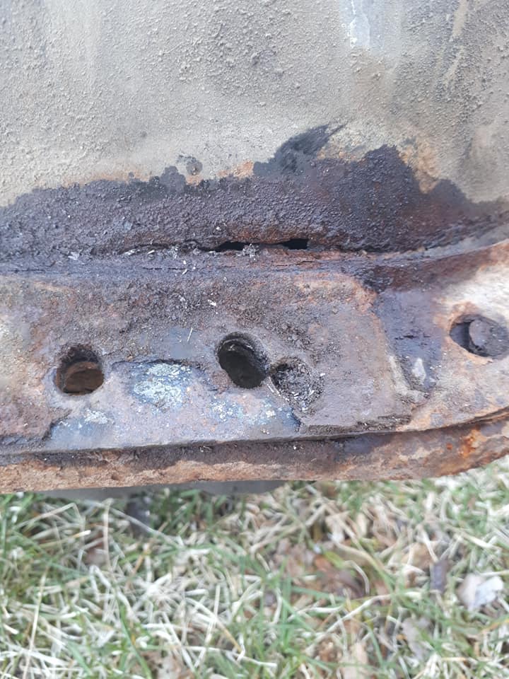

This was the tank I pulled out. They don't make a replacement tank for this truck and there are none in the wrecking yards around here.
So I bought a plastic tank from a boat for $25 and that this what I installed.. I just had to add a boat gas gauge in the truck to read the gas level.
The pump was $200, the metal was about a hundred and about 40 hours of fabbing and fixing MANY holes in the frame rail and I was on the road. So far I have about 20,000 KM on the new tank and repair with no issues :)
That is a really good tank retrofit. It looks like it's a bigger capacity tank too. $25? - that is a freaking bargain! :grin:
