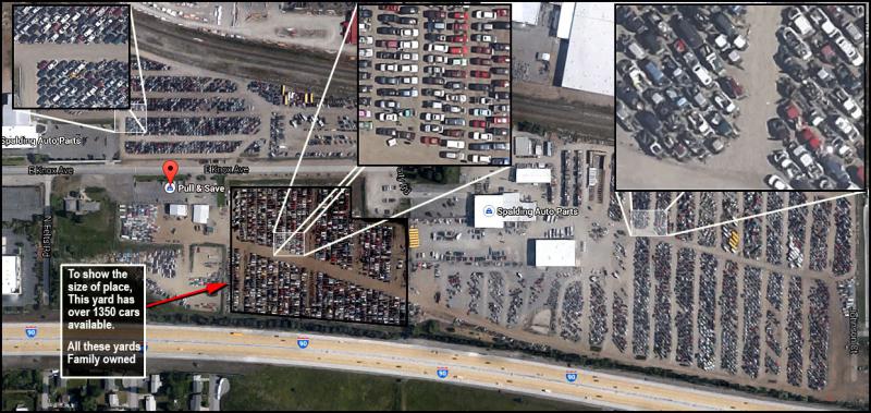

Actually, here is a image of part of our wrecking yard system which is owned by a great family that insist on pricing that are at recycle prices of the material only.

Their sister yard is a couple miles away from us.
