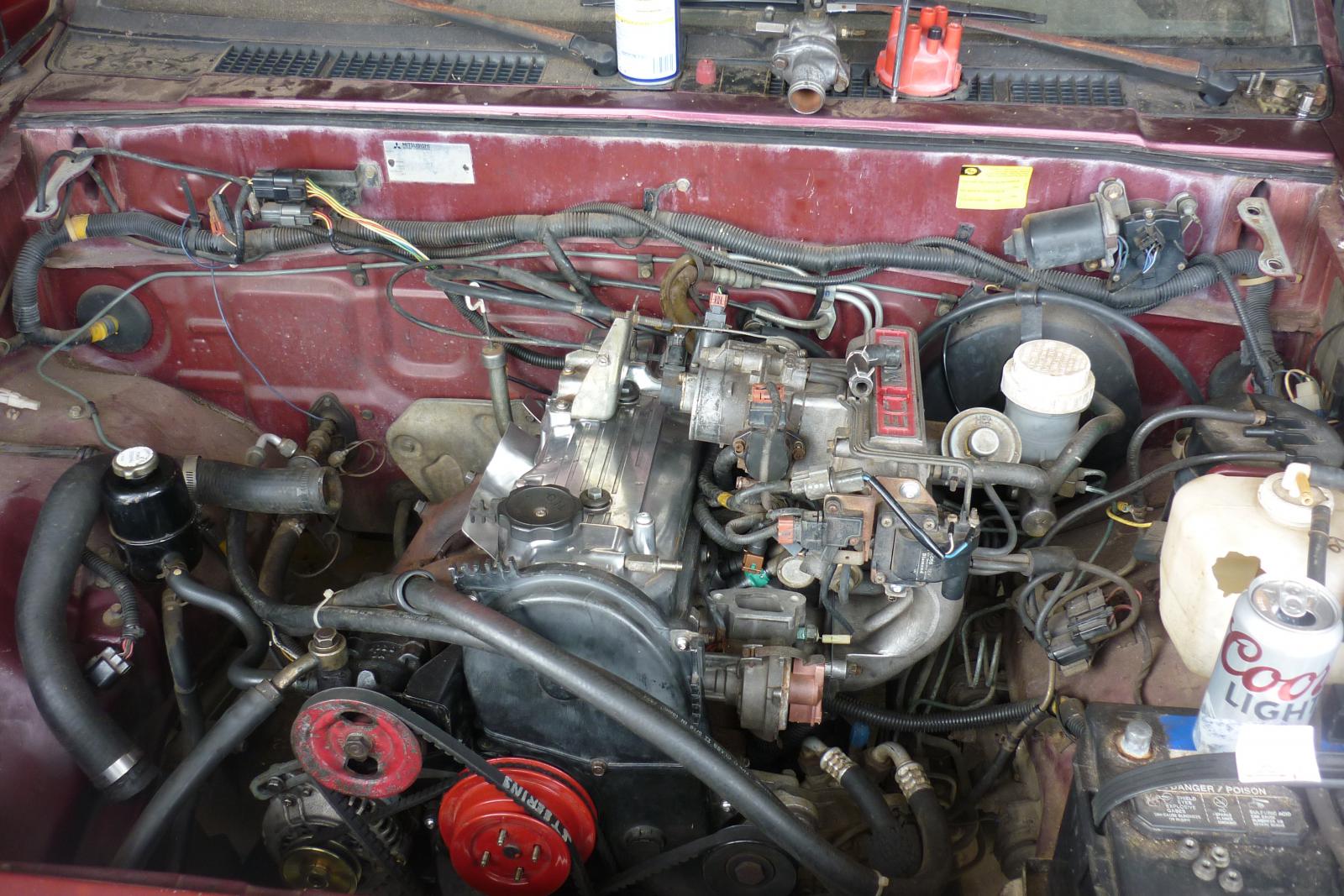

Got a few things left:
Radiator install
Air cleaner assembly installed.
Spark plugs, wires, distributor cap, rotor.
Fluids.....oil, antifreeze
Charge battery, and may need to replace.
Well did need to replace the battery.
After couple hundred bux, it has fired up. After 3 or 4 years up on those ramps.
Runs just ok. Have oil coming out of the valve cover, just above no. 2 plug.
Guess either the cover or head has a dip in the surface. Need to get that fixed.
It over heats very quickly. Has new thermostat, but must not be opening. I'll go get another one and see what happens.

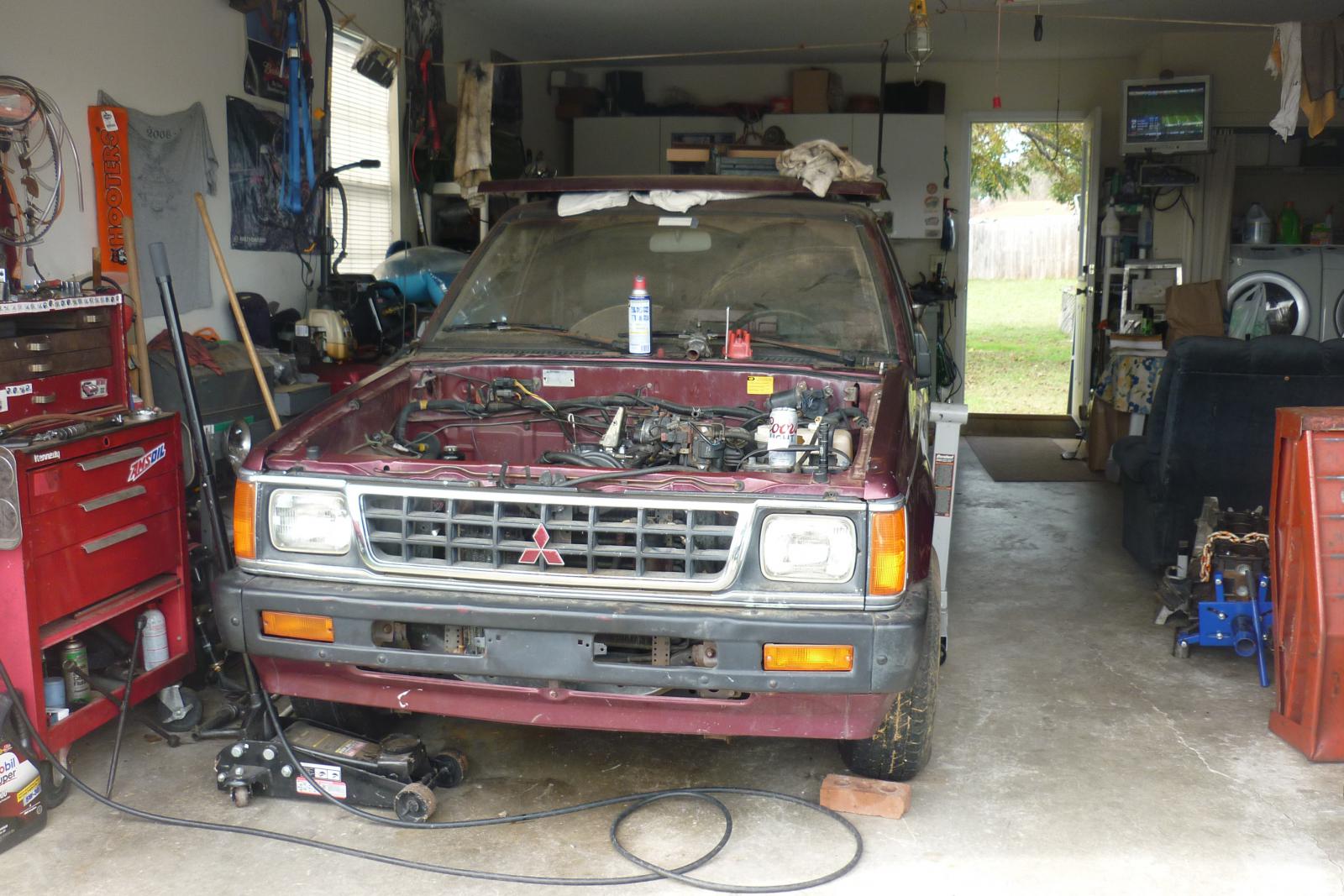

Cleans up real good after sitting on ramps for 3 or 4 years.
Got some room in the garage.
My wife is estatic..................

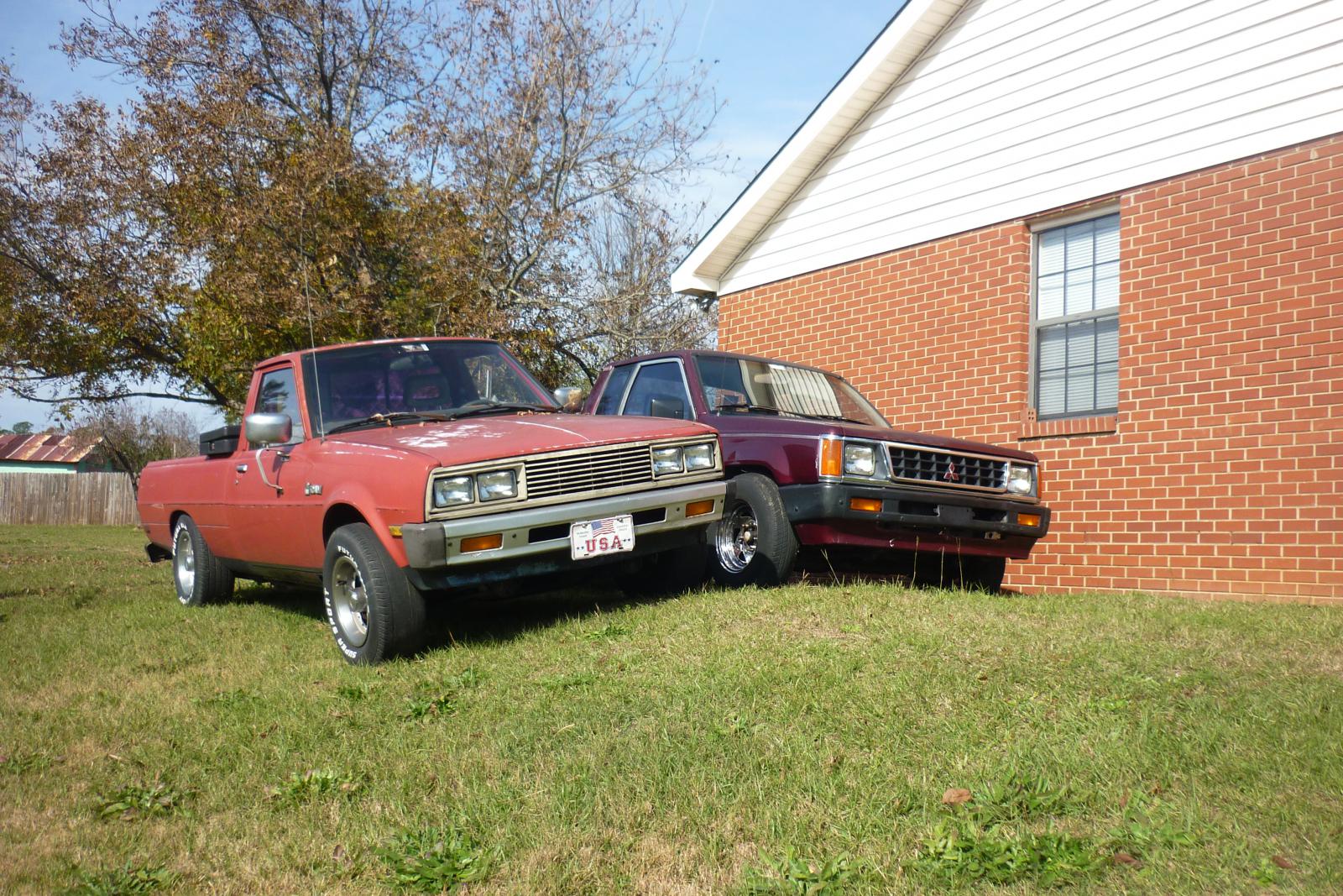

Attachment 15275Attachment 15274Well, got this wired in.....fits real nicely............
And the two together.....

Just an FYI, but the chrome grill and front corner light surrounds are from a '93 or later truck. Those parts should be black like the rear corner light surrounds are.
I don't know if the previous owner just wanted to add some bling or if those parts needed to be replaced for some reason? The front bumper is correct, but it looks really nice, they usually have some bumps and dents, so it might also be a replacement?
ed; its is a really nice truck!
