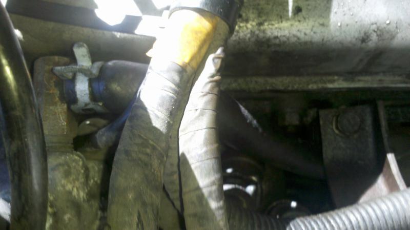

So after digging this up from the archives, I decided to try it. I wanted to keep function as close to OE as possible, and gratefully there was enough hose to just bypass the throttle body with no other mod needed. I only had to disconnect the intake manifold support and run the hose under it. Then I topped off the coolant and took a test drive. Haven't adjusted timing or anything, but so far so good - started, ran, and Temp Needle was on point. That's a good start, and we'll go from there.

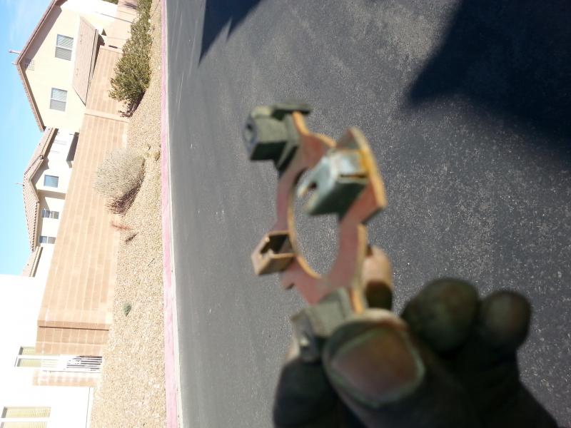

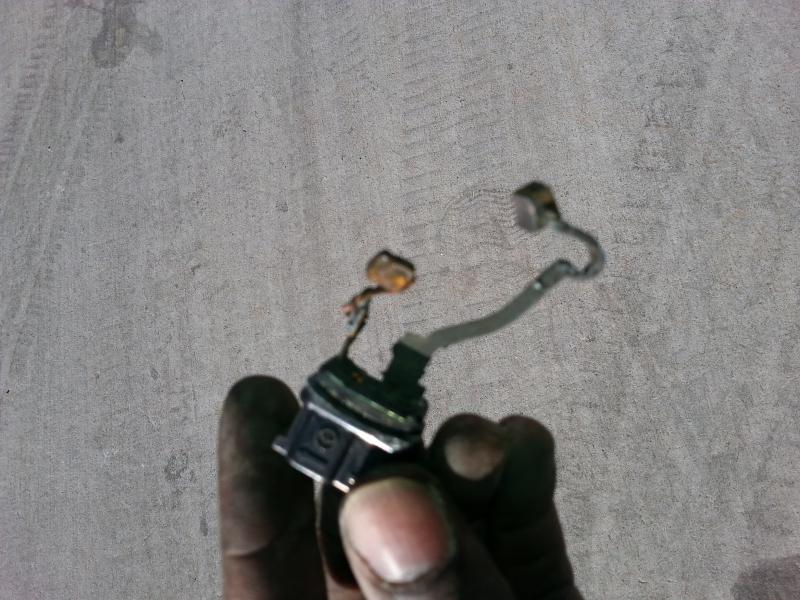

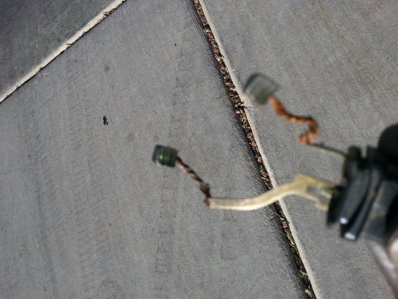

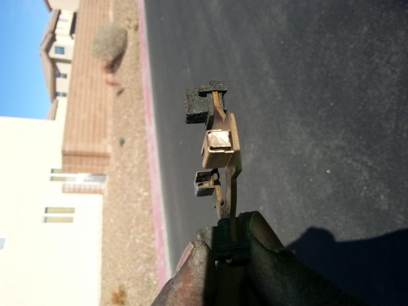

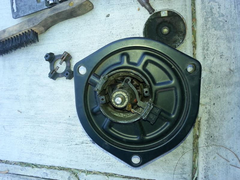

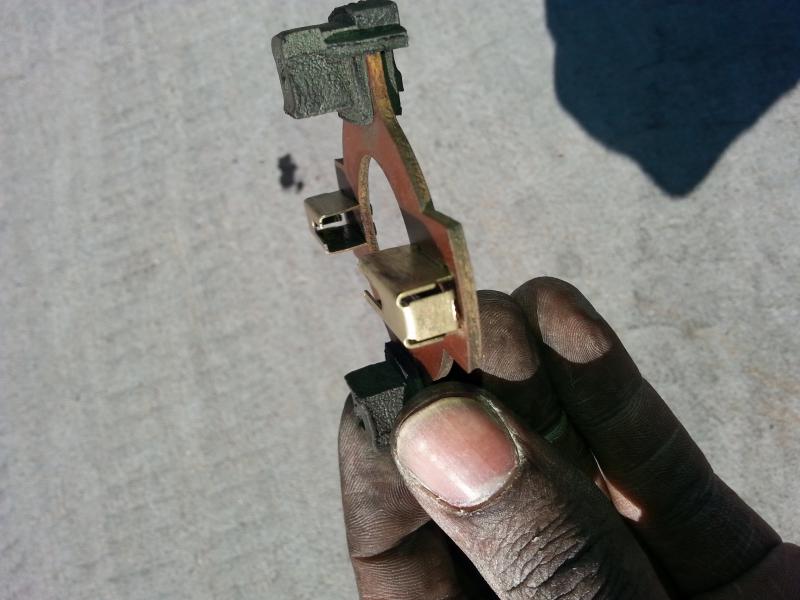

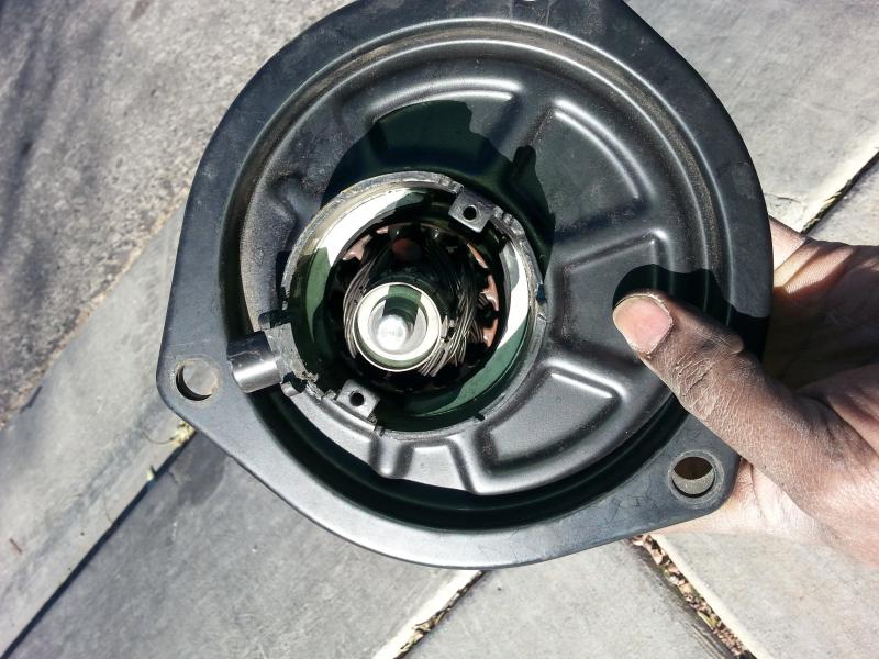

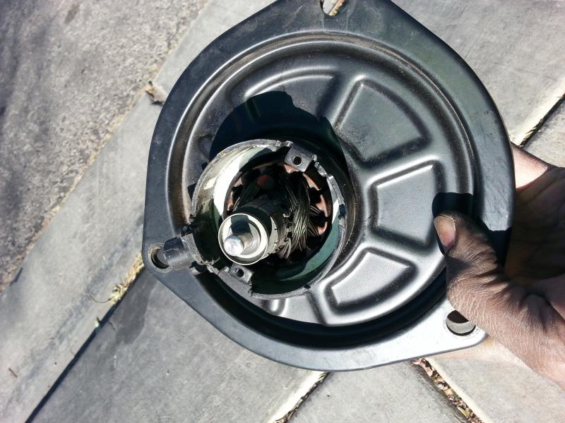

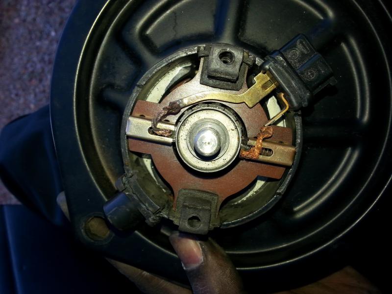

So my blower motor quit on me, and I decided to take it out and see if I could fix it rather than pony up the cash for a new one.

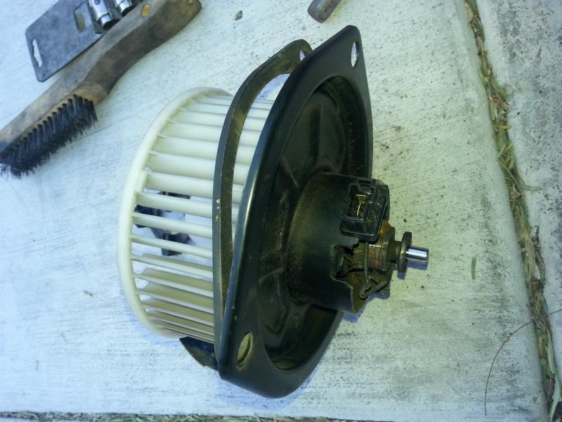

1st I checked voltage at the plug w my multimeter and had 12v solid in each position of the switch. So w switch good, I pulled the motor itself. I pause here to say that the third screw (phillips inside w 8mm outer head) is very (not) conveniently placed at the back of the assembly just above the hump of the wheel well. I had to take my time with a combi wrench and eventually got it out.
I jumped 12v direct to the motor - no dice. With the wires connected (but careful to keep them from touching and shorting) I tapped the side of the motor (like a starter) and presto. So motor's not dead, just tired...

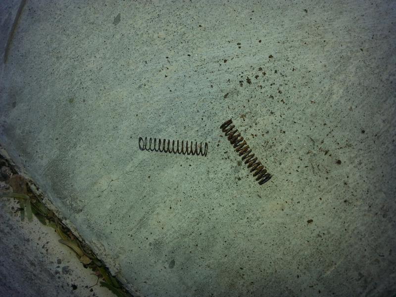

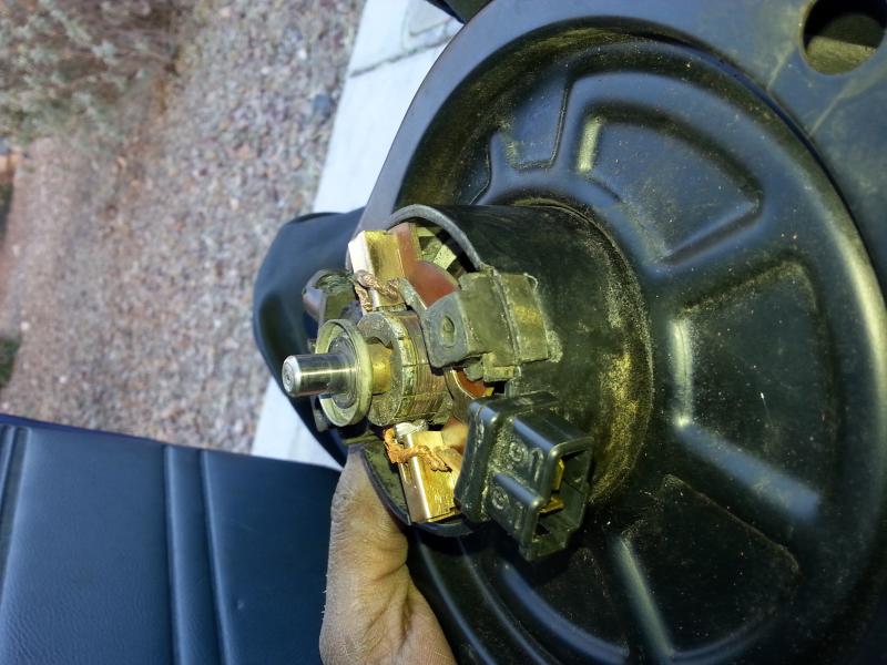

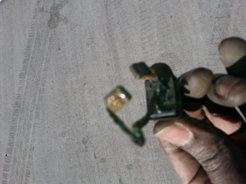

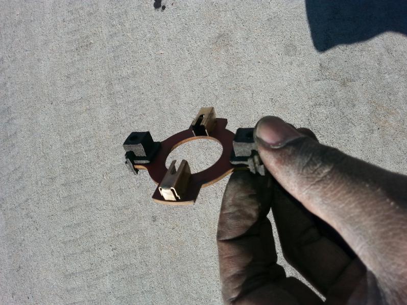

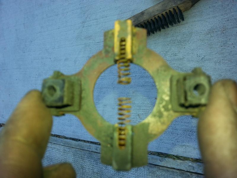

Pics are briefly what I found inside the housing (just three phillips heads screws to open it). Years and miles of normal wear and tear - dust, gunk and corrosion. Scotch Brite, Wire Brush and carb clean later (and long story short), reassembled and reinstalled the working motor and I'm good to go. *Note* the slits in the gold thing holding the springs will allow space for the wires so you can compress the springs with the contact points for reassembly.
Good to go ***(except for this)*** Somehow, when everything was back together, position 2 of my fan switch no longer works... :confused1:
But I don't care. Cost me nothing but time for this fix, soooo I'll take it for now.
For all you guys with a bad blower but no $$, maybe this will get you by (and keep you warm or cool) until you can get a new one.
Laterz.
Crazy enough, the second position of the fan motor started working again on its own...:scratchheadyellow: Not sure when or why but, I'll take it.

Nice job resurrecting your blower fan Finnie. I have saved vacuum cleaners and power tools with an armature in it by tearing it down and pulling the armature out of the centre of the motor, then using fine wet and dry sand paper to reface the copper conductors so they are smooth (worse case scenario I'll take a needle file to it first if there are significant grooves/high spots on it). Next I give the copper a good polish up and lastly remove all the debris from between the copper conductors as this stuff is partially conductive and will create bridges (not much point doing it beforehand as you're going to foul it during the refacing process). I gently stretch the retaining springs holding the brushes in place so they aren't as loose and tired when they're re-installed. Taa-daah, fresh electric motor!

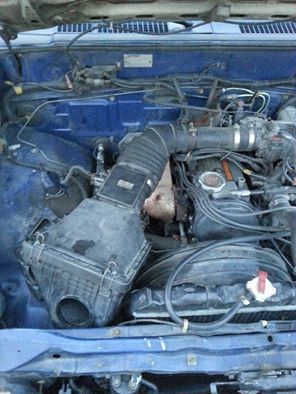

Beginning of a custom airbox project. The difference in performance is not extreme yet, but very noticeable. Everything just happens more smoothly with the engine. Box is a transplant from a V6 Montero. Clips right to the top w the OE Mighty Max MAF. Box is deeper so more volume, and the box inlet is pointed at the grill air inlet pretty nicely. And w the OE pipe, the charge still gets to straighten out before the throttle body. More to come...
