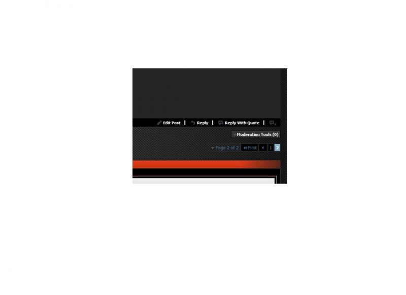

dang I didn't realize I couldn't edit stuff.. I was planning to add prices and items to the list :( why don't you guys allow editing our own posts?
Im not sure but it should be allowed, never been on a board that doesnt allow editing of posts.
heck yeah.. got my new control arms in.. came with new balljoints bushings control arm shafts and hardware... I still don't see what's supposedly so special about them but once confirmed that they fit and lift the truck at least the stated 1" I'll post some pics of before/after and a side by side pic of the arms for all future members who want some updated info. bouncing around on the archives had the info but no real pics or info from people who had done it to their personal truck (not that it seemed like anyways)
I'm pretty sure that donators are supposed to be able to edit their posts, in fact I think we used to be able to. Maybe it's something we lost in the last upgrade?
in fact it allowed me to edit this, but not my previous posts on this thread...
I THINK that you can only edit your last post and only for a short period of time. I dunno. I know most forums (I've been on TONS) let you do it.. this is only the second forum I've been on that doesn't allow it. I always thought having to multipost killed the storage/bandwith used by the site ?? Idk

You should be able to edit. Look to the lower right of the post.
Attachment 2926
Thats strange. Try looking at one of your other posts in the forum some where. I'll look into it. It might be a setting for the new b section. You should make a build thread. Also try to make one in the test area and see if it shows up. It looks correct on the back side.
The only place a donator can't edit is in the for sale area.
