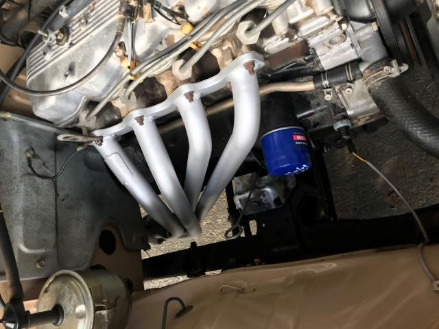

3 Attachment(s)
http://www.mightyram50.net/vbulletin...id=26350&stc=1
Off ceramic coat header, to a 2.5" custom bent "S" pipe, then toward the 2.5" cat

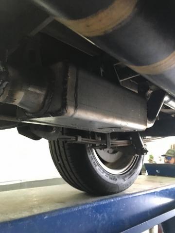

http://www.mightyram50.net/vbulletin...id=26349&stc=1
Off of the header, 2.5" pipe to a high flow 2.5" Cali certified cat, then reduced to 2.25" and pipe to Spintech muff.

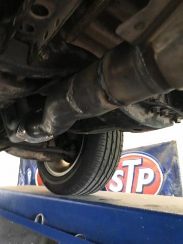

http://www.mightyram50.net/vbulletin...id=26351&stc=1
2.25" Spintech muff. Unusual design, looks like it was hand built - not machine made.
Exits into a 2.25" tail[pipe that ends just under the right rear valence panel.
No rice here. Sounds excellent.

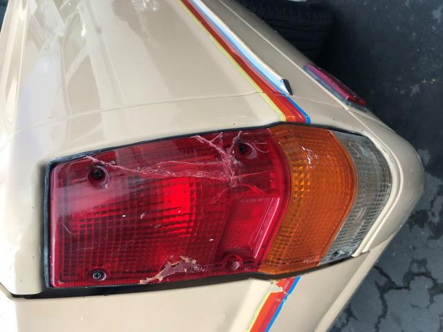

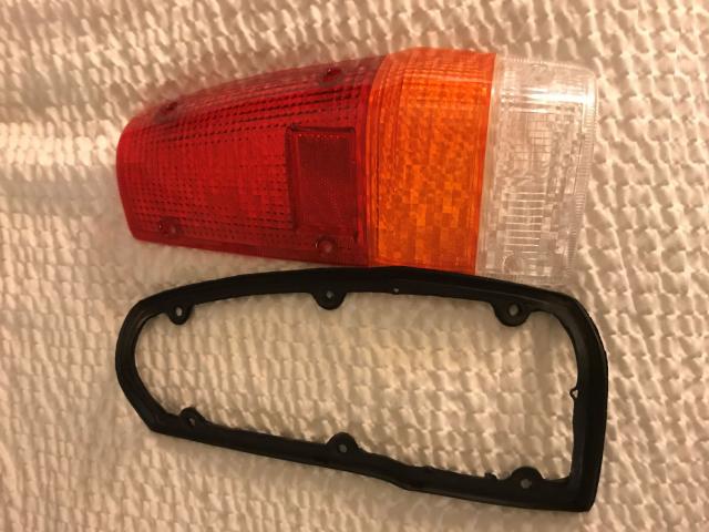

Here's some tail light pix:
http://www.mightyram50.net/vbulletin...id=26501&stc=1
Old...
http://www.mightyram50.net/vbulletin...id=26502&stc=1
New...

The repro tail light lens fitment is 'iffy' but they are pretty cheap and are better than a busted up tail light. It may take a little messing around to get the chamber divider inside of the lens case to fit. Other than that - good news on your well your truck is running now! And your TVR is a nice looking car. Rare too...

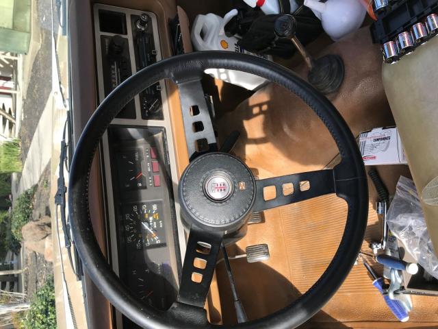

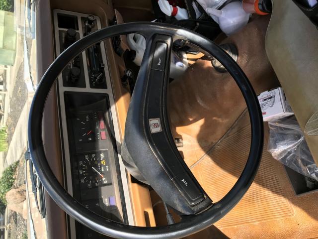

2 Attachment(s)
Nice work on keeping the truck legit with Mitsubishi parts. The 3 spoke sports wheel is as good as any aftermarket wheel. Just need to find an instrument cluster with a factory tach :thumbup:
Thanks for the tag Geezer

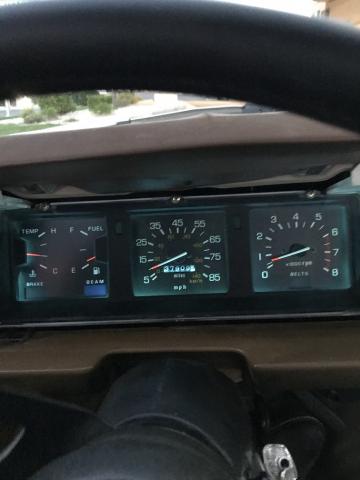

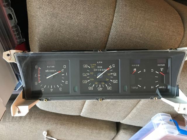

I did find a factory tach gauge cluster. Paid heavily for it too, but it is the correct year and style for this truck. The later trucks (1983+) had different style gauges. They had white striping around the outer border of each gauge. I have one of those clusters also.
I installed LEDs for the back lighting and had to run a wire from the coil to pin #7 on the plug to the instrument wiring. The tach trigger wire is white, I was looking for the wire in the harness, but DSM did not run one. Dicks. I spent a bit of time with a multi meter looking for the wire hoping that it came from the factory. It didn't.
I have installed the cluster and also installed the original speedo into the tach cluster. Everything works correctly.
I have pix and will post them shortly.
1 Attachment(s)
http://www.mightyram50.net/vbulletin...id=26519&stc=1
Damn picture won't post correctly. Oh well, you see what I have.
This cluster is spotless. It had 47K miles on the odometer and I tend to believe it's accurate.

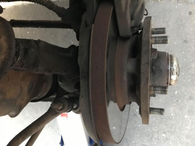

1 Attachment(s)
http://www.mightyram50.net/vbulletin...id=26520&stc=1
You can't be serious about this rotor...
I must weigh 20 Lbs.
Again, I thought I remembered a thread mentioning that the later Mighty Max disc brake assembly is a direct bolt on to earlier trux.
They are also vented. I guess you pop the upper and lower ball joint and tie rod and the assembly bolts on (?)
I know on my Nissan D21, and my Chevy S10s there are direct bolt ons from other models that have much larger capacity disc assemblies. Same with my Chevy C10s and my '68 Mustang.
Any info will be greatly appreciated.
The Mighty Max steering hub and brake assembly is a complete nut and bolt swap. They use the same upper and lower ball joints and the control arm and steering hub geometry is the same. I actually went out and bought a front set just to 100% confirm this is the case. A lot of guys were trying to change only the rotors and calipers only to find the brake caliper would foul on the end of the steering pivot due to the brake caliper mounting angle is different between the Gen 1 and Gen 2 trucks. The trick is going the extra step and finding a twin piston caliper to upgrade to. I bought a pair off a Mitsubishi Challenger but they have some overhang from the brake rotor...

Here's the tach dash installed with LED back lighting.
